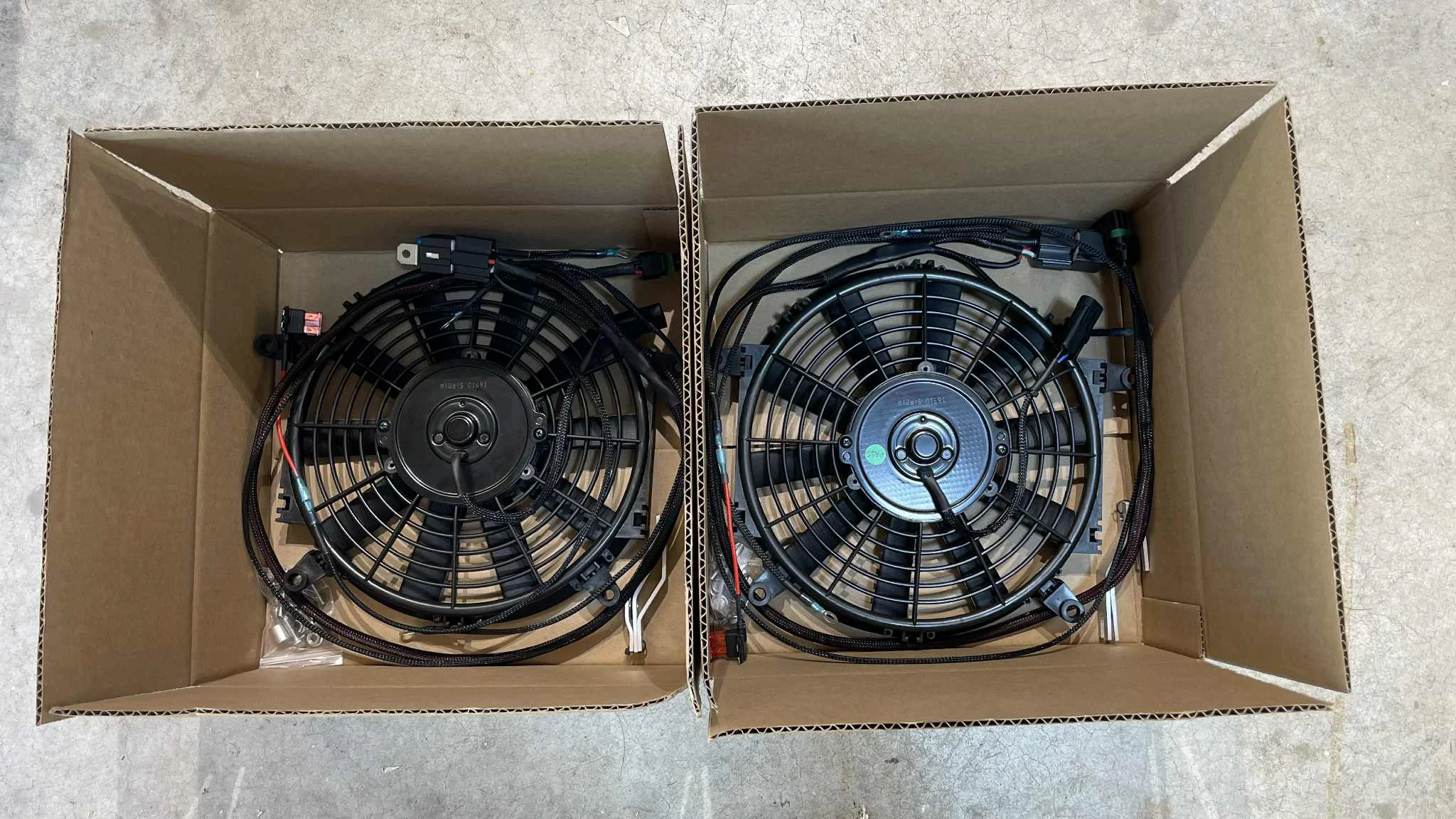

Any interest in an auxiliary AC condenser fan kit? INSTALL DIRECTIONS IN FIRST POST
OK, fellas... I've got two boxed up and ready to go. $215, shipped in the lower 48.
Is the fan manual on/off switch or temp sensor activated?
It's wired on with the ignition, so key on = fan on. There's a temp sensor in the harness that will shut the fan off if it's below 60°F ambient. If you need to shut it off manually, there's a fuse on the relay that can be pulled.
*edit- I'll be posting install directions with pictures tomorrow.

Thanks, Phil! Your supply chain issues is one of the reasons I went with an aftermarket fan. That said, I had a hell of a time finding a place that would reliably ship the correct fan. I think I returned five or six fans throughout the process because they weren't what was pictured, didn't have the correct blade design, or would have required a complete redo of the mounts.
Even thoughts AC is off, the fan will kick in if anbient sensor sees 61°F?
Yes. These were the only sensors available at the time. Future harnesses will have the off temp set at 77°F. Alternately, there's a fuse on the relay that can be pulled if you want/need it off. I decided to not use a switch on the dash because 1) I wanted to keep the install as simple as possible, and 2) I couldn't find one that was labeled "FAN" and that looked OEM.
I considered that, but it's my understanding that it turns on and off, and if triggering the relay, would cause the fan to turn off when the compressor is off and only run when the compressor does. The condenser still has heat to shed even when the compressor isn't running and I wanted the fan to run continuously so that it could help the condenser recover more between thermal loads.

No, it should have nothing to do when/if the compressor is running. Only depends on A/C pressure:
MED pressure circuit - on - continuity = 192psi (Aux Fan on)
MED pressure circuit - off - no continuity = 156psi (Aux Fan off)

I like how that keeps all the wiring in one area without the need to run the relay trigger wire into the cabin. I'm going to look into that more. Thanks!

I've updated the first post with install instructions. If you have any questions about it, post it up or PM me.
I finally got around to installing the aux fan today. It was super easy and it’s working as expected. I’ll report back on effectiveness when I’m stuck in Atlanta traffic next week. I will probably add a switch of some sort but that’s on me. Thanks @Mandrake for the time and effort to put this together.
Ran my aux fan for about 3-4 yrs and it worked great. The main difference in AC performance is when i switched to dual elec. fan with a fan controller, my AC is working 200% better than the when it had the aux fan upgrade.....
