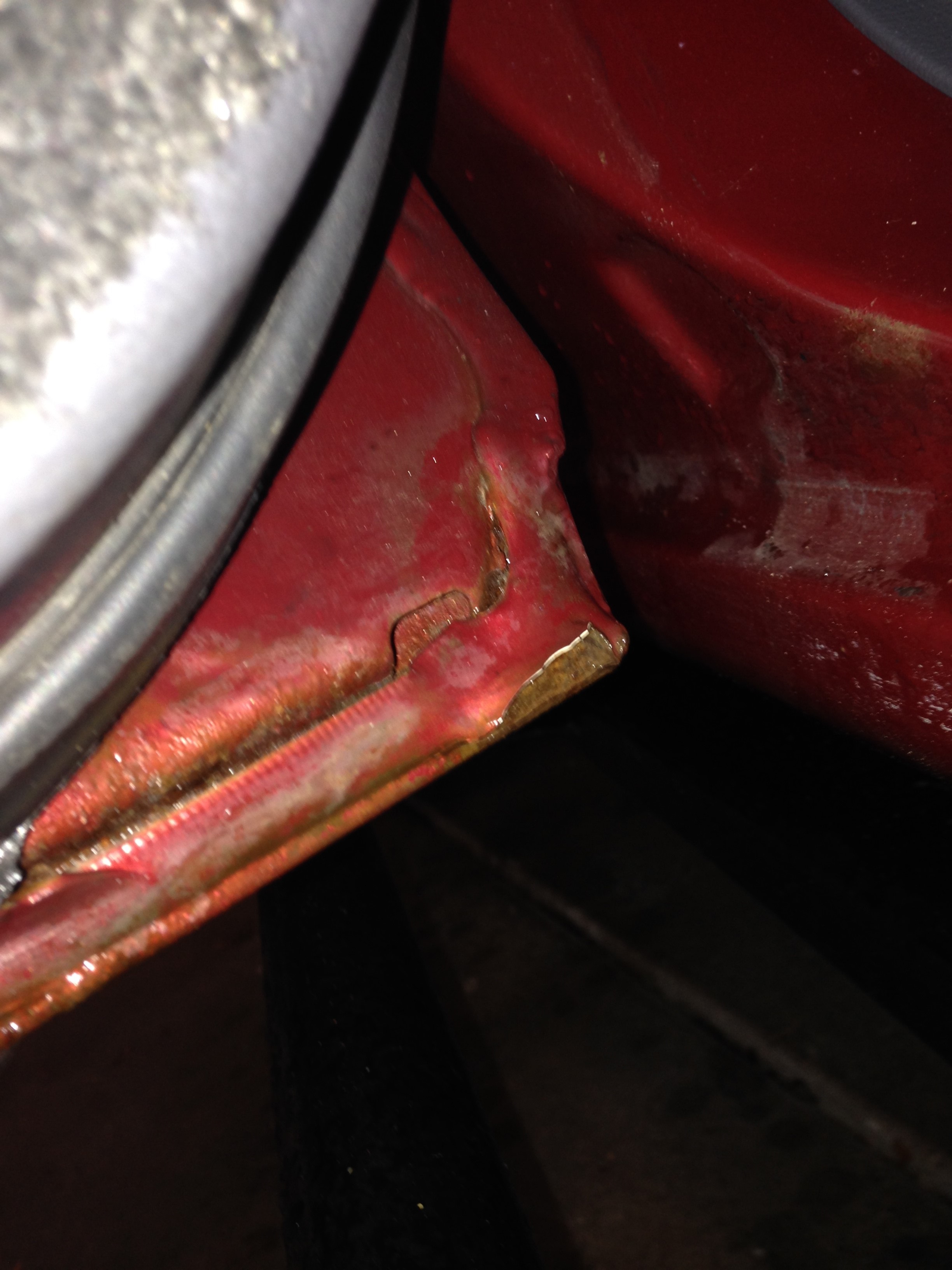

True. I may have found a fairly clean truck that's 3x locked anyway. It has some minor rust on a door seal, and behind the bumper on the PS rear quarter, but otherwise appears to be very well maintained. The nice thing about a truck with OEM lockers is that it's already installed. There is a premium to install aftermarket lockers (and yes, a premium to buy a truck with factory lockers). I think the Harrop lockers are about $1,300 each, plus the cost of the install.
