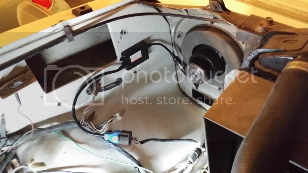

Installed! The transformer comes with double sided sticky tape (or two bolt holes) for mounting.

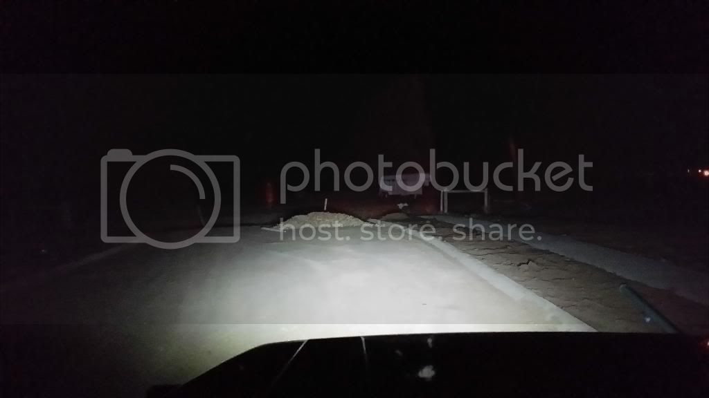

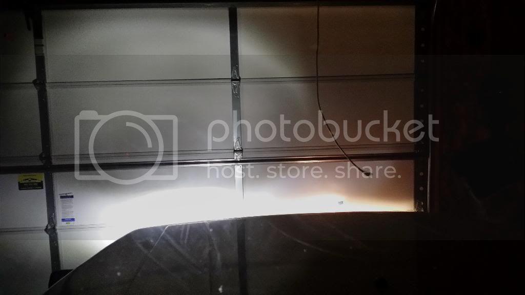

difference between standard halogen (right) and HID (left). HID is MUCH whiter. There is tape where the beams were pointed. The HID completely washed out the tape in the picture.

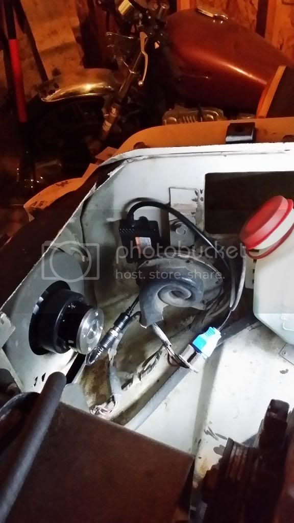

Right side transformer mounting.
Both HID installed

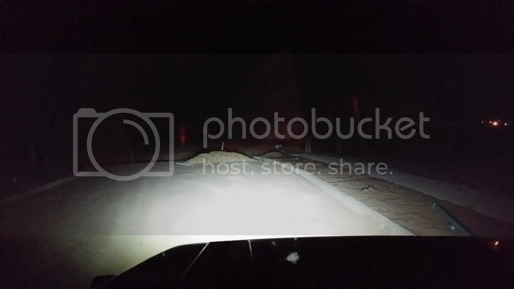

same spot in the road. Ridiculous difference, huh!

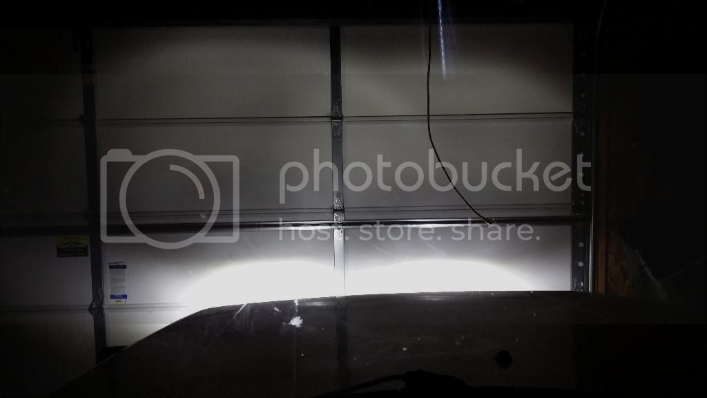

Brights
My personally opinion on these, Awesome! Worth the $240 bucks paid for the upgraded housings and the HID's. My only long term concern is how the HID's will effect the factory wiring. From expeirence i've seen aftermarket HID's melt wiring harnesses that arent upgraded for the extra pull. So we'll see if i have an issue. I plan on upgrading all the wiring eventually anyways so if it does burn up, it'll just be upgrade time!

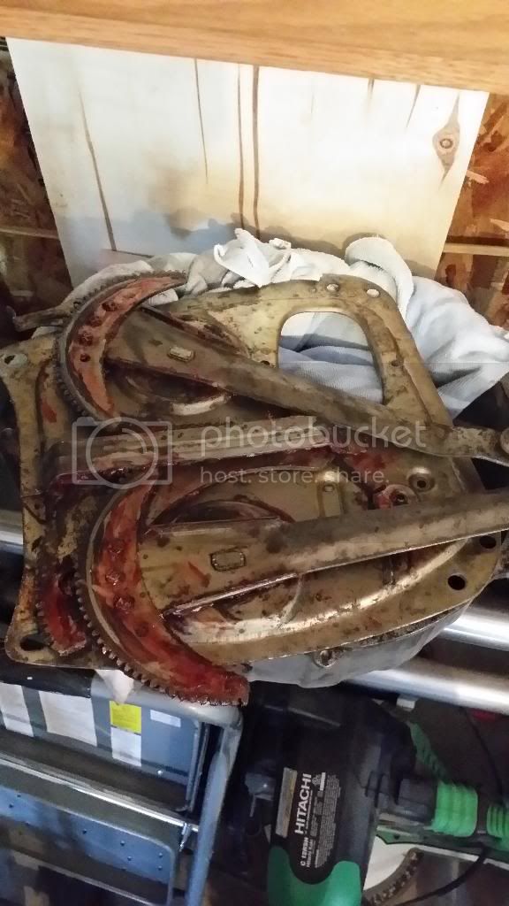

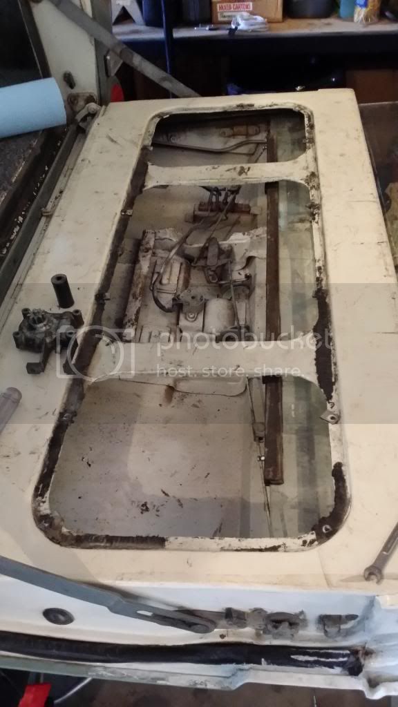

Early this winter (about 6 months ago) I began to have issues with my tailgate window. Got around to finally spending about 3 hours working on it today. Automatically figured the window gear broke stopping the window from going up and down fluidly. Upon getting started I found a few issues.
#1. The three wires that go to the window motor had all been cut and splice back together. Took the electrical tape off the wires to see the damage expecting to possibly see some corrosion or burn wires. Nope. When they spliced it together they just twisted the wires together and then just taped up. No solder what so ever. Fixed that.
#2. Regulator had about 50 year old grease that was like glue between all the moving parts. Cleaned it up and applied some grease I had laying around. (Plain axle grease for now. Will redo it with some better grease when I go back through it in a few years) Also got the plastic gear. The grease in there was like molasses. Disgusting.

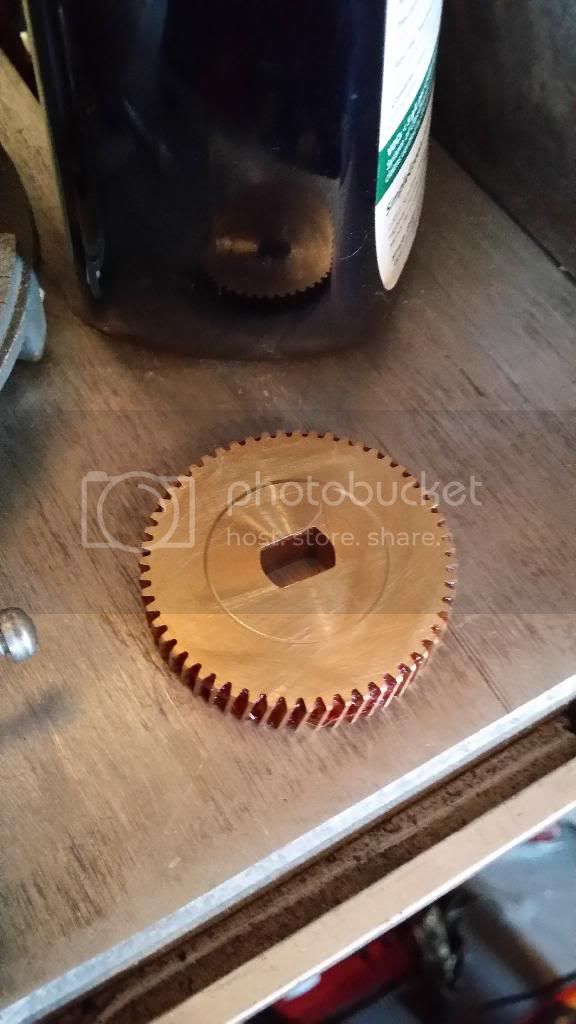

#3. The third thing you guys are possibly thinking is a shattered or cracked gear. Nope. Mine look practically brand new. However figured since I had a midgainc gear I would throw it in anyways. Put everything back together and realized my motor would click but not move. Found out due to the gear not having a recessed area it contacts the top plate. No biggie put the like new plastic one back in for now.
Here you can see where it rubbed
After getting everything sorted and back together it still was seeming sluggish. But now at least works up and down everytime. Also replaced the junction block with the brand new one I just got.

I'm concerned about that gear rubbing. We need to look at that and see if it's going to be problem for all of them and what to do about fixing them. I have one on the shelf, but the one in the motor is from years ago.
Anybody else having this problem?
Luckily the solution is simple. When i get some time i'll run it over to my machine shop. Im sure it'll cost me 20 bucks to have a groove cut in it. Groove looks like it needs to be about a 1/4 wide and 1/8 inch deep roughly.

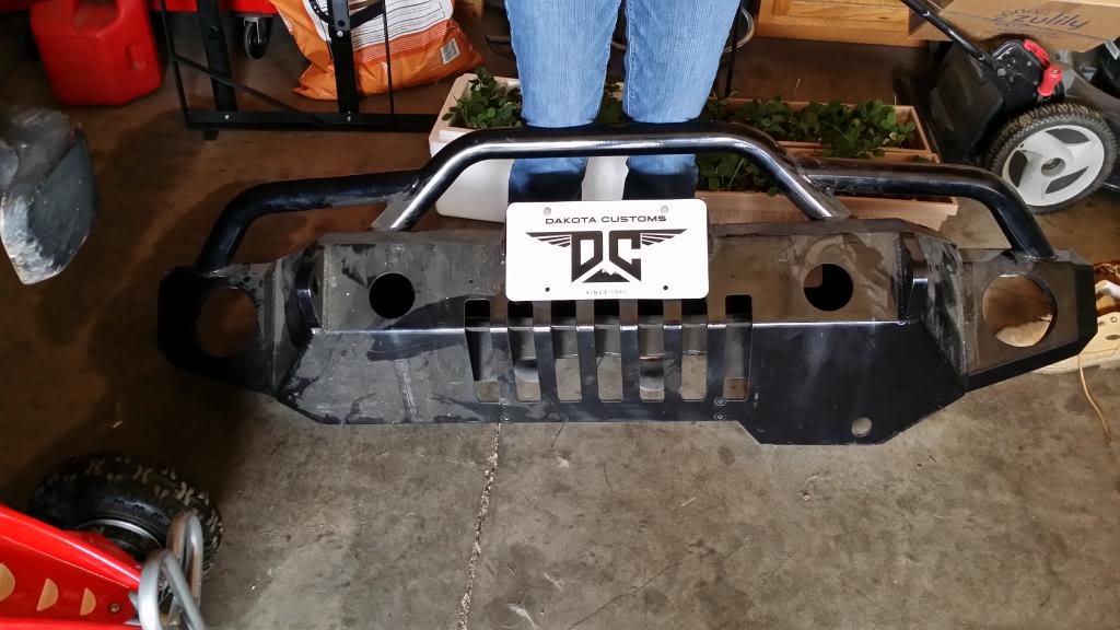

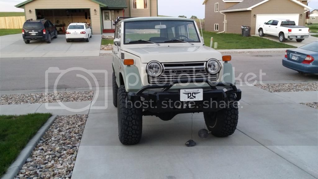

Just picked up a road armor front bumper. Going to modify it to fit the factory mounting position. Hopefully it looks good lol.
Did a little chopping of the new bumper. Able to test fit the look. I like it. But it needs to be shoved back another inch to he where I like it...more cutting. Also need to weld up a bracket that I had to cut the weld off of. Going real nice and smooth so far. No modifications to the pigs frame horn. Just the way I wanted it.
