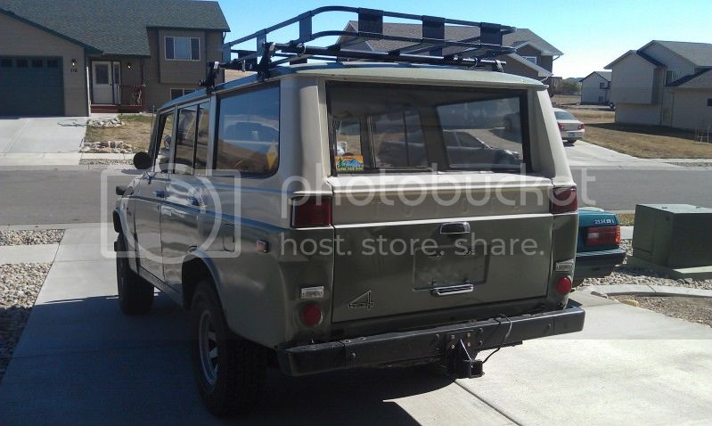

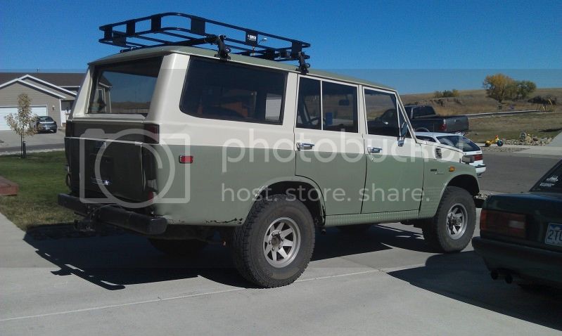

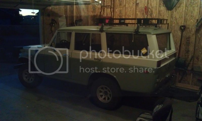

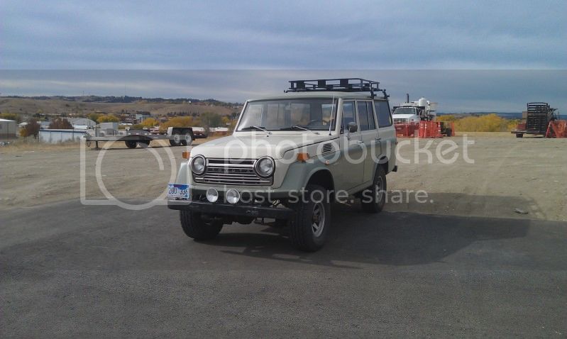

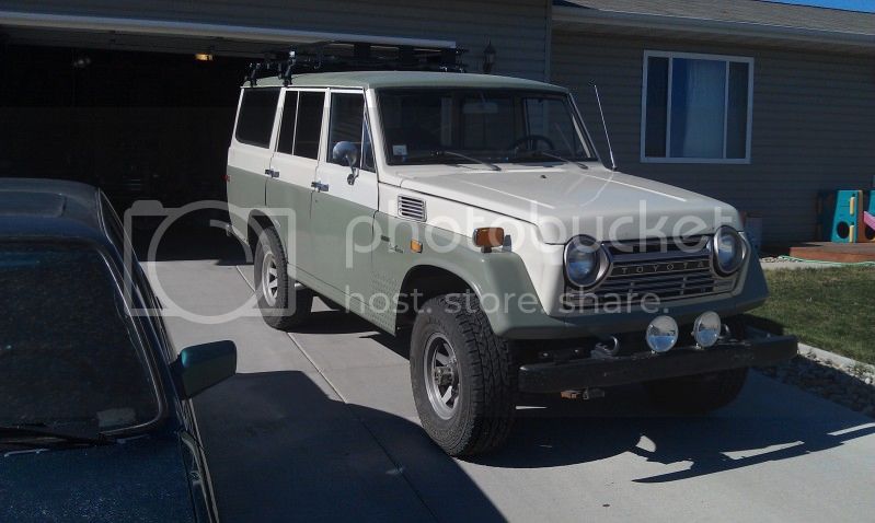

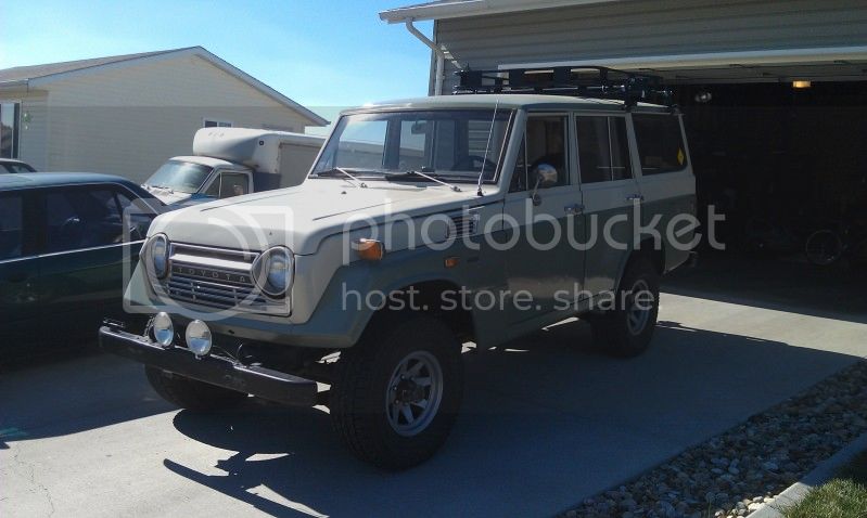

Back to the Fj55. Here she is, (i'll update this with better pictures, i got here home at dusk.)
She needs a bit of work despite her first glance appearances. Everything thats on the bottom outside of the Pig has rust (you know... the common stuff.) This will eventually need bottom fenders, rockers, and rear quarters, along with the bottom of the rear gate, And of course body mounts. I have already been in contact with Bobm to remedy this problem, and hopefully within the next few months i can have a slew of parts heading this way (for starters body mounts, and rear quarters) Im still pretty torn on the rockers. Not sure if i want to just make myself some nice frame sliders and cut out the rockers and install them, or do a rocker replacement. Anyways, noticed this is getting long, i'll shorten this up and just make a quick list of things i plan on getting done on this.

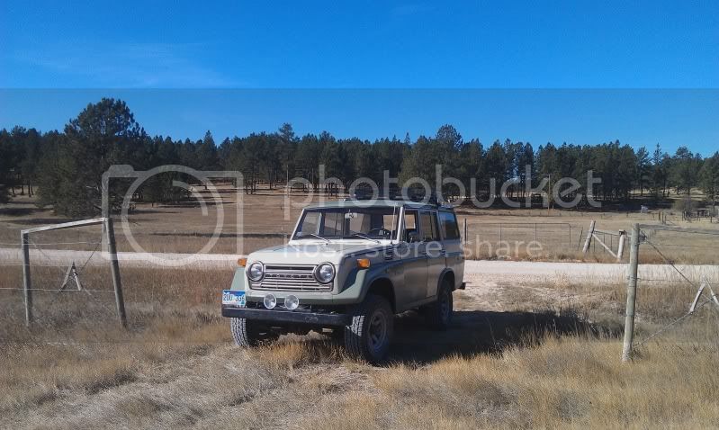

A non-update update:
Havent got started on fixing anything major yet on the Pig, just enjoying it. Taken a few small trips with it (50+ mile round trip drives) Figured i would update this with atleast something lol.

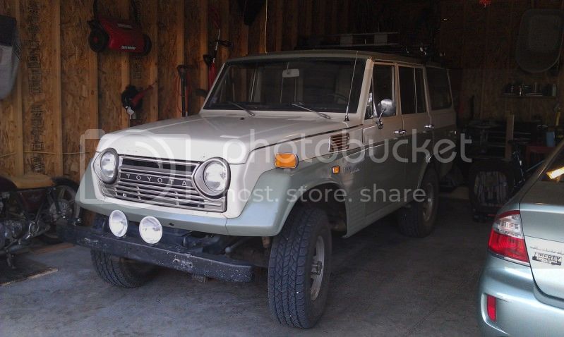

First one is just daily driving to work...People at work instantly knew it was mine as im the only one that picks the "oddball" vehicles to drive. (I work at Jeep. lol so i get hassled alot!)
This was a drive to Custer, SD, about a 35 mile drive one way from my house through the hills.
And this series of pictures was from today, went to Sylvan lake, SD. Which is close to custer, so about the same amount of drive, just more through winding roads of the hills. Love this rig!

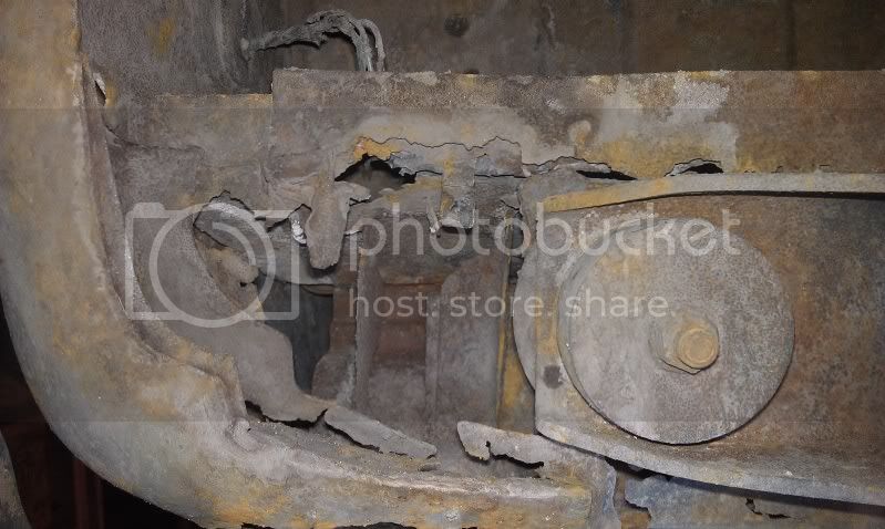

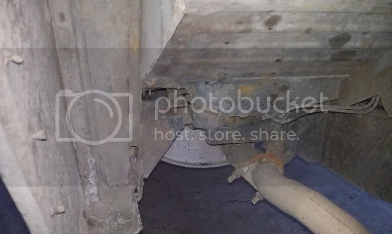

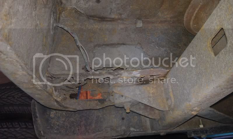

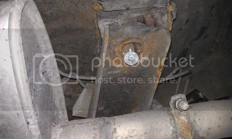

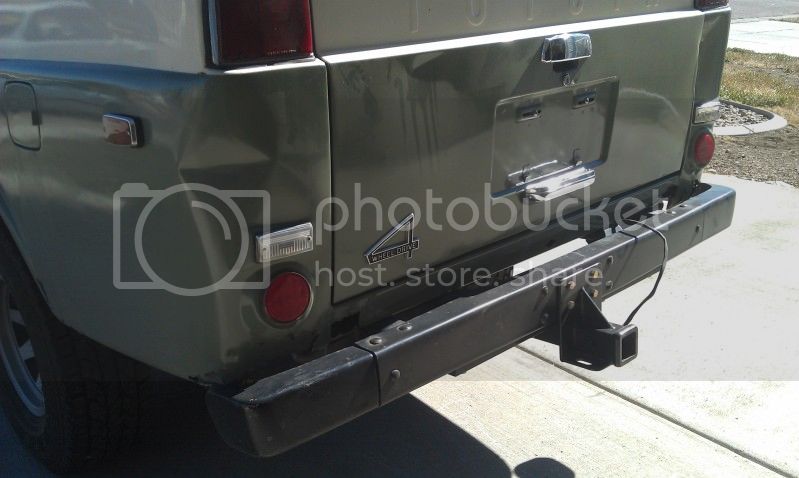

Drove the Pig to work a few days ago and upon walking away and looking back (yea i like it enough to always look back lol) and realized the body "lean" is getting worse. So its time to tackle that really soon. Took some pictures of what im going to have to deal with.
passenger side front body mount (where the lean is coming from) as you can see its blocked up by a chunk of 2x4.
This is my rear body mount. Havent fully decided a solution for this yet as i dont think there is a "patch" for them. I think i remember seeing someone on here totally rebuilding the corner and boxing it in, not sure who it was though.
So whats the best method of taking care of the welds that hold the front body mounts? Just a spot weld cutter, or just grinding? Priced out the front pieces from BomM a few months ago, and will probably be pulling the trigger on the 1st for the body mount pieces. Think as far as my rockers (which are shot) im just going to do some 4x4 square tubing and make a rail (believe thats the size the most of you use?)

Here's a link to an excellant write up on the corners. You've got some serious work ahead, but alot of the guys have been down that road, so it is doable. Do alot of reading and searching the forums.
Good Luck, Ron
