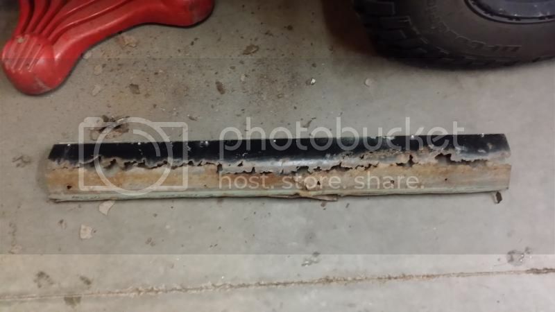

All ready to start cutting. Picked up a stick of 1 inch square stock to tie everything in. And got everything apart. Snapped about 50% of the bolts going to front fender. Wasn't expecting there to be so many bolts on the fenders.
Got started today with the prep and spot weld cutting. Love learning along the way. Hopefully the other side will be much easier lol.
As you can see I also welded up a ABC pillar brace to keep everything in place. Cutting the rocker out tomorrow hopefully. Have the B pillar somewhat loose from the rocker so I should hopefully be good there.
Cut cut cut...ran out of cutting wheels lol

My biggest issue about doing this piece is where do you cut? I just looked at the two pieces a I had at this is what I came up with. I know I'll hate cleaning it all up after welding. But I'm thinking it was my only real choice.
This is what I ended up with. Hoping it'll turn out nice when I'm all done.
So much rot underneath. This ended up being a lot more than I expected lol.
