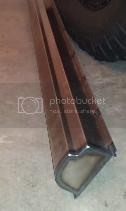

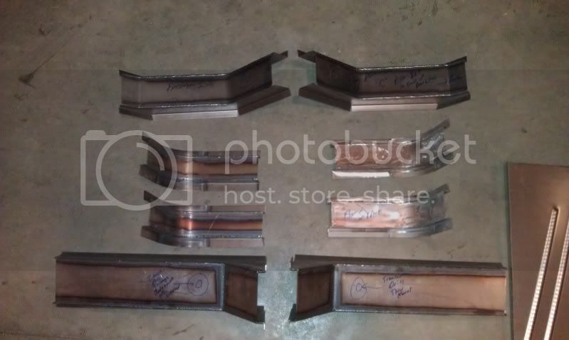

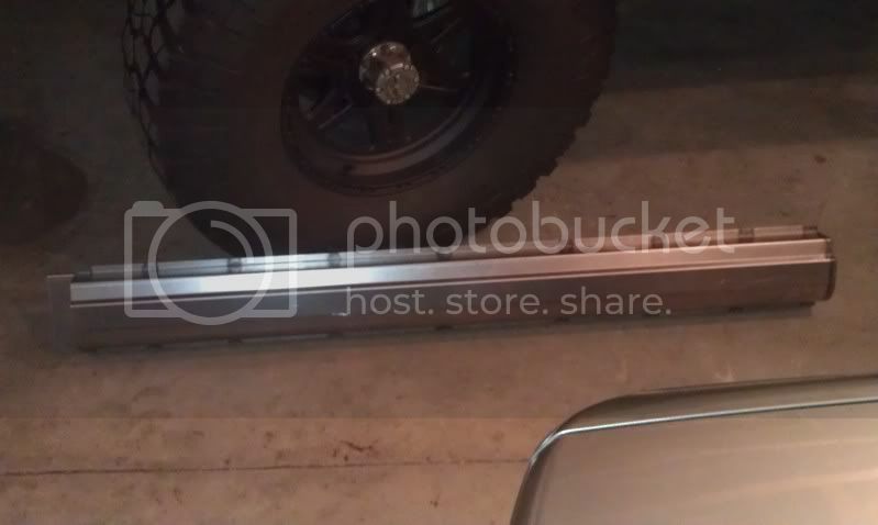

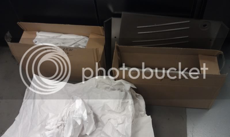

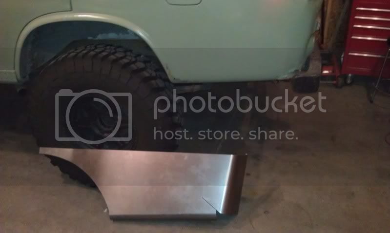

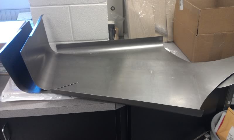

I got to anxious and didnt take a picture of the 2ftx3ftx3ft box that most of this stuff came in (plus it being about 50-60 lbs it seems) The box the rockers came in was about 6ft tall and weighed 63lbs....jesus!
First opening of the small boxes

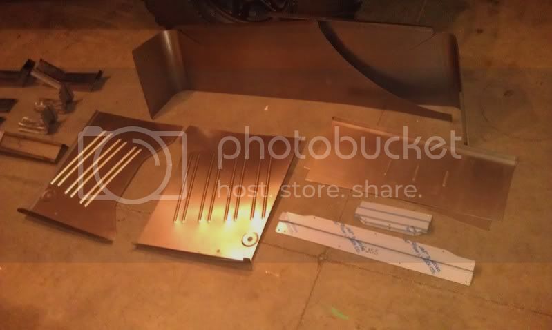

quarters out of the box
"and you'll be going here."

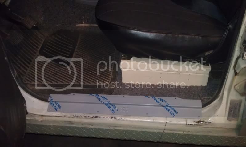

LOVE the stainless sill plates (got front and back)
Everything all together.
The thing i was most surprised by was the weight of these rockers. Was originally thinking of doing some 4x4 tubing and making rock rails. Hell these will be almost as strong and look 100% factory. Super awesome!
Well, sheet metal for weeks....literally, because once i get started its going to take me WEEKS to get all this stuff in. Cant wait!
Would like to give a HUGE thanks to Bobm for doing this stuff for the community and for a very fair price.
I'll be doing more pictures in the process, so stay tuned! (gonna be a little bit though)

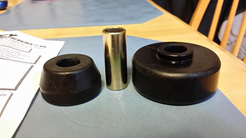

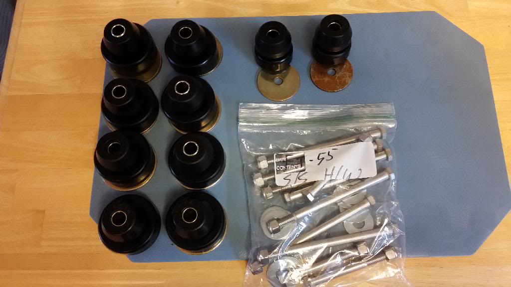

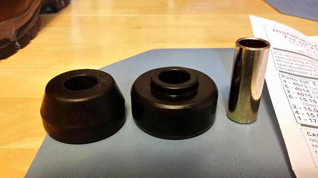

Then today my 4crawler body mounts came in! Not going to lie, was super excited and super bummed at the same time (pictures to follow) The whole time i was thinking they were custom made pieces by them. But truth is they are actually produced by energy suspensions (which is good quality stuff) which makes me happy. Thing that makes me frustrated is the amount i paid for something that (with some knowledge) could have been much cheaper. Live an ya learn
So my body mount deal. If this is wrong of me to post, ill take it down. Otherwise enjoy the free information.
Horray new body mounts and stainless hardware!

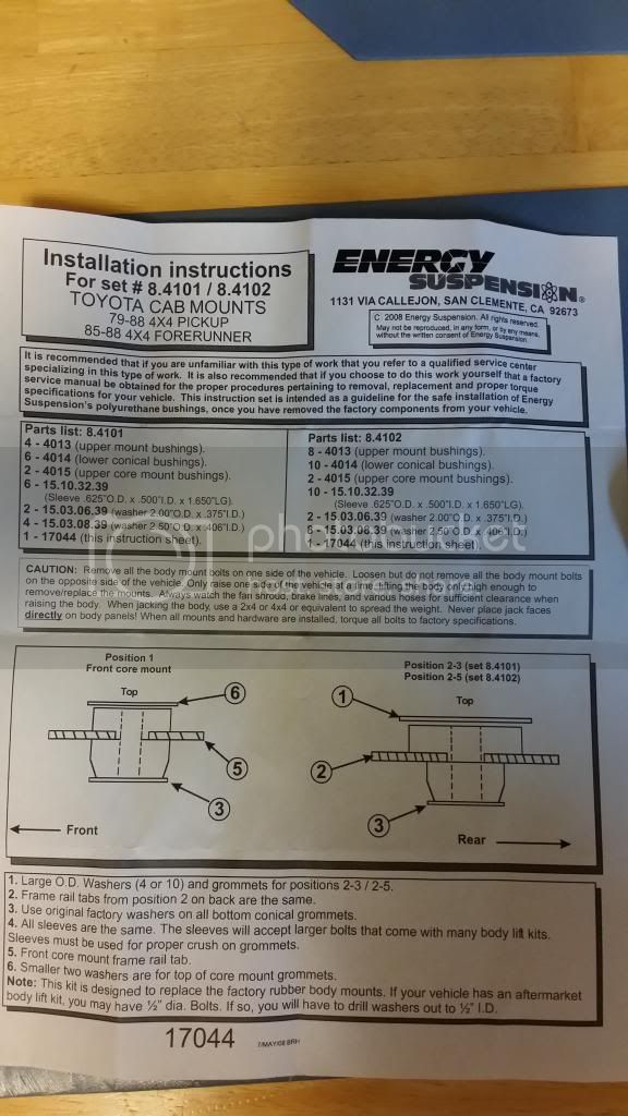

Whats this? Instruction manual for energy suspension bushings? Interesting!
Bushings how they look assembled. There is 8 of the big bushing and 2 of the small.
Big bushing disassembled
Little bushing disassembled
If you do your own research you can find this bushing set i received for A LOT less, which is frustrating.
All for which can be had with some quick searching for a 1/3 of the price. Ouch.
http://www.carid.com/1984-toyota-4r...s/energy-suspension-body-mounts-11093356.html
Enjoy!
Strange, he must have switched suppliers. Mine are different than those. I'm sure they will work, but I had to massage them a little. On my 71 the mount hole were different, so had to trim to fit.
Edit: If I remember right, Roger used Daystar body mounts.

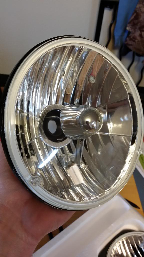

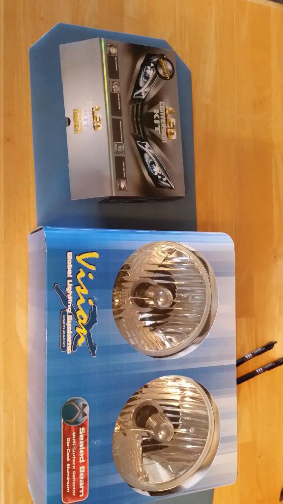

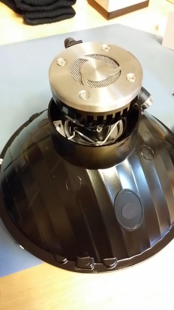

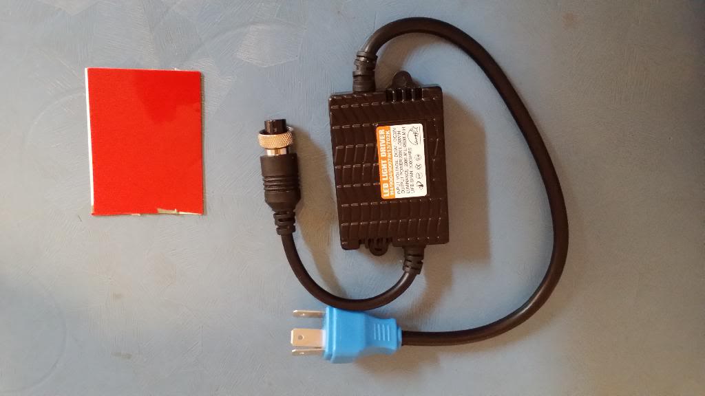

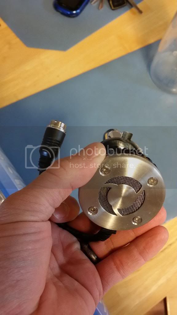

Headlamps!
And if all goes right i'll be installing them tonight (in stages to show the differences)

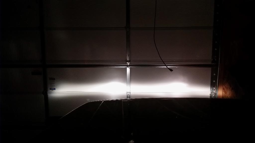

Alright! Got it all done. Hope this isnt too many pictures as i took a bunch of the installation and results!

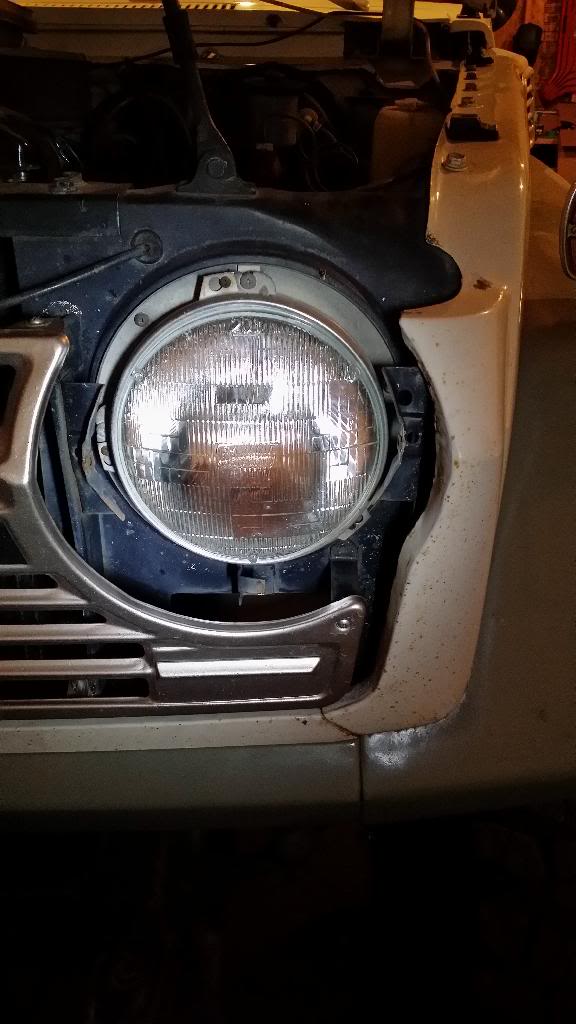

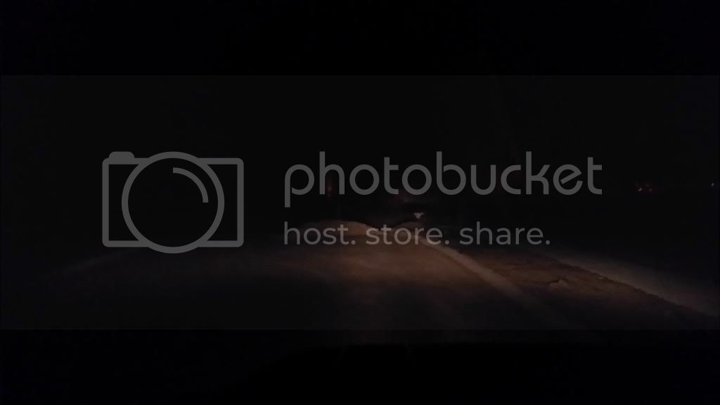

Stock Sylvania "Performance" light
Out on the street pointing into a field. dims

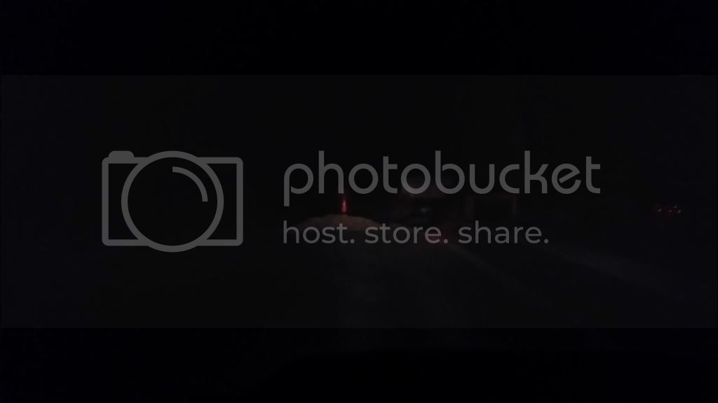

brights :
apparently the brights lift to high and dont reach the trailer in the field. The trailer was seen better with the naked eye, pictures dont really do it justice IMO. but you'll see the end difference. (that little shimmer is the a reflecting T-post, sad)

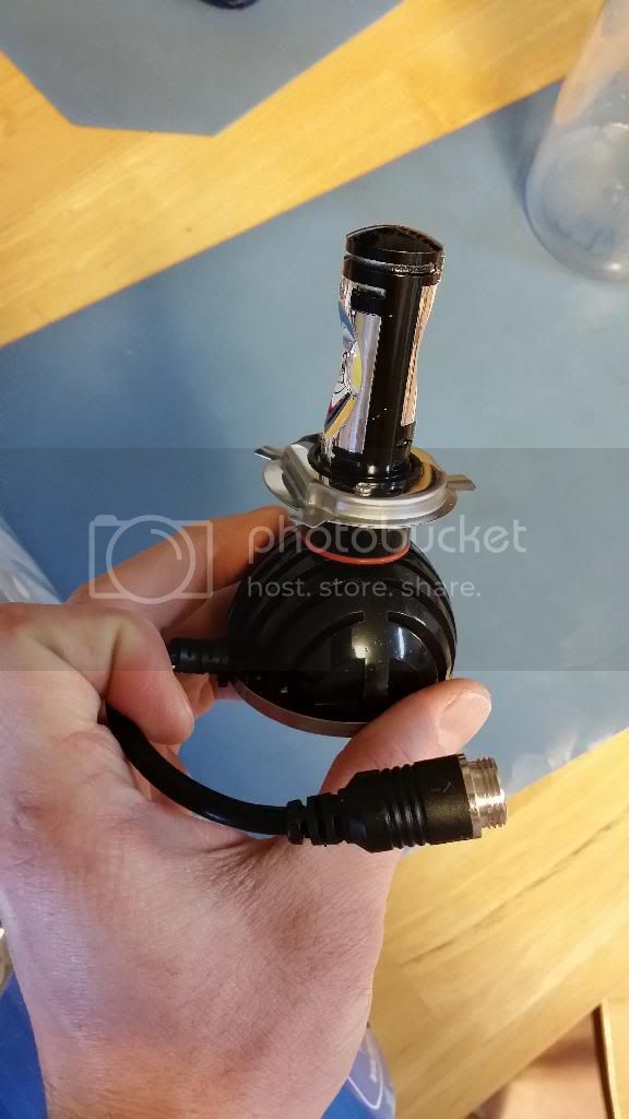

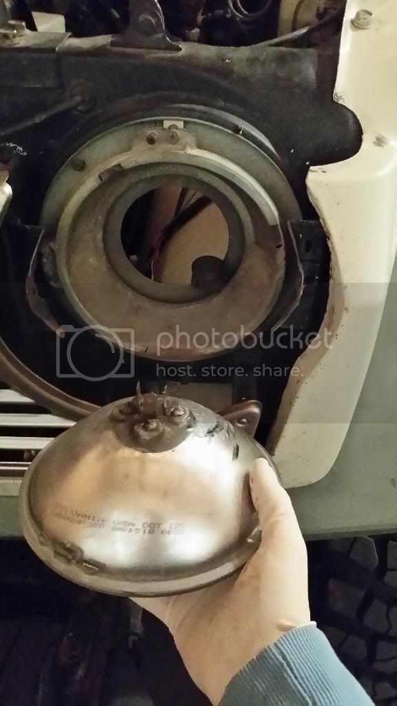

old bulbs coming out!

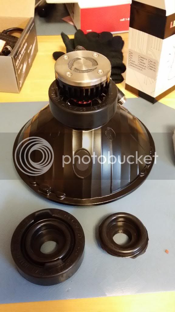

housings getting ready for the HID bulb (rubber cap removed)
HID installed

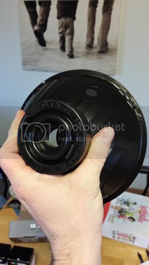

As you can see here the factory weather seal. It doesnt fit around the HID, these housing are originally designed for a standard H4 bulb. I trimmed mine so it would at least somewhat protect it, hence the chunk on the left is what i took out of the center.
