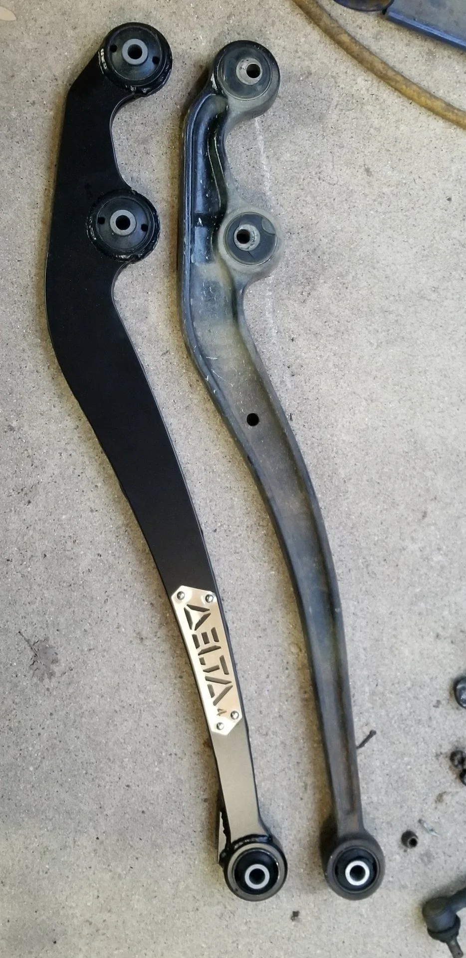

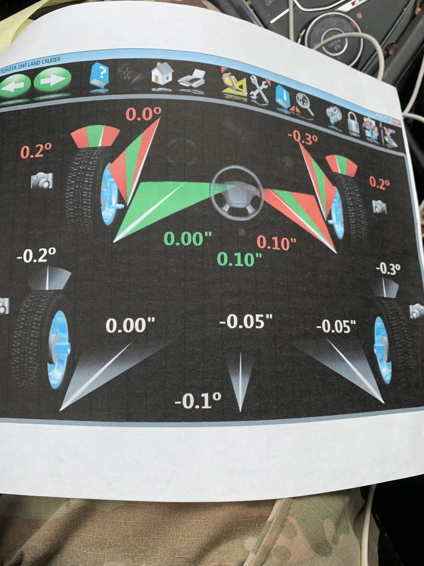

What’s up guys finally got around to installing my lift but I’ve run into a problem. I thought by adjusting the OME front panhard rod and recentering the axel it would get rid of some bad driving habits. Long story short, the trucks caster is still out 2 degrees.
The kit is a complete with the supplied caster-corrected bushings. I have a delta bracket for the rear panhard rod to adjust for a 3” lift. Up front I have an OME adjustable panhard rod. The shop wasn’t sure what he was seeing was right so even after checking the alignment 3 times on his machine he whipped out the ol’ gauges and checked it manually.
What would you do? Get some drop down brackets or new radius arms from superior? I would like the truck to drive relatively normal or as normal as can be. Is still feels a bit floaty as it sits right now.
