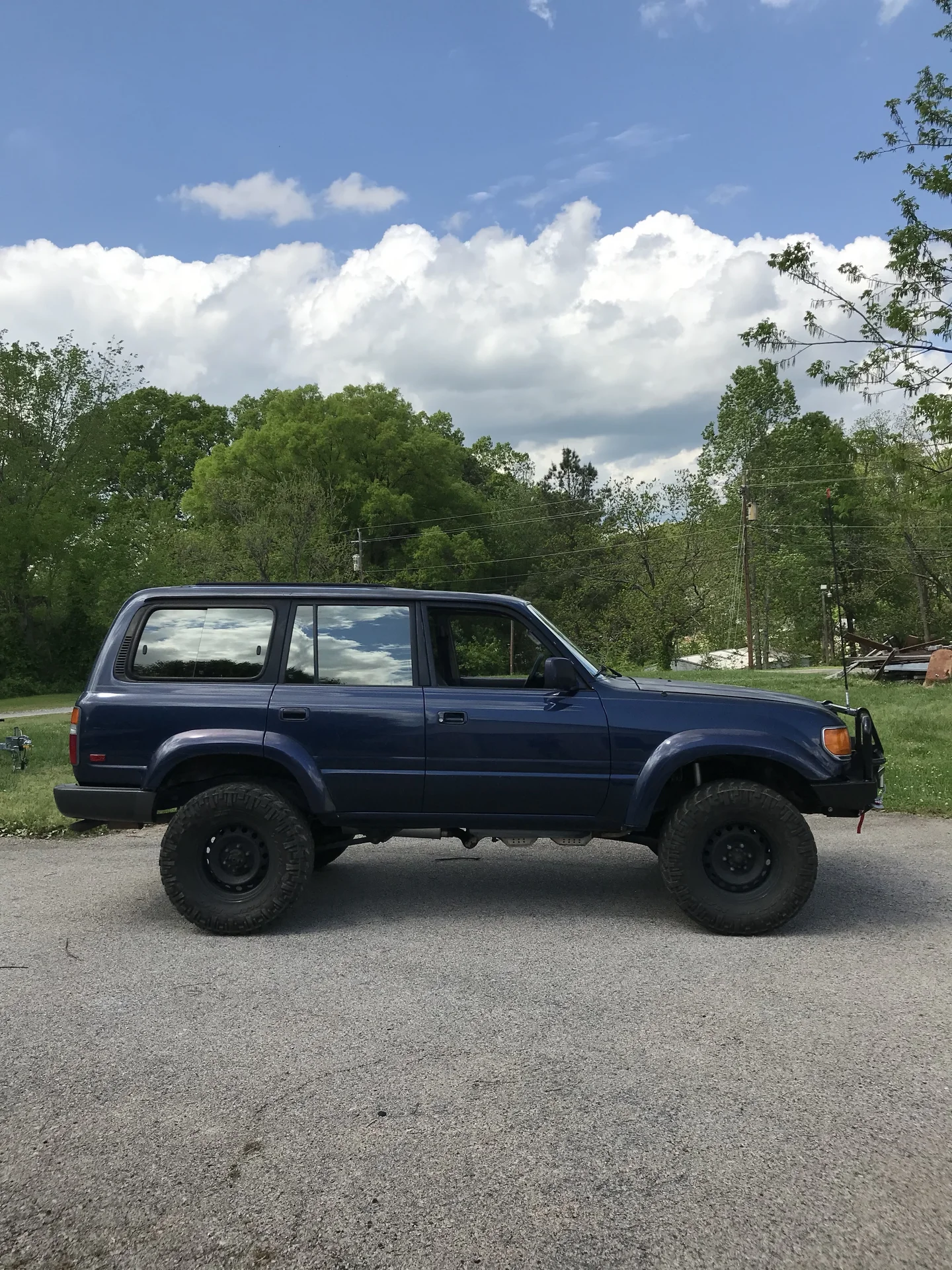

Hey Studawg, would you mind posting a few pics? Just trying to get an idea of stance. Im pretty over sprung right now on OME heavies. The stink bug stance is strong!
This is the day I put it on with no spare tire and no third row and old 315/70/17s. ARB and Warn M8000 with steel cable on the front. It sits pretty much level with just a spare tire and maybe a little gear in the back. Maybe just a slight rake back to front. I definitely wouldn't call it stinkbug though
Looks good! I don’t have a winch but do have a spare tire on back. Appreciate the pic!
