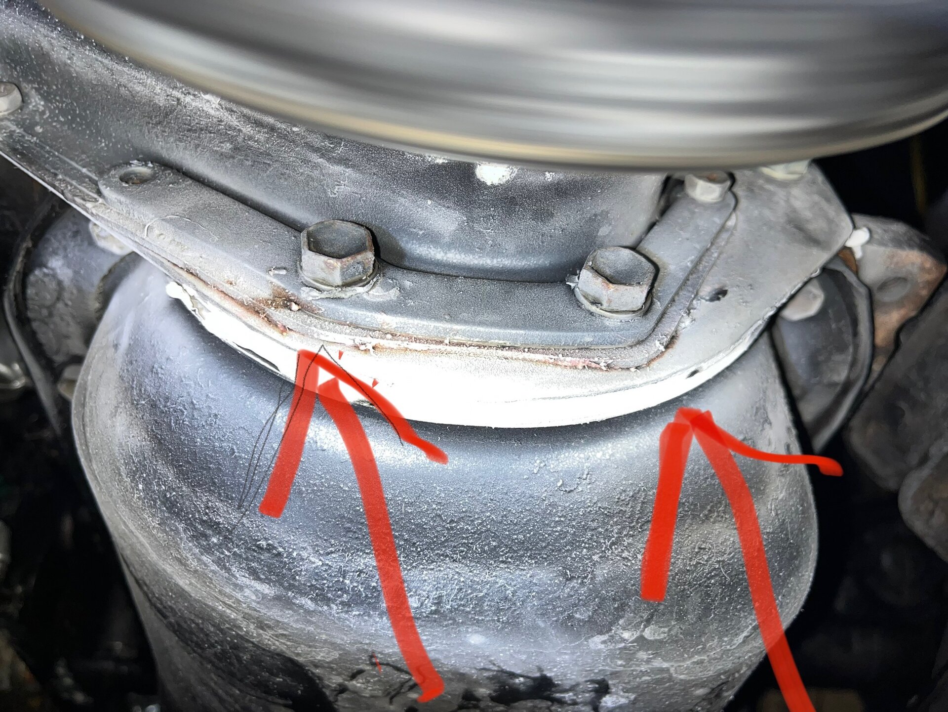

I didn't show my manifold gasket (OEM) that was on the rig when I found a leak by squirting starter fluid around. Engine reved up around this area. I simply pulled this off and took a picture - no rooting around and helping it open up. :rolleyes: (Spoiler alert, new gasket = no leaks! but I still had/have no secondary engagement on the Carb - failed the paper clip test, again.)

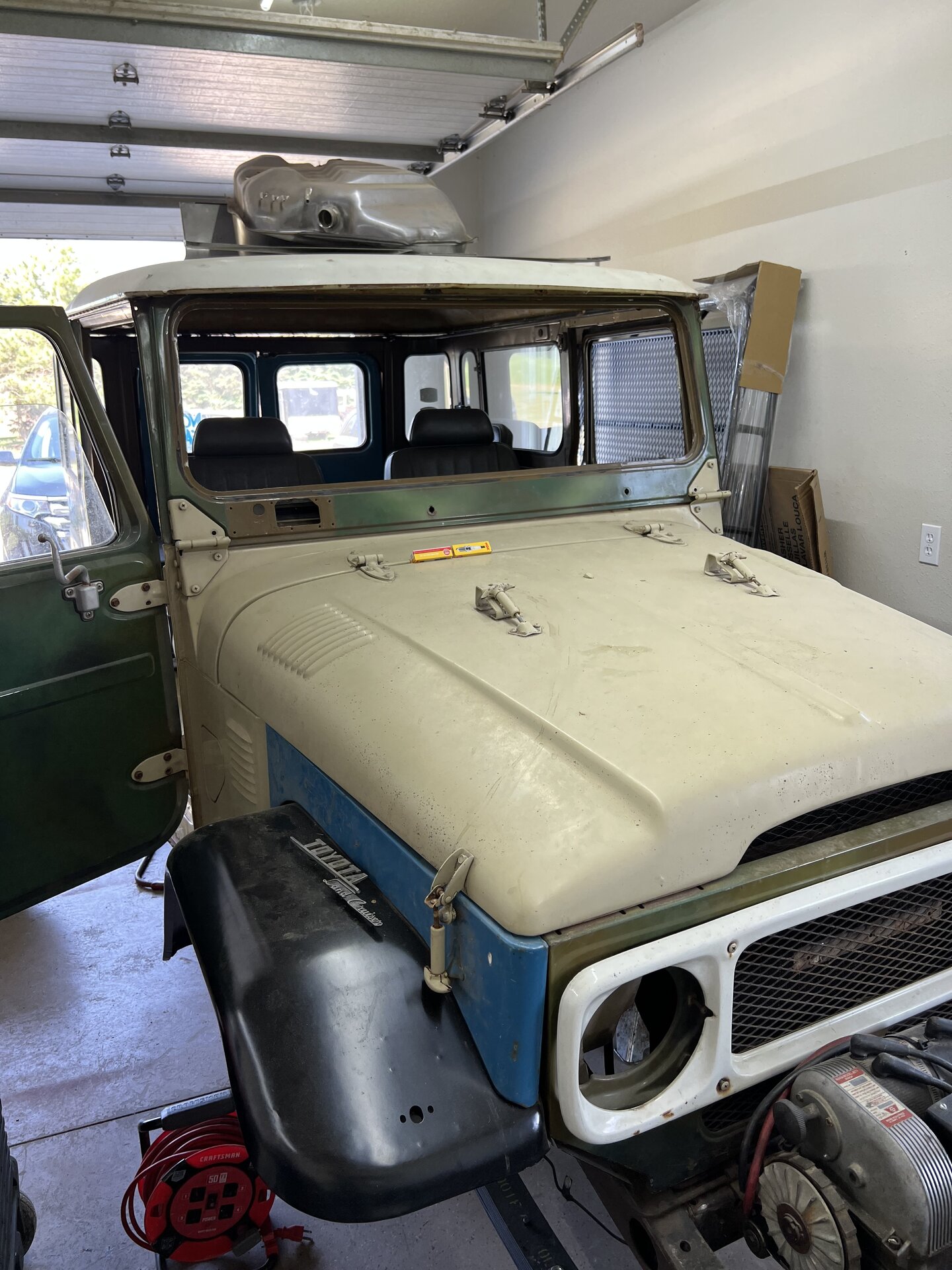

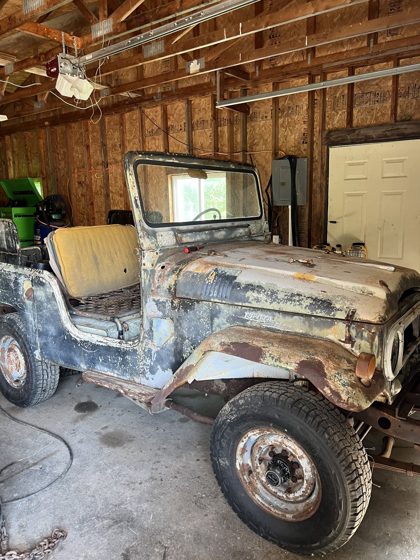

Saw a couple unicorns in Wisconsin this morning - a 1962 & 1983. The 83 has 41k miles on it. It was purchased with the sole intention of snow plowing. Saw the window sticker from the when purchased from dealer. Was cool to touch the “Land Cruiser” stamped bezel on the 1962!
Well I got what I was after and a smidge more. Pushing it back home to make the Amateur Autopsy meeting at the Quonset tonight. It is ‘Open Mike Night’ 🤪🤦‍♂️
Wow that 62 is sexy! Backstory? And...for sale?

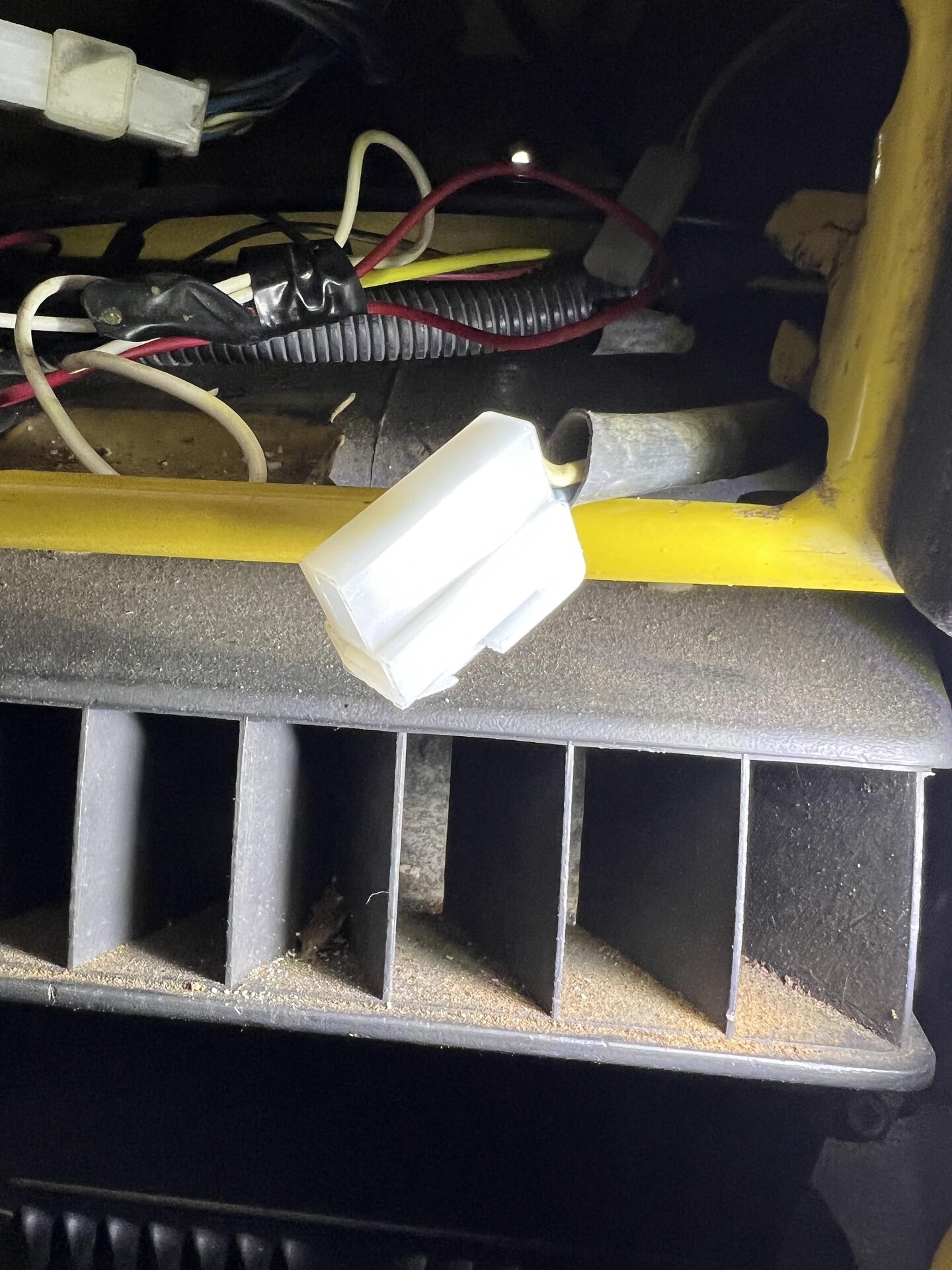

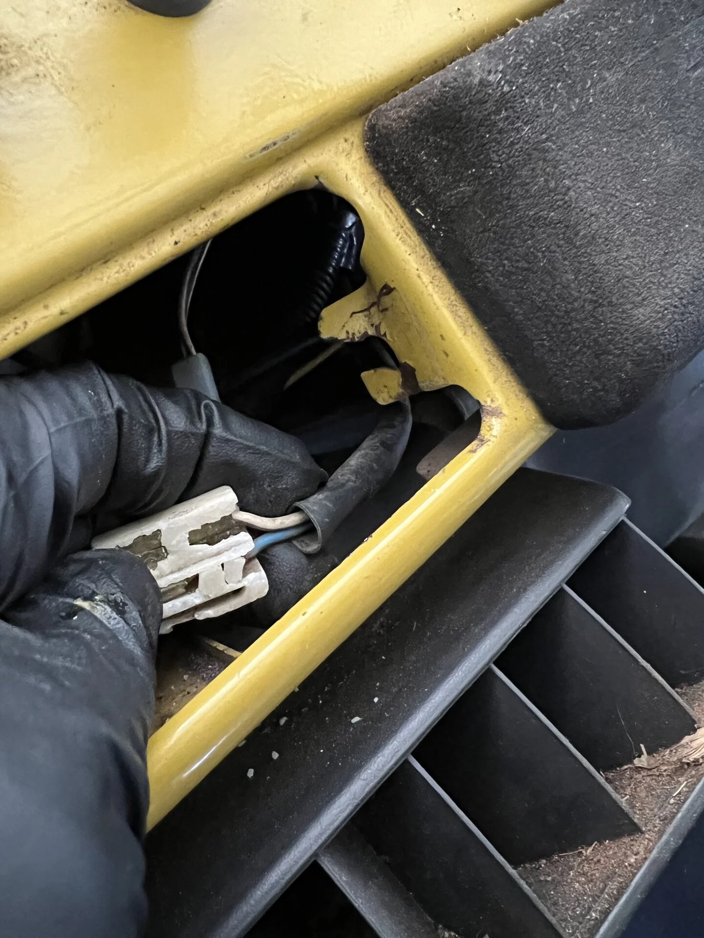

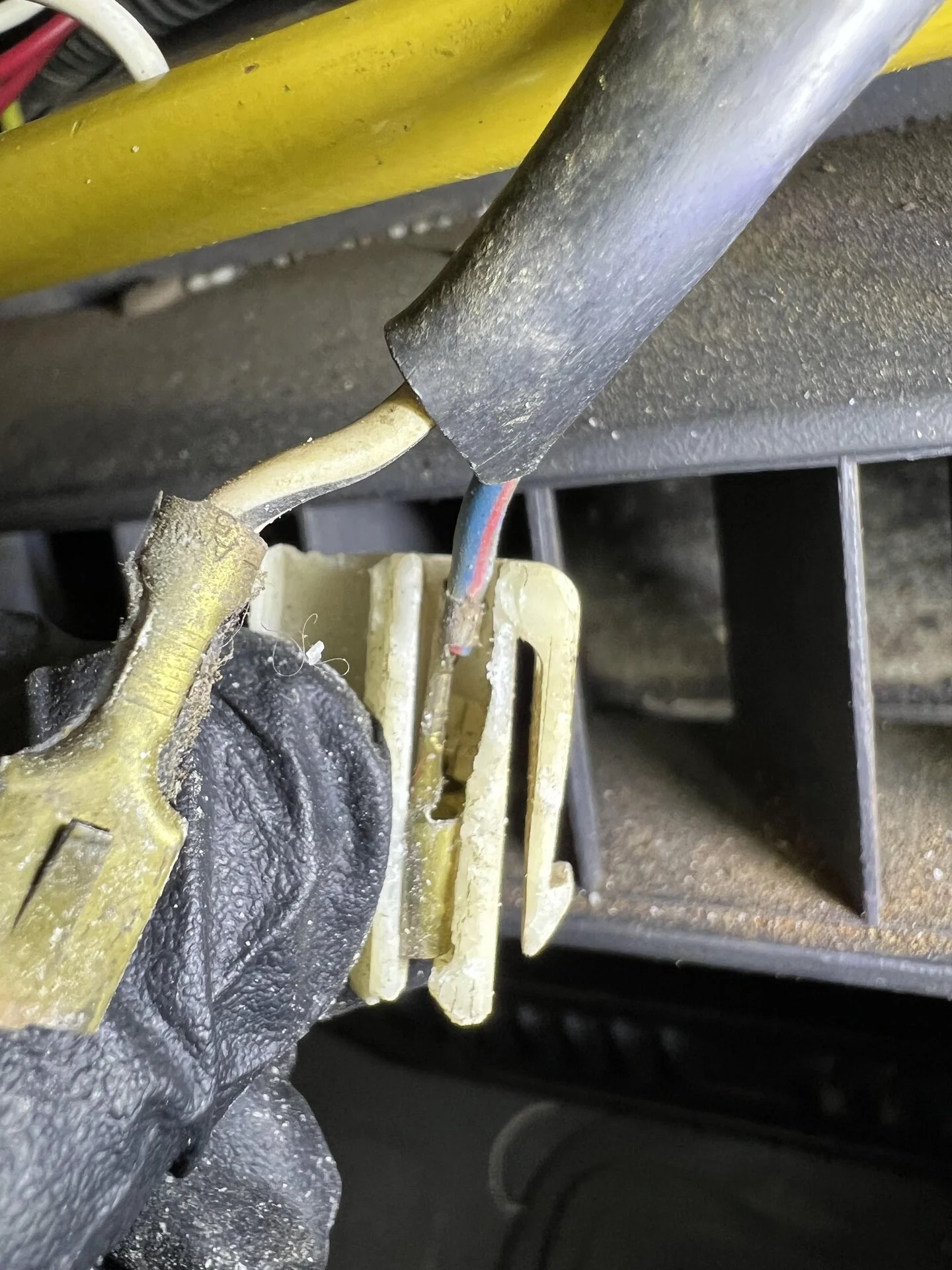

Got a power probe out to find switched power for that Bluetooth radio from @thecrazygreek. I don’t want to wear headphones driving.
Found it and looking at the wire diagrams/color – seems to be the radio connection anyway – the connector is brittle and crumbles to the touch – ordered some new connectors from @Coolerman

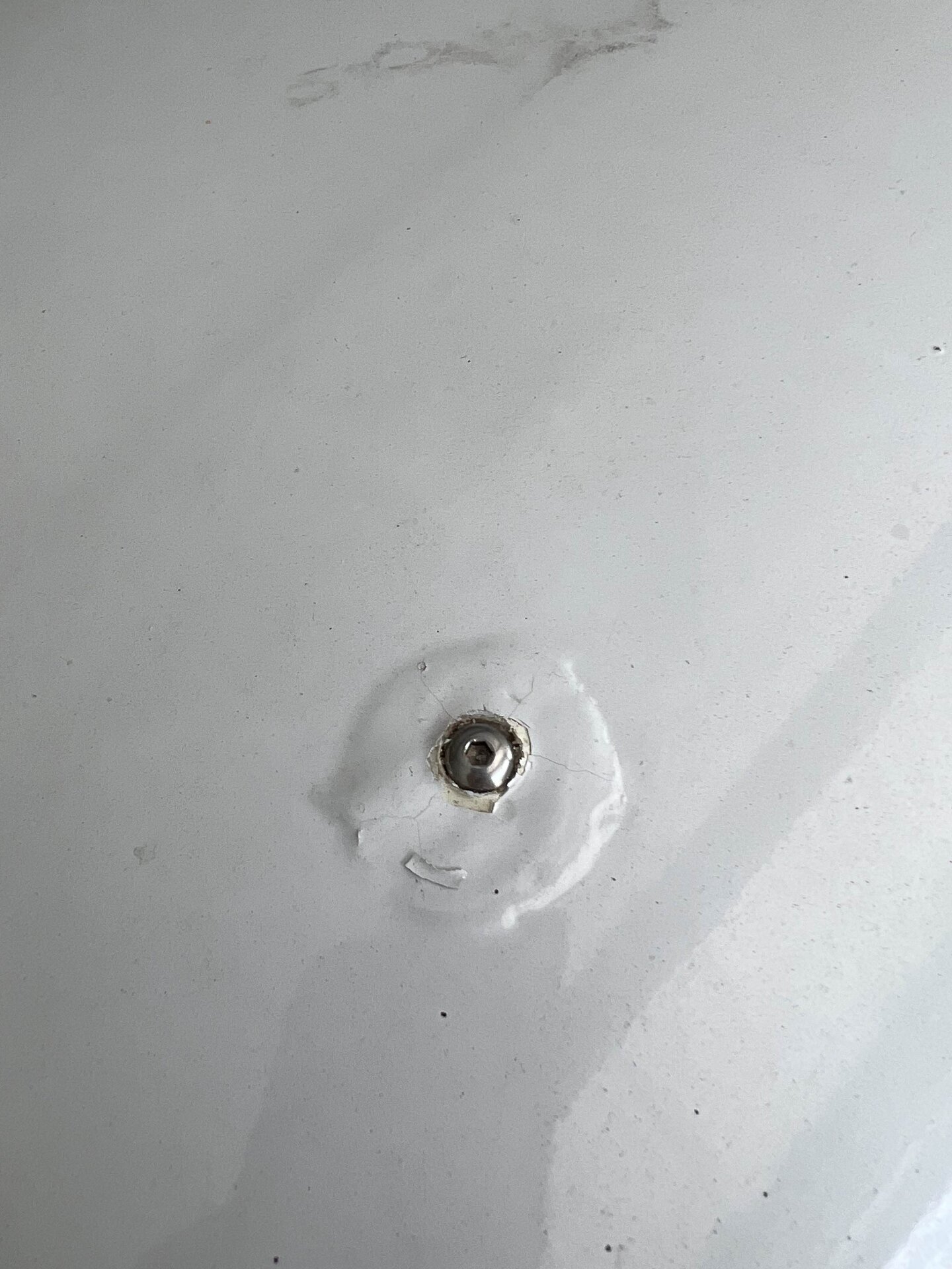

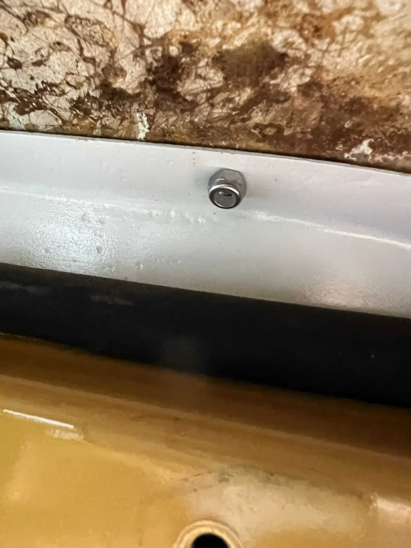

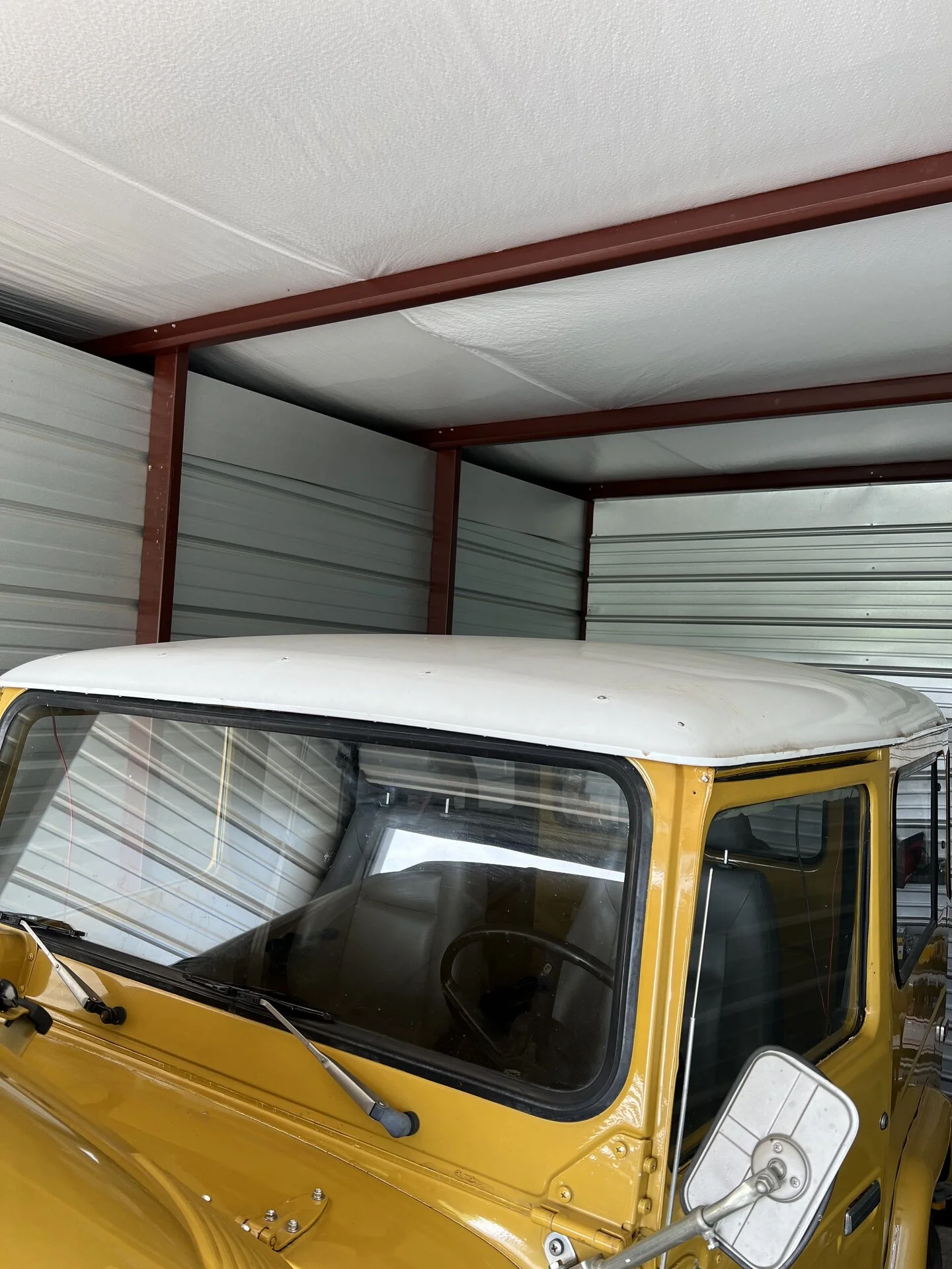

Got the roof on - did a quick fix to get the visor attached to roof - long term is to rivet. Got #4 screws, lock nuts etc. Not the best but will hold while OL YELLR goes to the vet next weekend.
This is the lock nut from the inside....

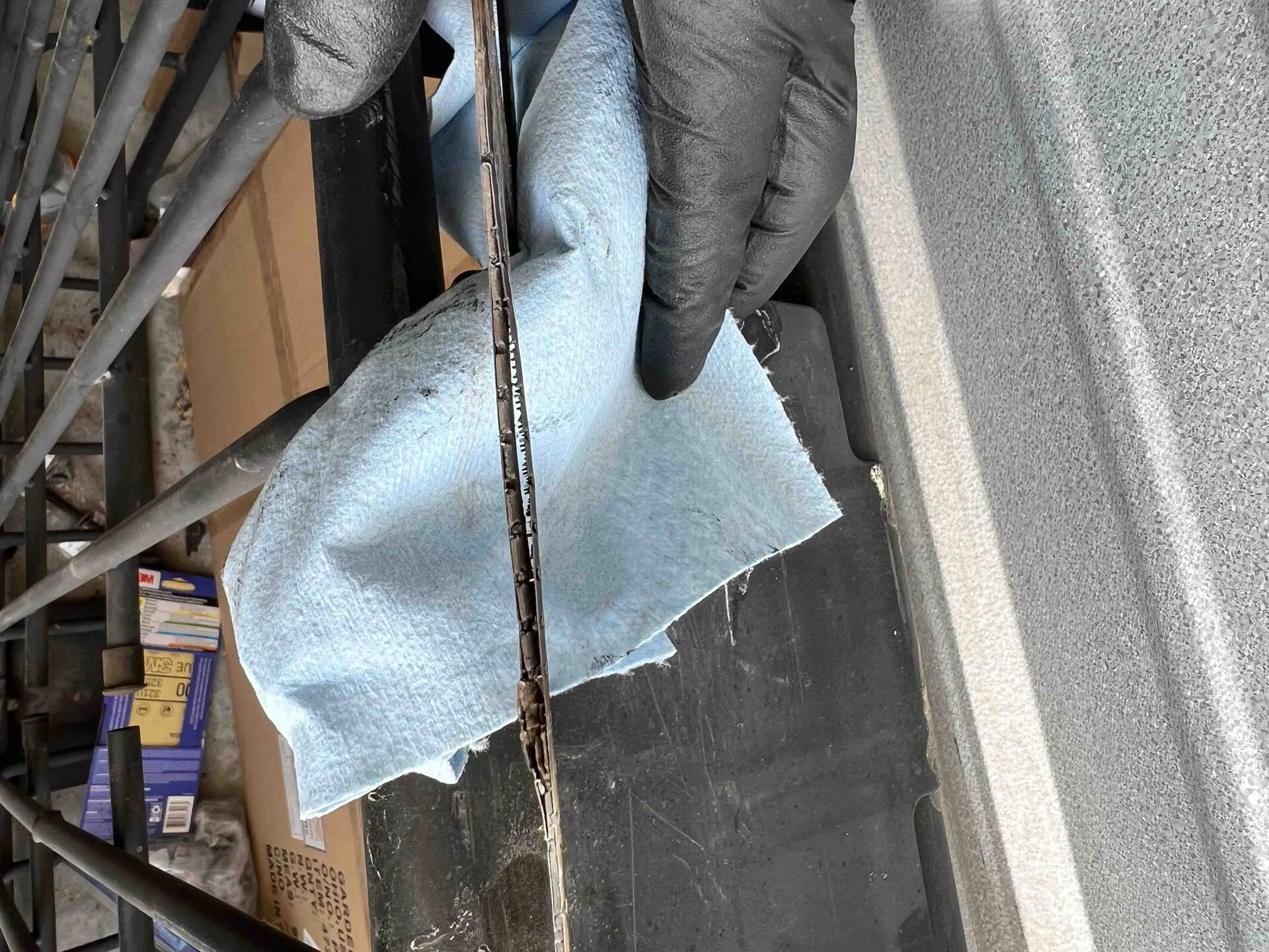

Ended up using the new OEM packing - old was was too far gone.
I can't remember the backstory on the 62 at the moment - and their intent (two brothers) - One just got a Land Rover and is intrigued by it (though been a Cruiser person for the longest of times). The other brother is going to restore and keep the 83. (Lots of rust only being a plow rig in WI - lots of rust).
I digress - they want to get it running, fix up some parts (IE Seats) - keep the patina as is - and put it in some parades then sell it. Brad said about a year or so to maybe be on the market.
They also have a 78 that has been stored for a long time. Some LC parts person is leaving the business so they bought what he had. Said when it was parked the rear-end was foobared - so they said they have a rear for it and will eventually put it up with a new rear. I need to tell a local about it who is looking for his first Cruiser - I have not laid eyes on it - and I offered to come help inventory what they all got buying that person out.

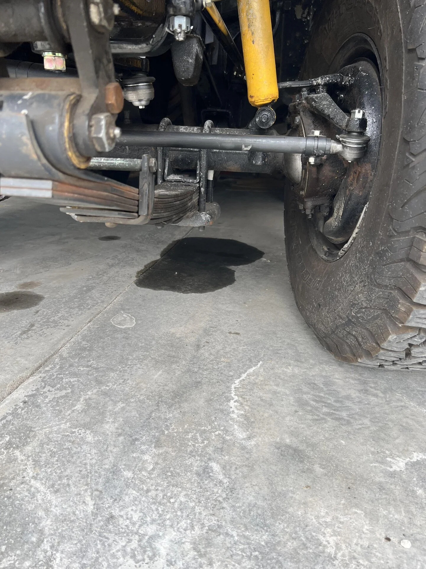

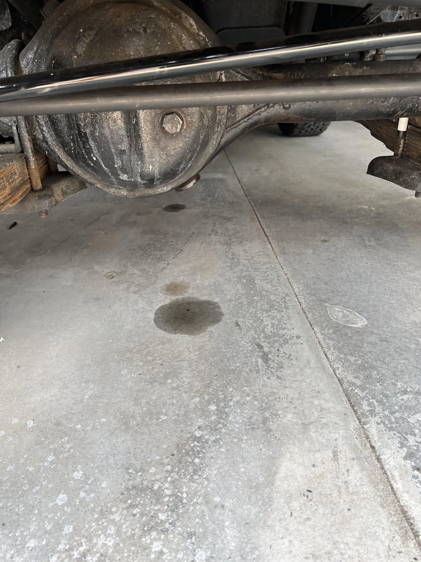

Got OL YELLR loaded up last night and celebrated with pizza and some Yuppie Brew. Two days ago, I notice some spots under it, yesterday a third and bigger spot under it - (been sitting still for weeks - such a good boy, stay). (One pic from Thursday, one Friday)
Thursday (two spots a) front diff, b) the back one I see is at the flywheel/bell housing).
Friday - WTF

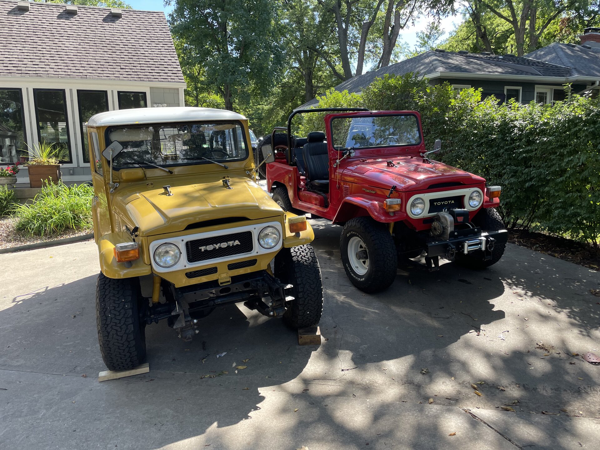

Found the timing was way off – set that back, no difference in power/performance. Also, the HEI that came with the rig when I got it didn’t have stoppers or whatever they are called in the dizzy when we opened that up. So we transplanted the dizzy, igniter, coil from the red 40 in the picture above – no change in power etc. Didn't expect it - but throwing the kitchen sink at it to justify the beer on a hot day.

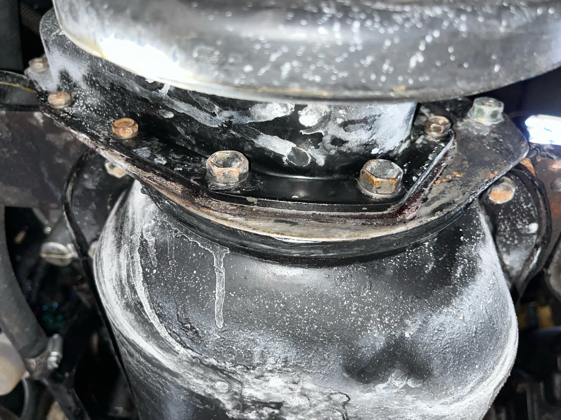

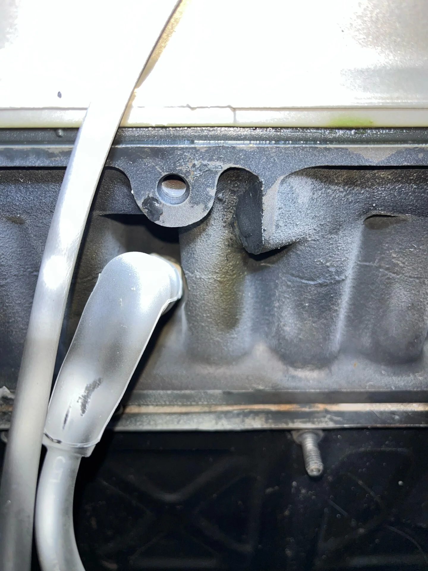

Basically $11 in baby powder spread all over the engine to find leaks. First up - the galley plug - the machine shop last year was told to address it the galley plug - and clearly it leaks - when the head is in the shop soon - going to have it tap/die and a plug put in - saw a thread ( Oil galley head plug - https://forum.ih8mud.com/threads/oil-galley-head-plug.191622/ ) vs some JB Weld fix or whatever. While not the best news with the "address it" last year - could be worse - could have squirted all oil out and completely seized the engine.
the leak presented itself earlier in the spring as leaking from the valve cover gasket - or had me thinking that must be it - Score 1 for baby powder.
More baby powder experiment - this is without starting the engine and just waiting over time... (yeah - noticed the missing bolt as well).
This is first applied...
Then over some time - this evolved by doing nothing

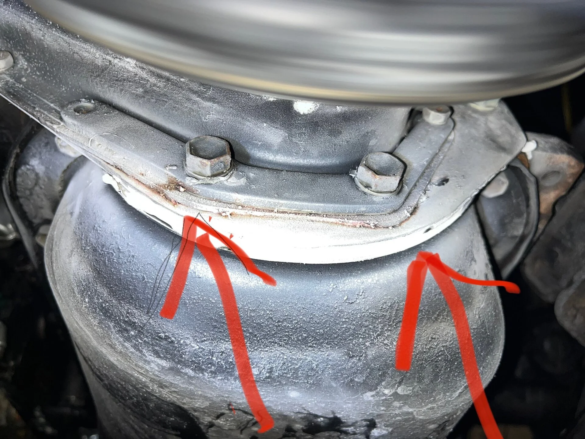

Another experiment to find leaks in KC - This time what happens when you dump trans fluid down the carb to make it smoke...
The smoke is coming out where the shaft is going through the manifold. TLC needed for the manifold when taken apart.

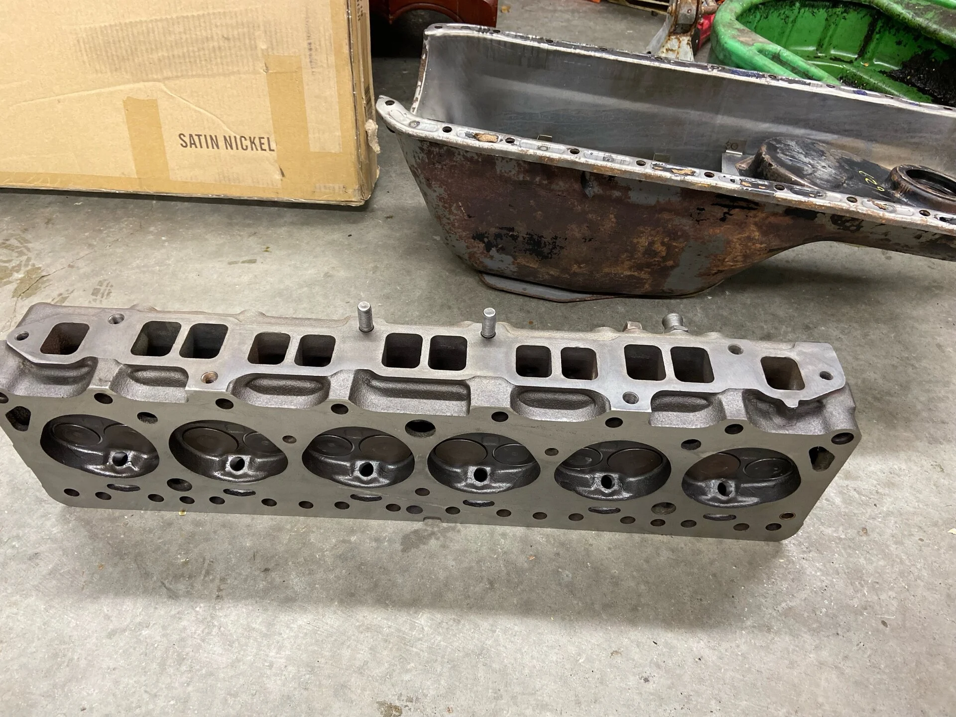

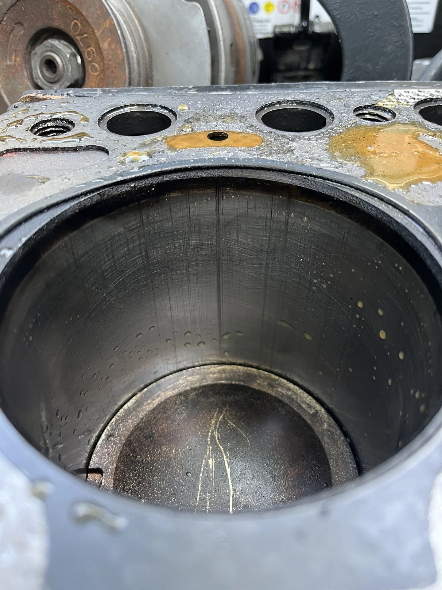

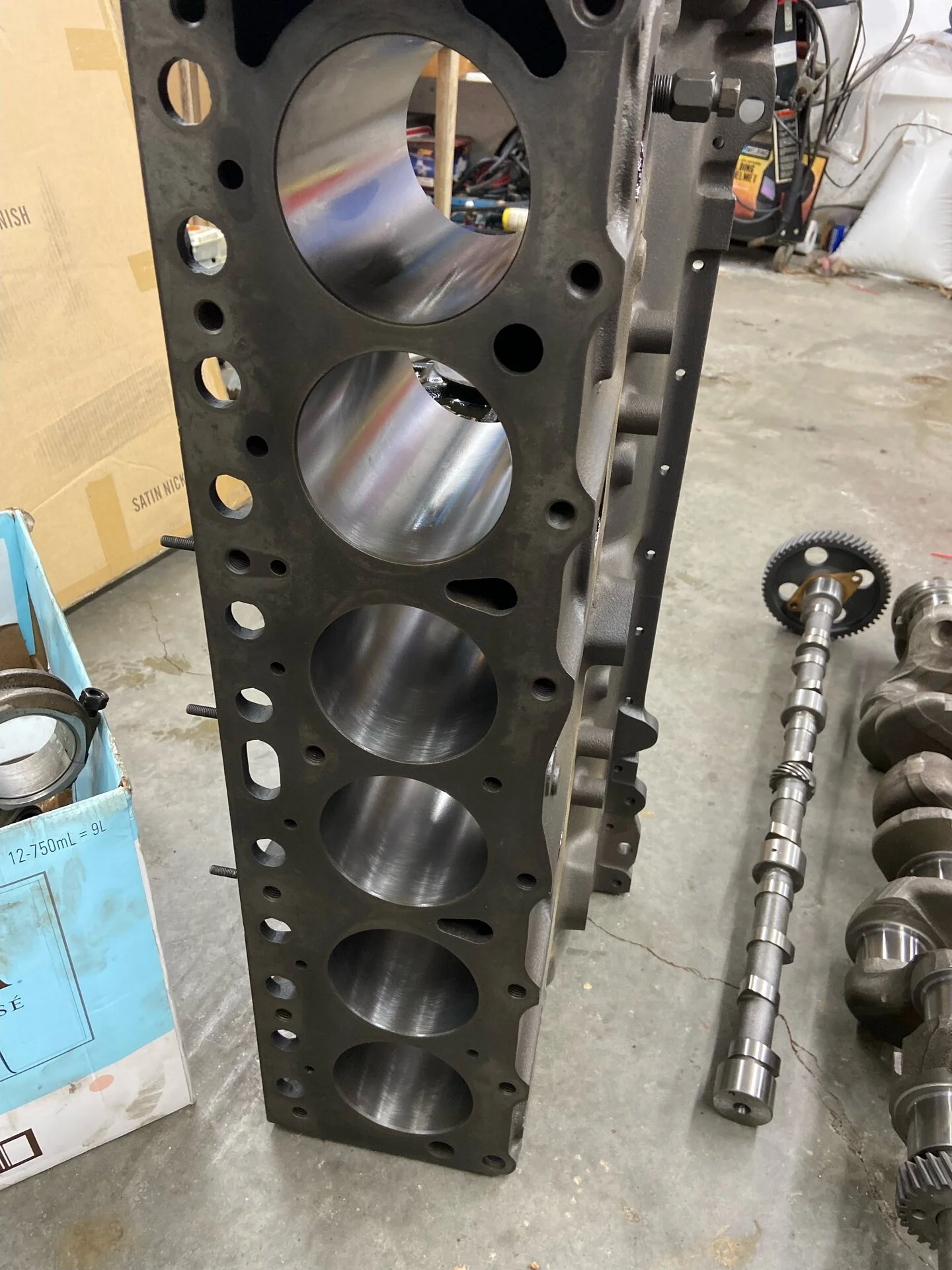

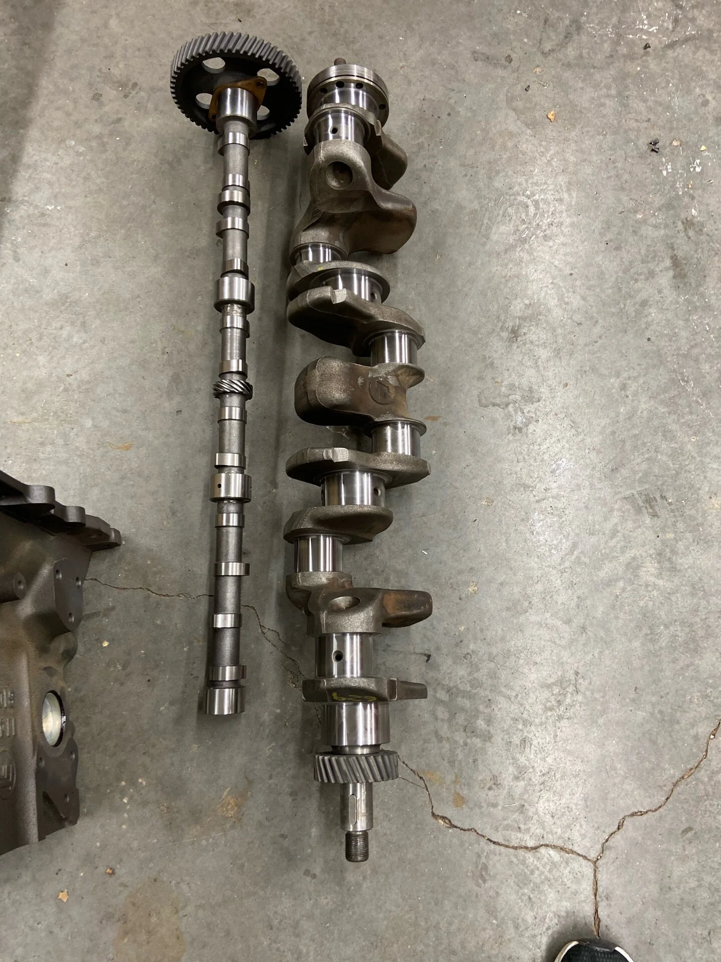

Engine teardown and eventual removal in KC part duh/deux. Removed the head & can see & feel cylinder walls are scored. Decided to pull it all out late last night vs doing it today as there was plenty of horse power and gas in the tank (aka beer). All going to the machine shop. Nice part is I get closer to front of line status vs wait 8 months.
