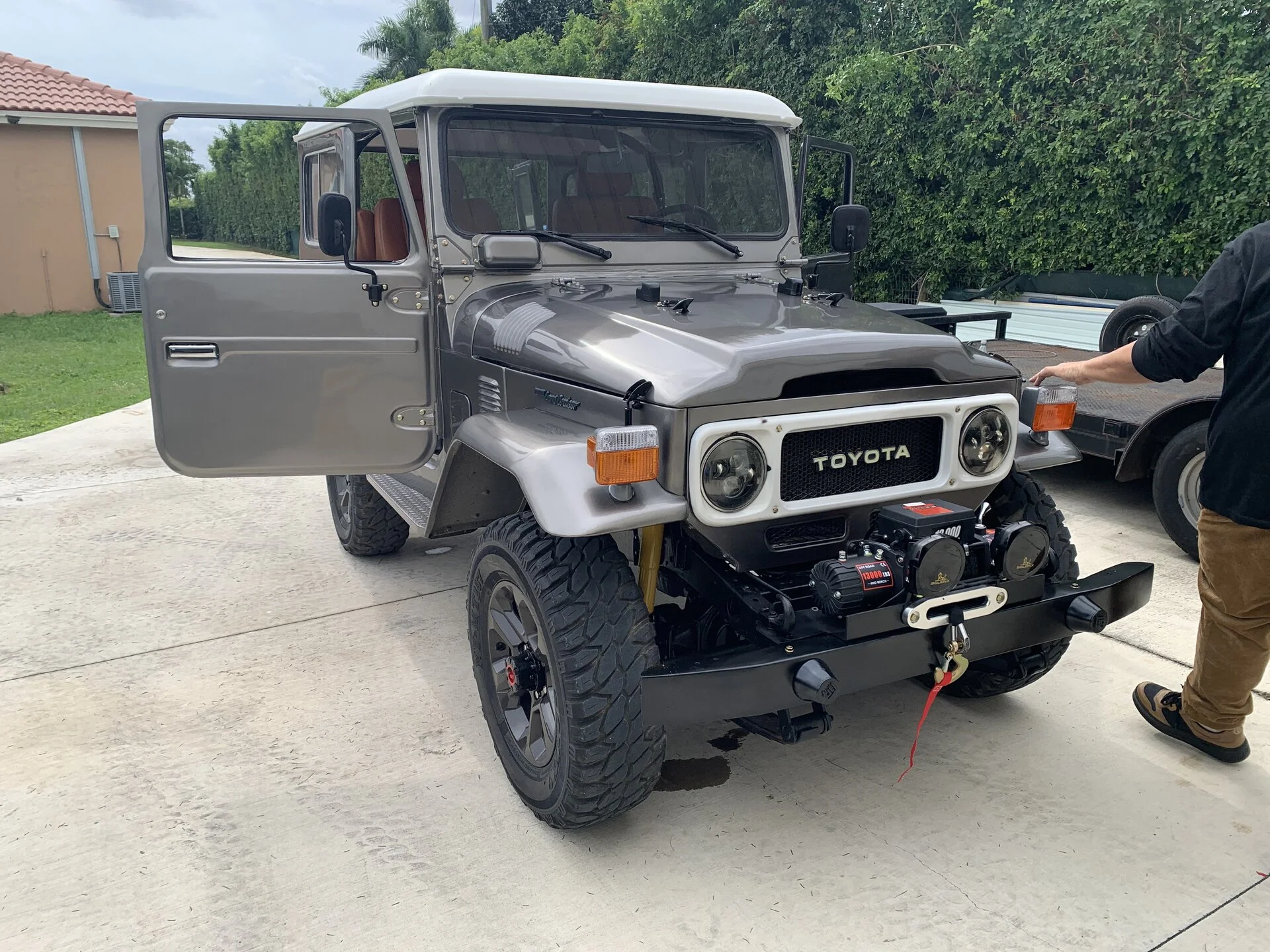

Hello All,
My name is Max and I am the proud new owner of a ‘77 fj40(pictured; likely a Columbia FJ since there’s NOTHING in place to add a heater). It’s in great shape and restored by the PO, but he’s in Florida where there’s not much need for heater…which is a little different than Chicagoland! So: my first project is to add a heater(seems like vintage air 506101 is the way to go?) so we can enjoy it year round (also doing fluid film to keep rust at bay).

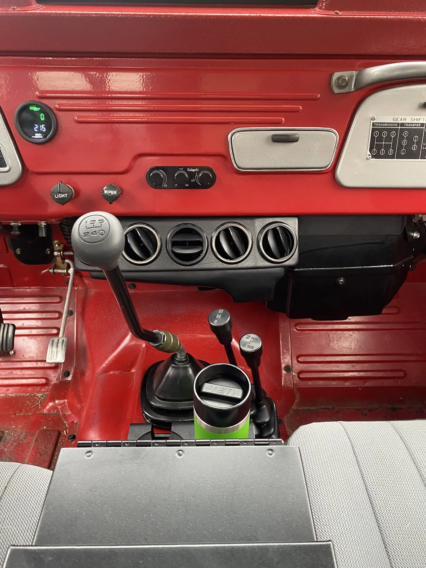

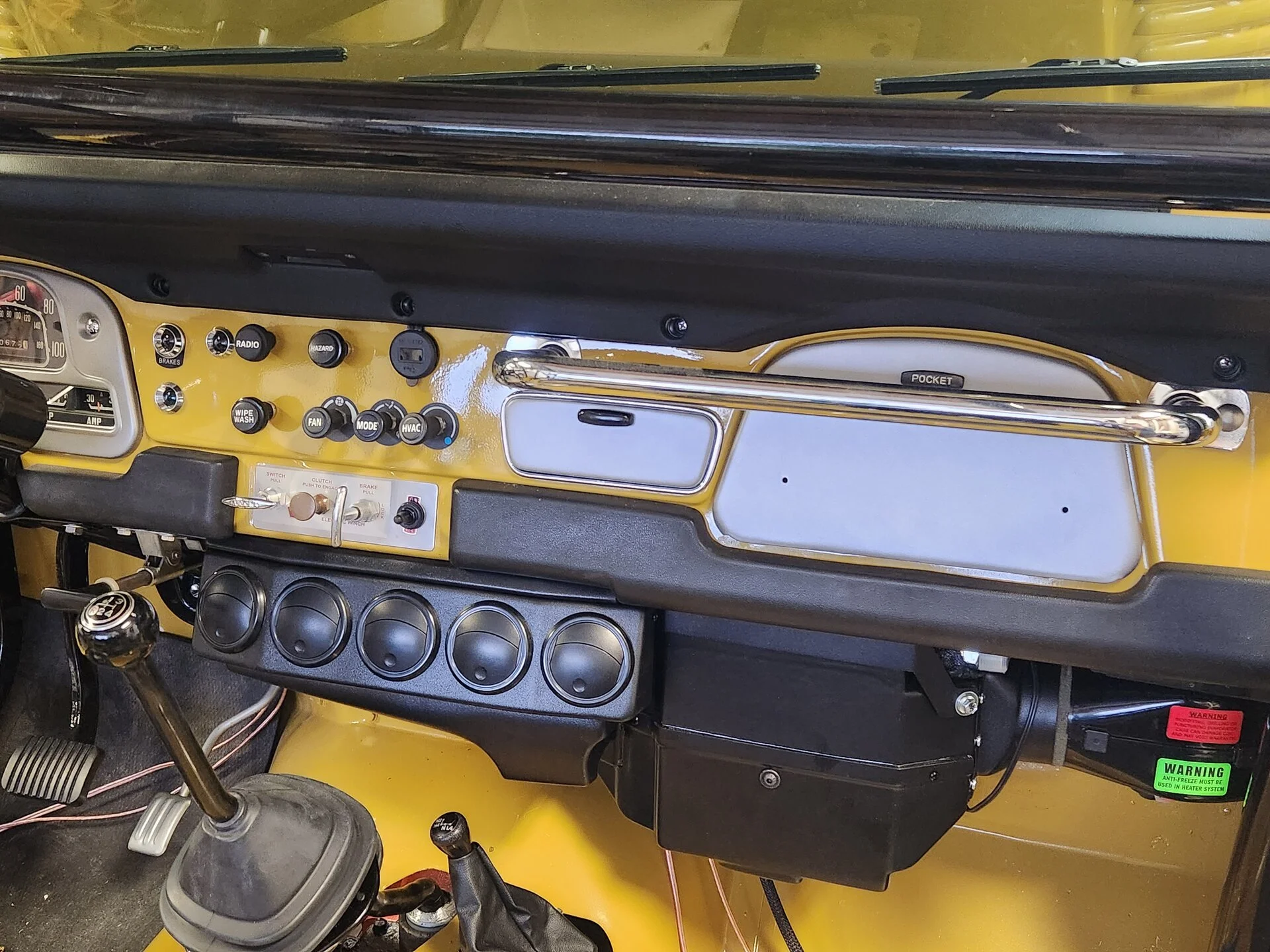

I just completed this on my FJ45. I took all of my original heater system out and bought the Heater/AC system. Super happy and works well. Comes with pretty much everything. If you go with the AC/Heater combo you will need the compressor and all the ac lines, both of which you can buy as a kit from Vintage air.
I also bought the extra billet aluminum back lit controls from them as well. I didn’t like the plastic knobs that came with the unit.
Heater & AC - Kit has all you need based on what you tell you them for your configuration.

Thanks all for the information and pictures of installs- if I can get mine looking as good I’ll be thrilled! To answer the question: I’m just going to get the heat(not AC), and it sounds like the best next step is to reach out to the vendor for all the necessary fittings. Thanks!
