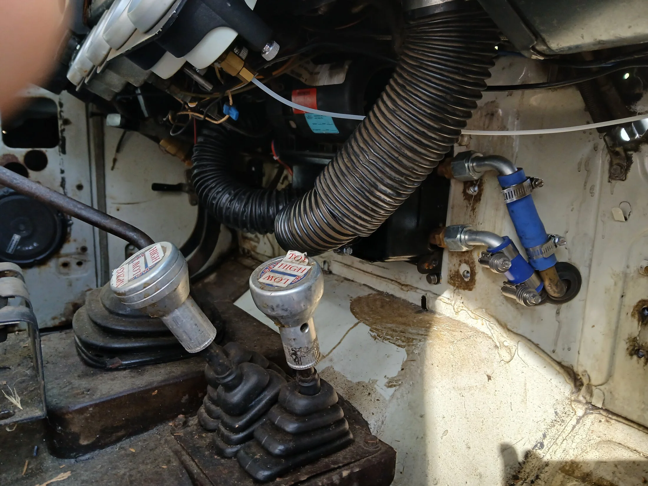

Vintage air heater is great- if you aren’t staying stock definitely an upgrade. I like the electronic mixing valve, no cables and integrated blower. Also the 5/8” outlets come with it as a 90* but can be cheaply replaced with the proper angle that hugs the engine blister/firewall. Even running without doors and a top- the heat is noticeable.

Seems to be more of an on off- but no cables to deal with and the off is really off.
The vintage air heater frees up a lot of room in the engine bay for other stuff and blows a lot of hot air. I didn't use the electronic valve, stayed with a simple manual ball valve, rely on fan speed for temp regulation.
Good to know - I was wondering if I could keep the factory valve and still use the VA set up. Yes, good point on the added space if you eliminate the blower motor... that’s an additional consideration. 👍
Yes. The heater doesn't care how the hot water gets to it. But you'll have an unused switch on the control panel
