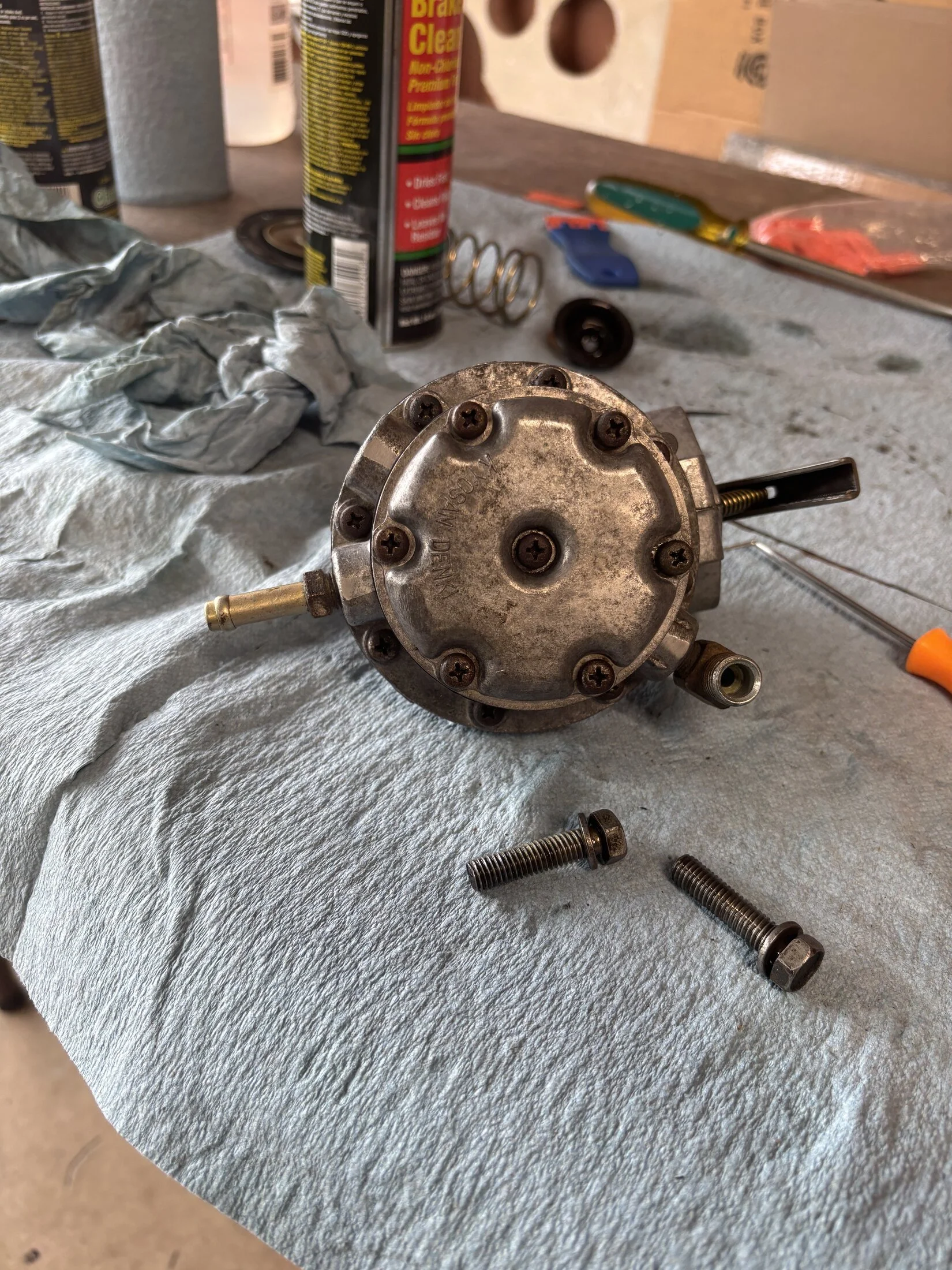

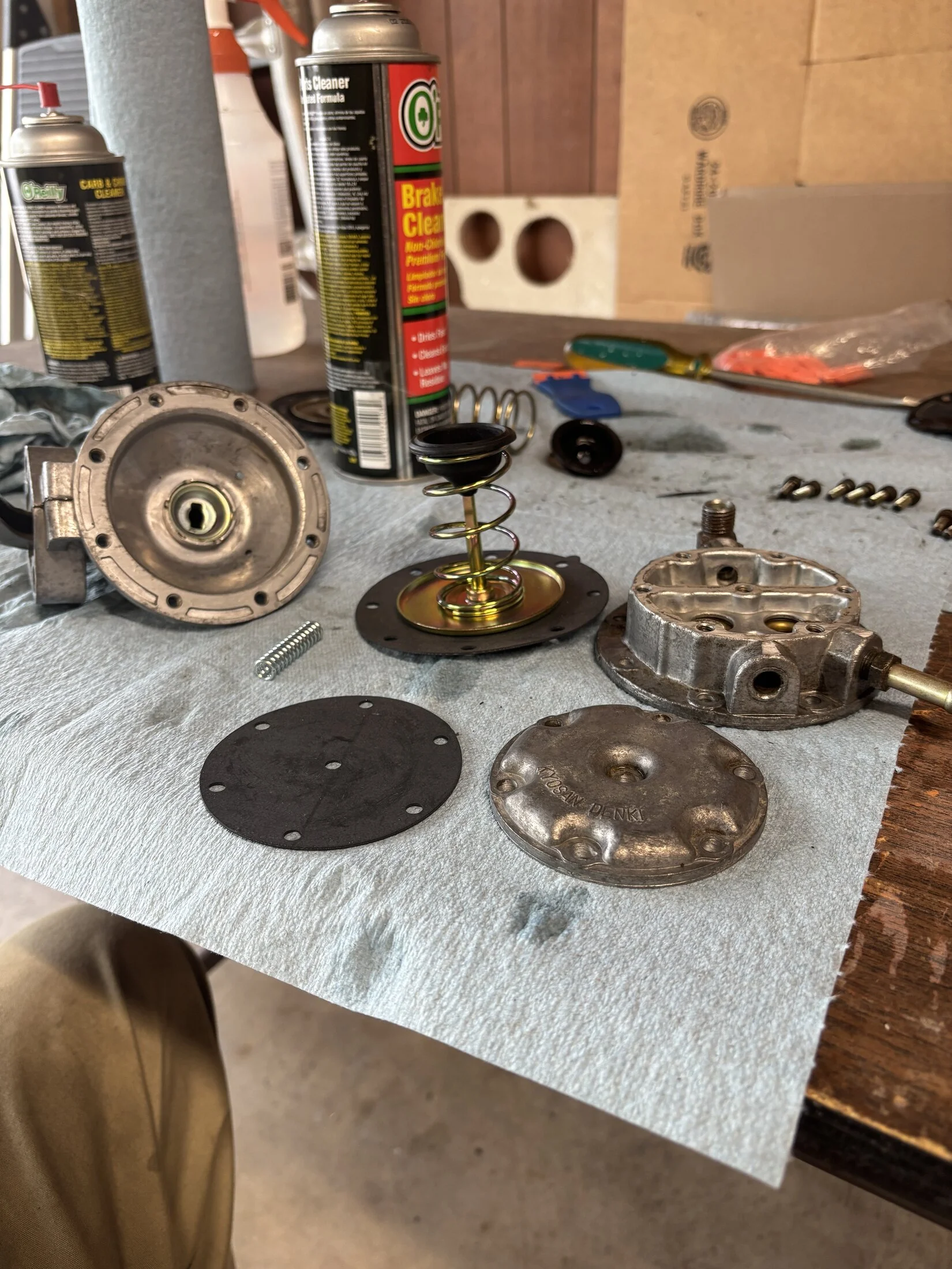

Took a break from chasing the last oil leak to refresh my fuel pump with a kit from @Cruiser Cult
Turns out mine wasn't in terrible shape, but it gives me peace of mind knowing it's got fresh components.

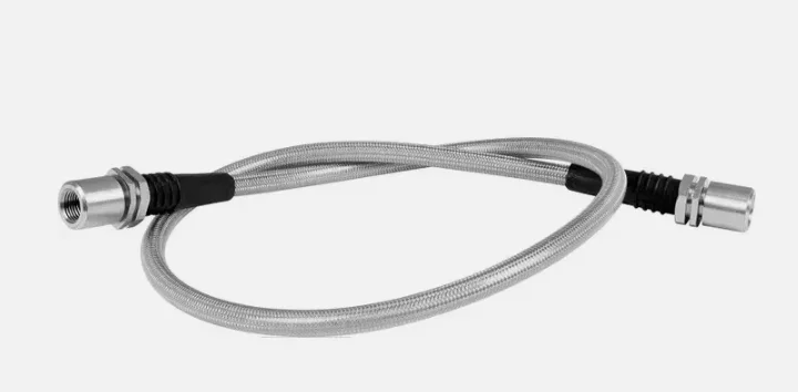

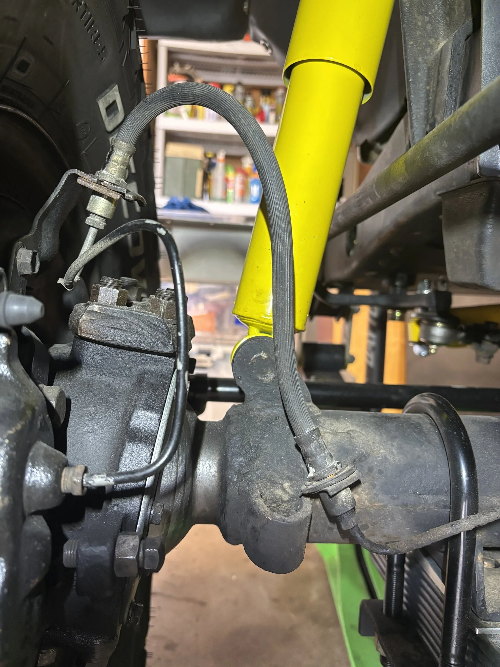

I picked up some new brake lines from $OR and should have paid closer attention to the length and configuration of my disc brakes. Chatting with the tech from SOR he says that the flex hose with the two female ends is a custom hose. (Both the driver and passenger side are like this.) Early in my adventure I was told this was a "mini-truck" conversion and the front may have come from a 60 Series, but even the 60 Series brake lines have a male on one end and female on the other. Any ideas about this or how to source a replacement pair? (Though these don't look bad. :) )
Edit: Broke my own rule about Google first and ask questions later:
Looks like these may be pretty common.
That’s pretty common.
