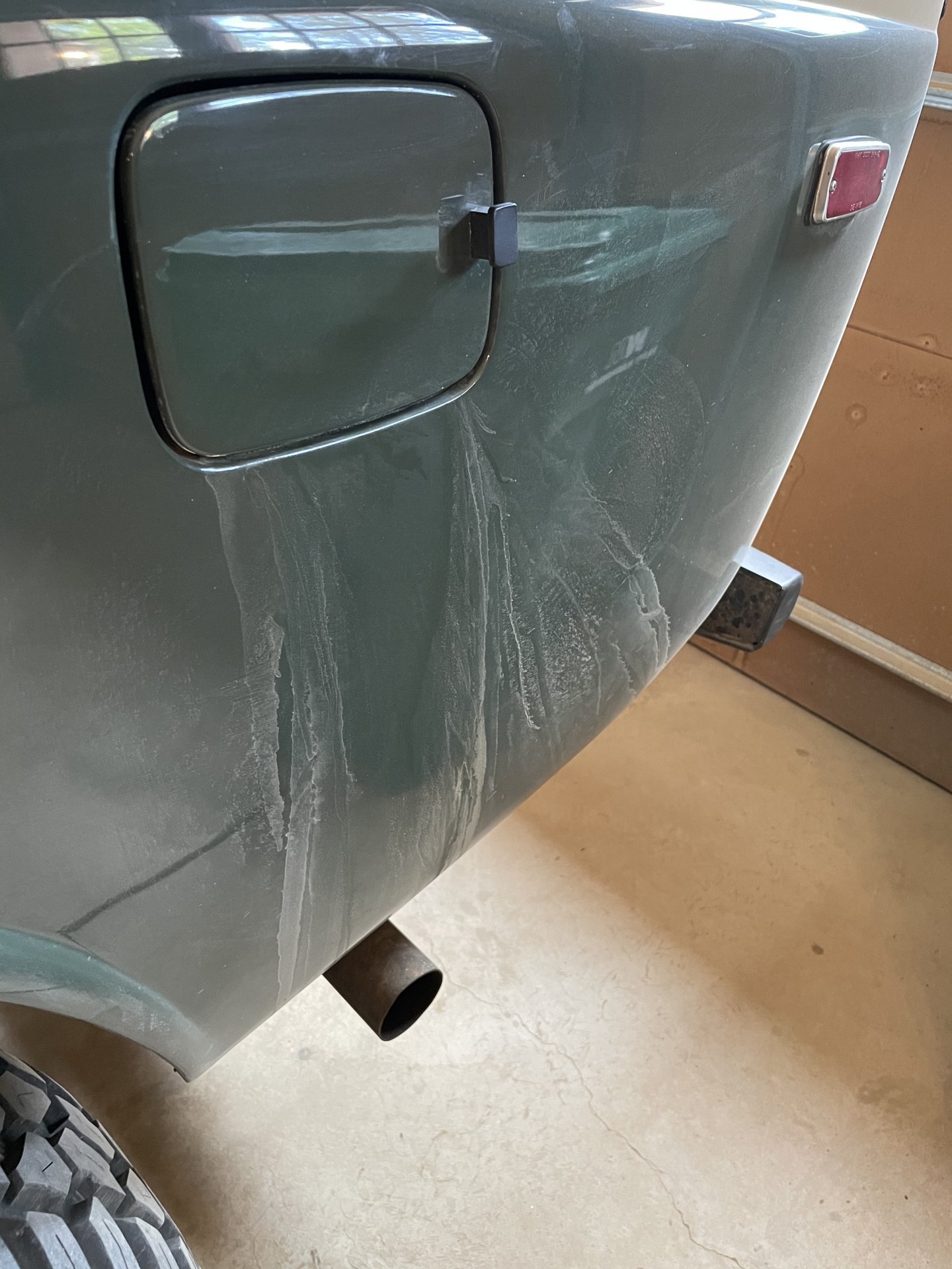

I ordered a 2 inch filler neck and cap from Fillerneck Supply hoping to solve my full tank fuel spill down the side of my 55.
The install was relatively straight forward. I had to cut some of the filler neck away and install rivet nuts. (What did I ever do before I bought a rivet nut tool?)
After all my work, I still have my full tank dribble down the side. Hmmmm.

Fuel only seems to dribble out when going down the road so I assume sloshing is the cause vs pressure. If it were pressure I would see it dribble while idling.
I think it is the slosh. Mine does it too when I have a full tank. I still have a crap cap that doesn't seal. I know my tank is vented well. Spent a lot of time on that.
I use a non-vented screw in cap and can put 60 gals. in my 55 gal. tank with no problems other than paying for it. I do have a vent line running to a canister up front and the stock emissions tank in the cargo space.

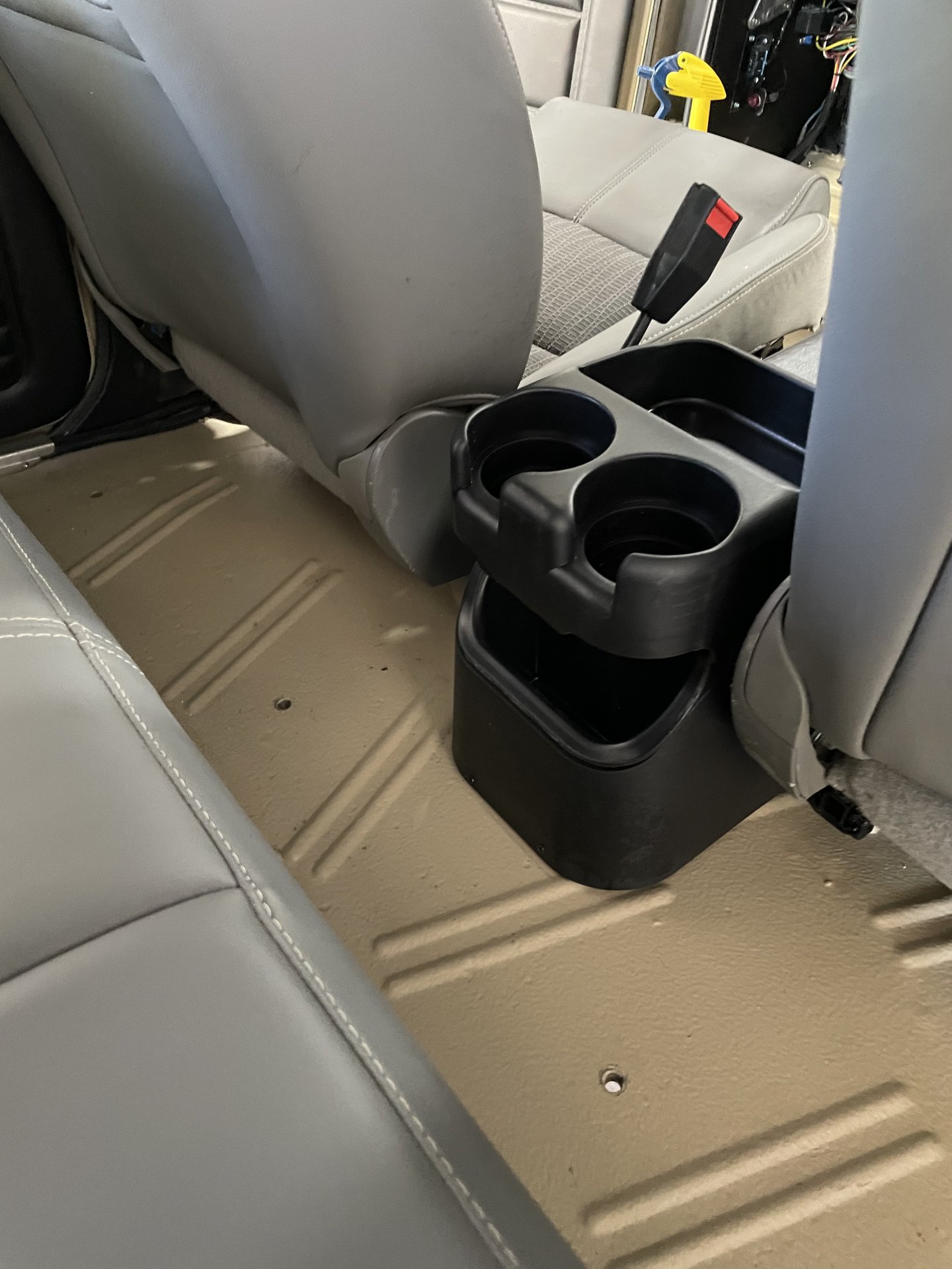

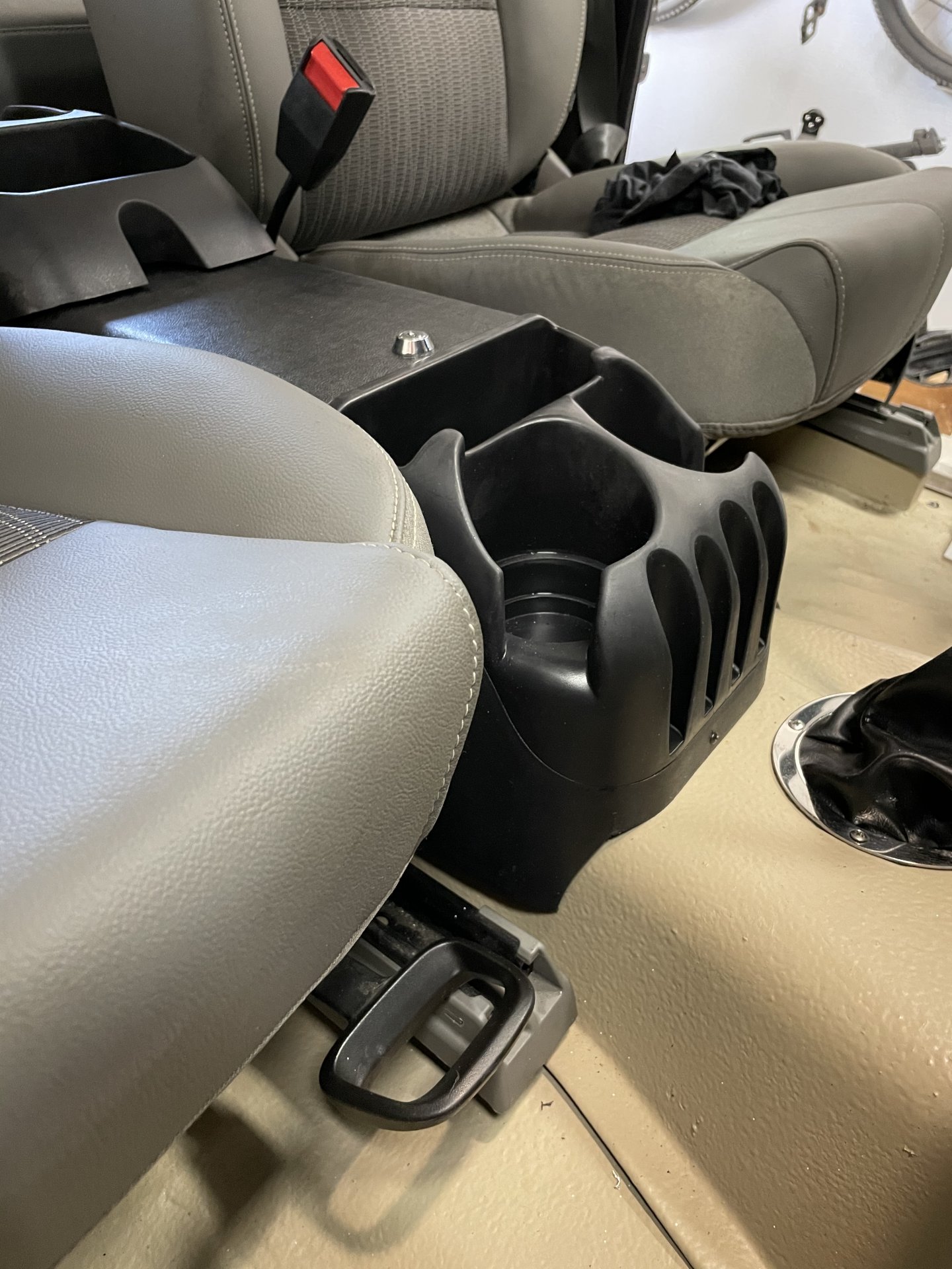

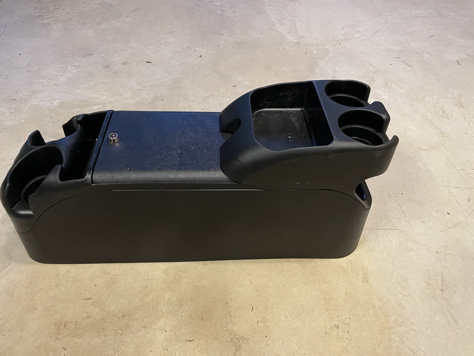

I focused today's energy solving a very important issue for my coffee getter... where to put the coffee. I ordered a console from Cruisercrap back in early March and it's still not available so I started looking around at alternatives. I ended up spending $45 on Amazon for this. It's nothing special but it gives me couple cup holders front and rear and a place to throw a cell phone. It locks but, it's also made of plastic so the lock is only a 10-second diversion.

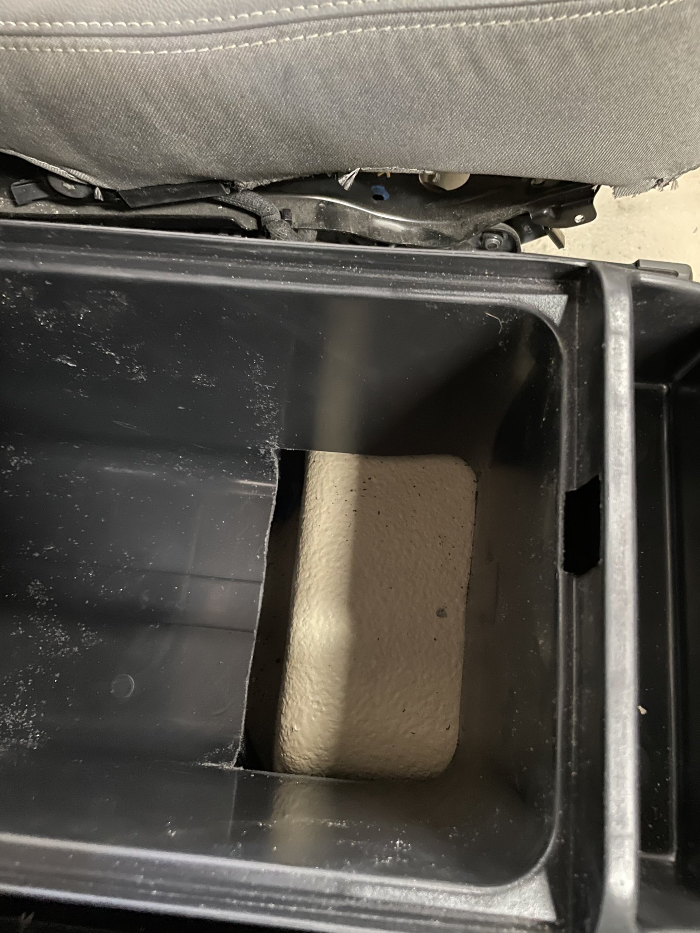

For the price, I didn't feel too bad about custom trimming it to fit better around the tunnel area. I like the outcome.
I plan on trimming a piece of Kydex and gluing it inside to make sure things don't disappear in the tunnel area void where I cut it to fit the hump.
