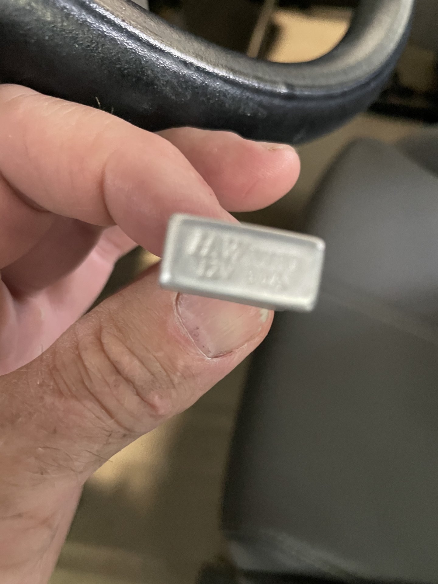

Different topic. Anyone have an idea what this circuit breaker might go to? It fell on the driver's floorboard and I cannot recall ever seeing one. According to the Ezwiring fuse panel, it doesn't go there. The Speedhut gauges don't show one in their documentation. Maybe the ClassicAir AC? If no thoughts, I'll open the dash and start looking.

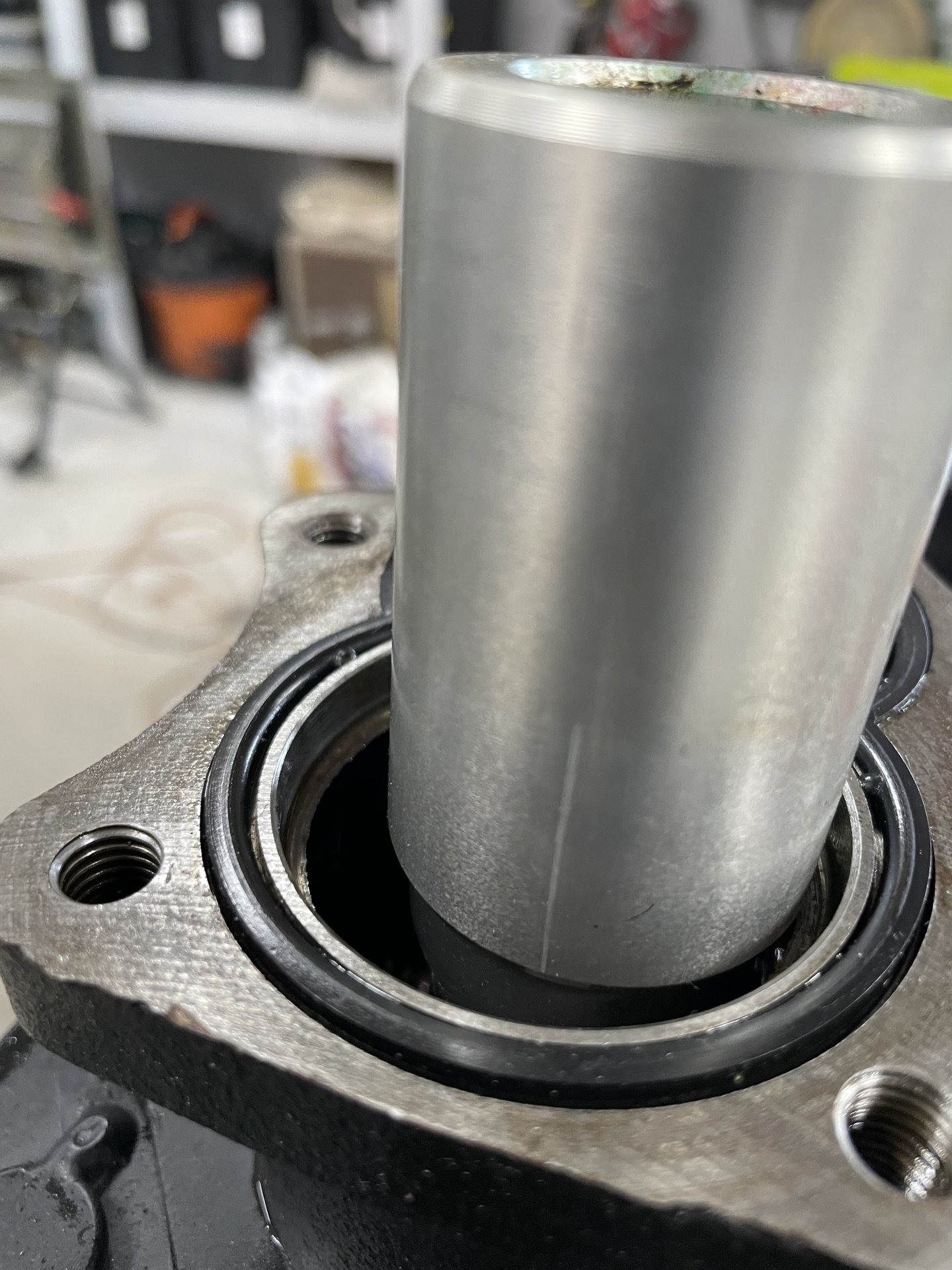

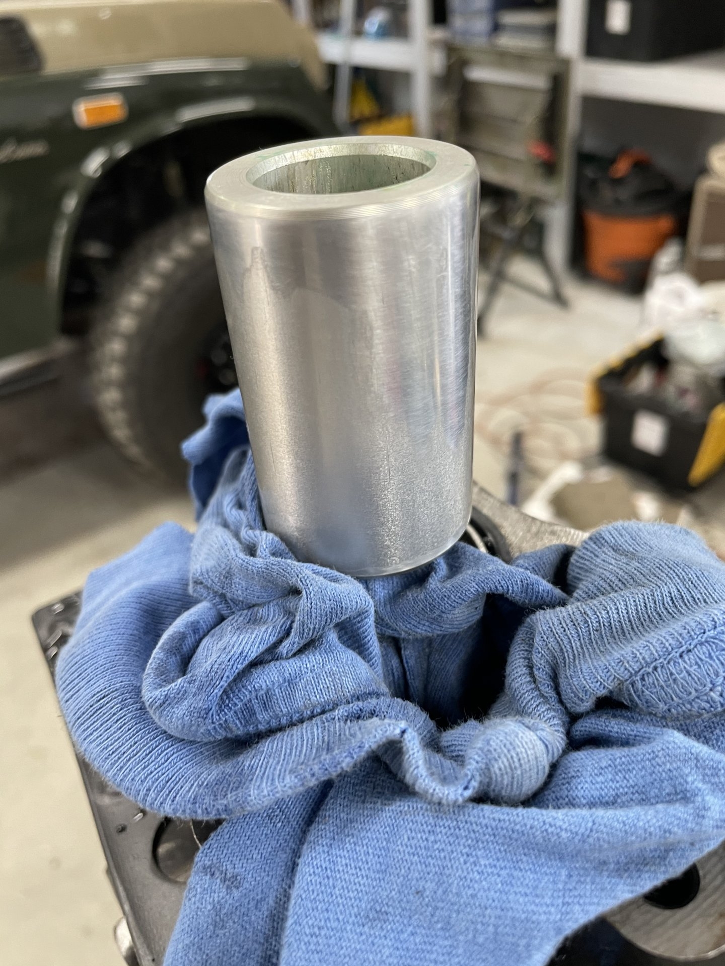

Took a closer look at my hydroboost power piston. One significant scratch. I'm not sure if I created it when I put the new seal in or if it was already there. Anyway, was able to remove it with 400 grit paper and then eventually polished it up with 1500. I found several minor scratches along the way that would catch a finger nail.
Crossing my fingers that's all it needs. Waiting for another seal vs. reusing the one I put in a few hundred miles ago.
Well maybe it's my reputation that should be on the line. I received the new seal I ordered from Boost Auto Parts. It was a much firmer material with perceived better quality than the previous one I ordered from Amazon. As I was putting it together the lip on the new seal got pinched and cut on the wall of the booster so I'm ordering another (plus a spare this time). I had the piston greased to put it together but I guess sometimes SH!T happens. With the spring pressure from the two internal springs I guess I misjudged things and cut the seal pressing the two halves together.

One thing I notice about the piston scratch in the previous picture, is it likely from the salvage car. With it so close to the piston base, it couldn't have been caused by assembly because the piston does not extend that far into the booster unit. It only extends into the cylinder wall when the pedal is pushed. At least I feel better now that I reconcile the scratch and the assembly.

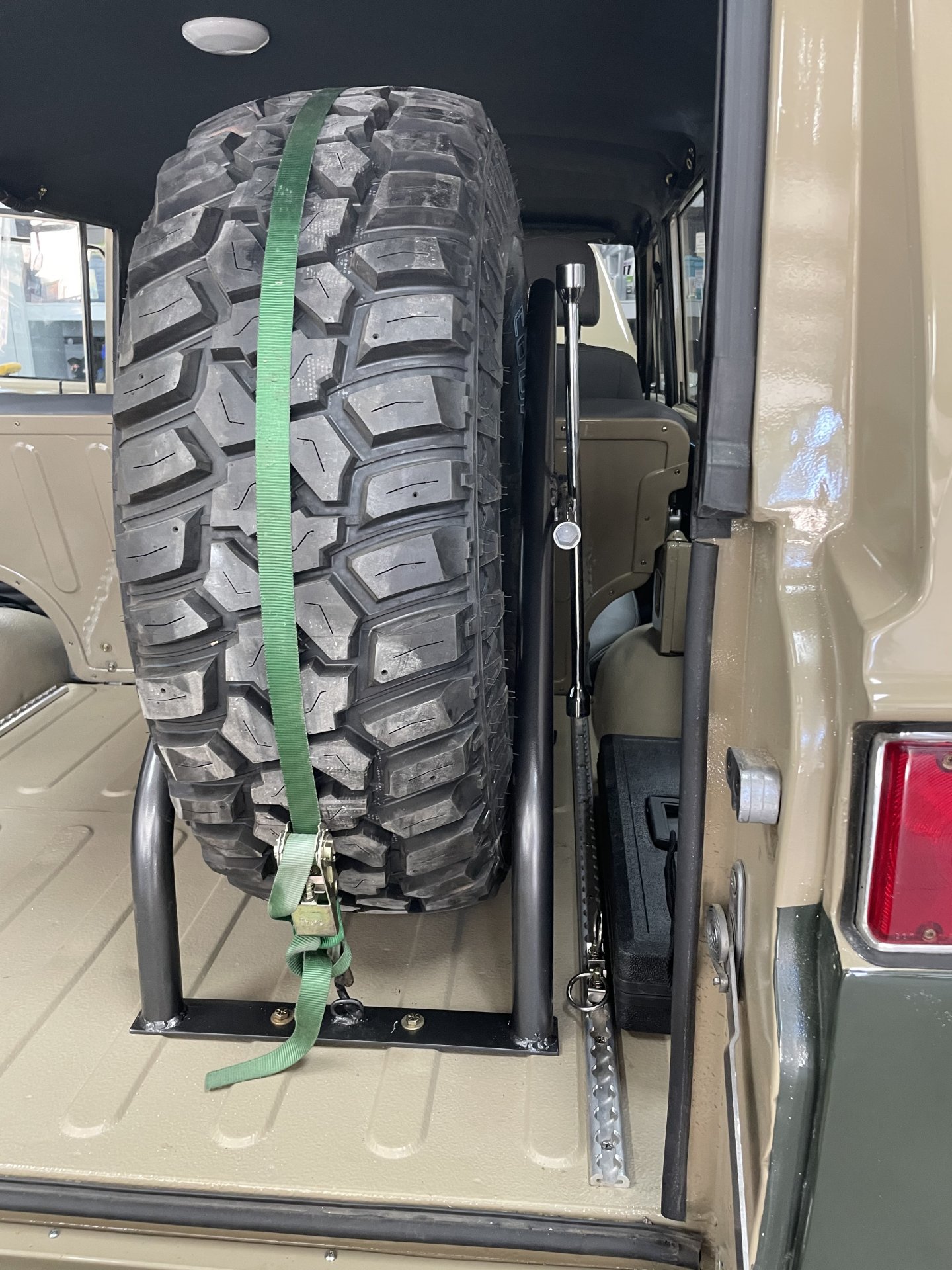

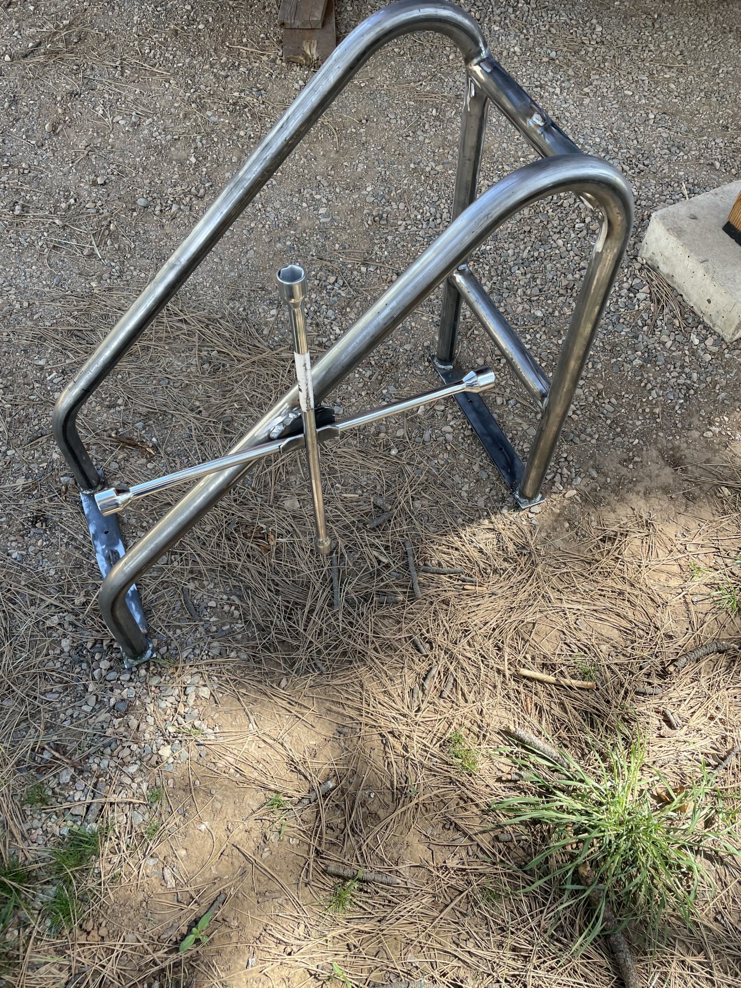

While waiting for hydroboost seals, I decided to take care of a few issues. I always had my spare strapped down in the cargo area and hated that it took up all the space. I decided to build a carrier so it could stand up. I had tubing and all the materials so it was just time in the shop.
I planNed to anchor it with rivet nuts through the floor. Boy, I was surprised that the fuel tank is really close. I think I'll be okay with 1 inch bolts. I worry a little if 4 rivet nuts will be enough to keep a 35 inch tire upright. Worst case I can fashion a bracket to also hold it from the side.
Since the picture was taken, I cut 5 inches off the legs to lower it a bit.
Reinstalled my hydroboost after sanding down the scratches in the power piston and installed a new seal. It looks like that cured my leak issues. Yeah!

The spare tire carrier is in place and I’m liking it.
