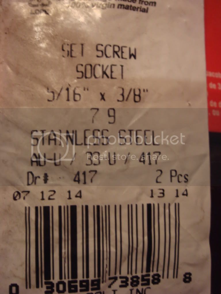

Someone asked me where I got the 5/16x24 set screws.
I bought the set screws from NAPA auto parts. Lowes and Home Depot had some, but they were 18 pitch threads.

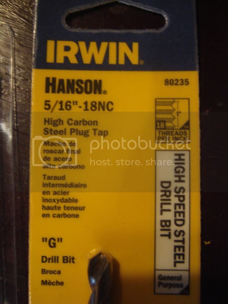

I used the 5/16" x 18 tap and used drill F.
I then used two 5/16 x 18 set screws with permanent locktite.

Glad to hear this post continues to help. I'm not sure about the F vs. G drill bit issue, the Irwin tap & drill set came with the 5/16-18 tap and G sized drill.
As for someone asking the source on the set screws, they're from Home Depot. In fact, all the hardware came from Home Depot, making this fix available to most anyone in the US.
