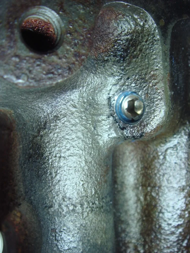

I tapped in a little further than I needed to for the two set screws. I didn't tap clean through to the head bolt hole, as I wanted the set screw to bind in the galley hole, and not be able to continue into the head bolt hole. I then cleaned out the hole, and blew out any grease with a little brake cleaner, using a straw through the head bolt hole. This will leave a nice surface for the loctite to bind into.
Look at that beautiful, threaded hole!
full
What's better? Why how 'bout the same hole with not one, but TWO set screws in it? WITH Loctite! (I didn't have any red, but blue is good, & the screws are bound into the hole & each other):
full
