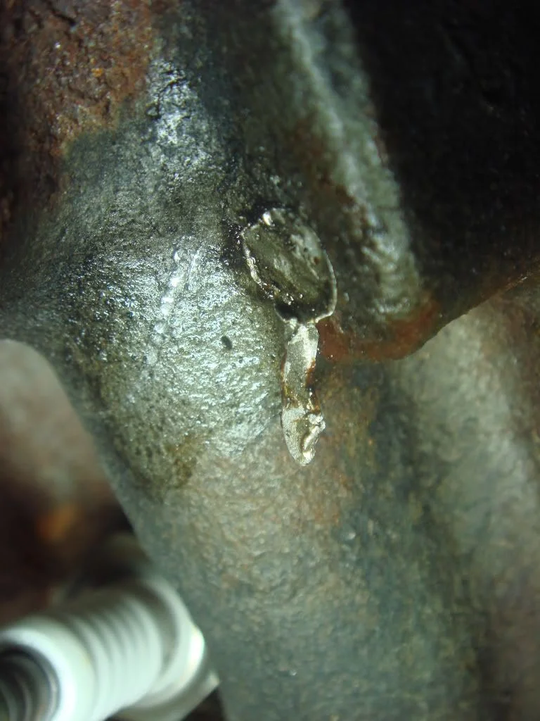

So, note the weeping oil galley plug:

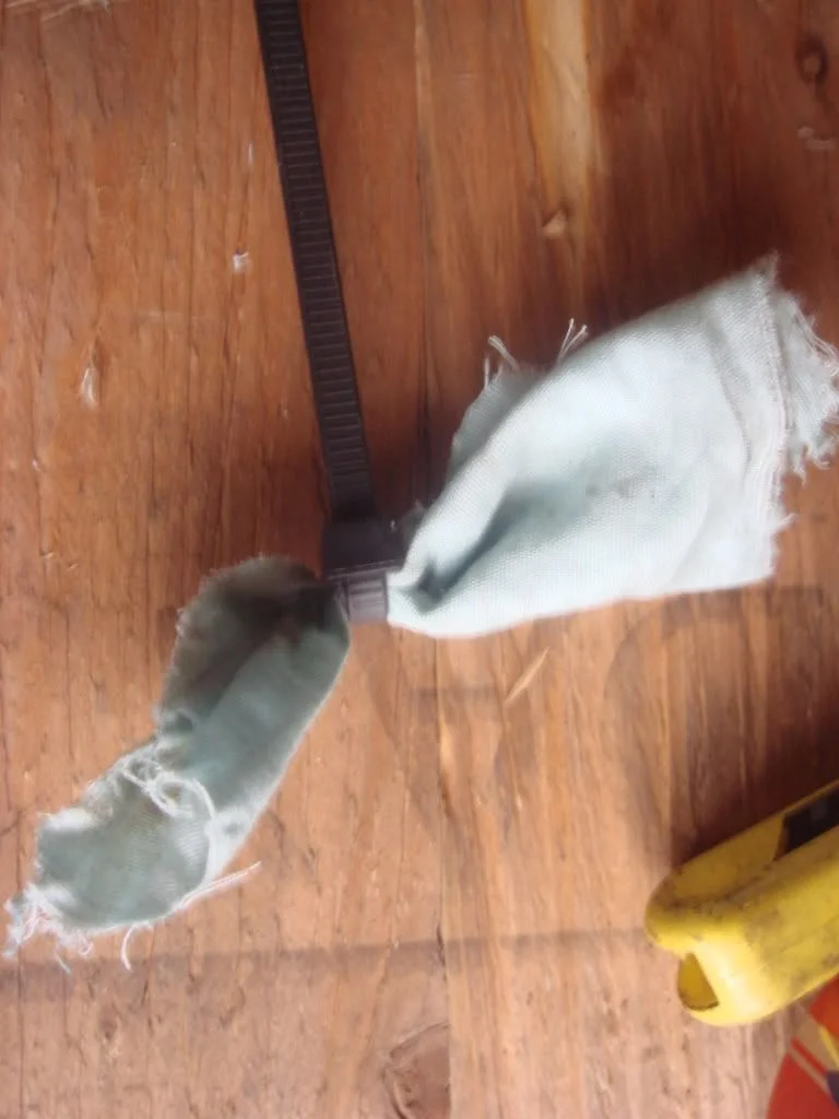

I removed the head bolt, and stuffed my custom-made crap-catcher in. It's a 2-3" square of cloth & a zip tie.
Note the installed position. I pushed the cloth into the hole until just below the oil galley hole. This will allow any crud that goes through to be pulled up and out when I'm all done.

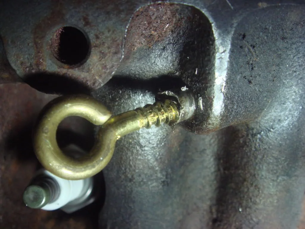

I found a random coarse-thread eye bolt in a jar of misc. bolts. I threaded it in until the galley plug started rotating and popped out:

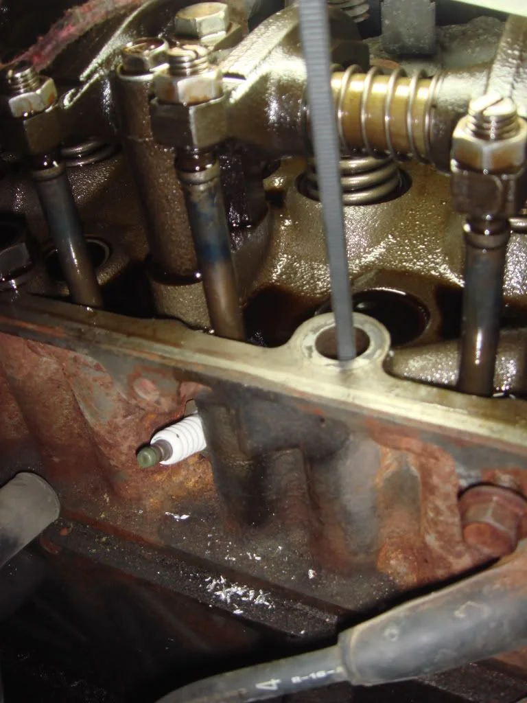

Here's the old plug in place with valve cover and head bolt removed.
Looking down on the head bolt hole where the plug is.
Heater hoses removed and slowly tapping the hole with paper towel stuffed in the head bolt hole.
