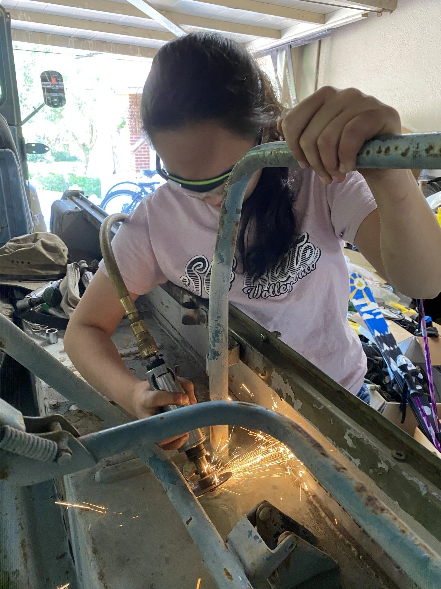

Like with so many other things on this rig, I turned out to be wrong. The uppers/backs of the jump seats were about an inch too high to clear the shelving. “No worries,” I figured. The seats themselves have long since disintegrated due to exposure and repairing or replacing is on the One of These Days list. It’s just four bolts each to remove the backs for now. I took it very carefully, with LOTS of PB Blaster, a wire brush on exposed threads and some very gentle persuasion, lest I break a bolt and have a new project on my hands! Success in that avenue, however, led to the final discovery about my not-quite-stock seats: the forward supports on each seat were also welded to the wheel well. Which brought me to this:
After we did the first one, she wanted to try and I wanted her to have the experience. She did a great job grinding out the weld and we were able to remove both seat backs and get the truck into the garage!

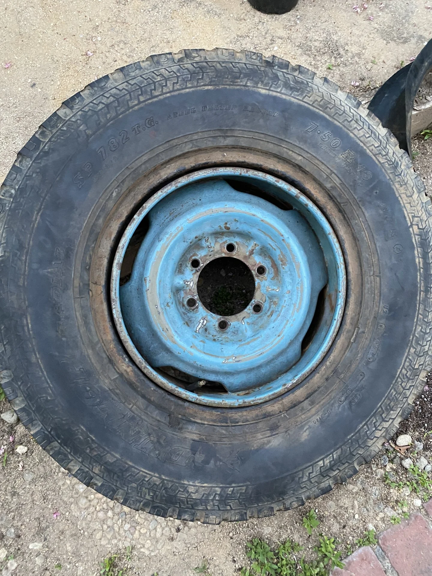

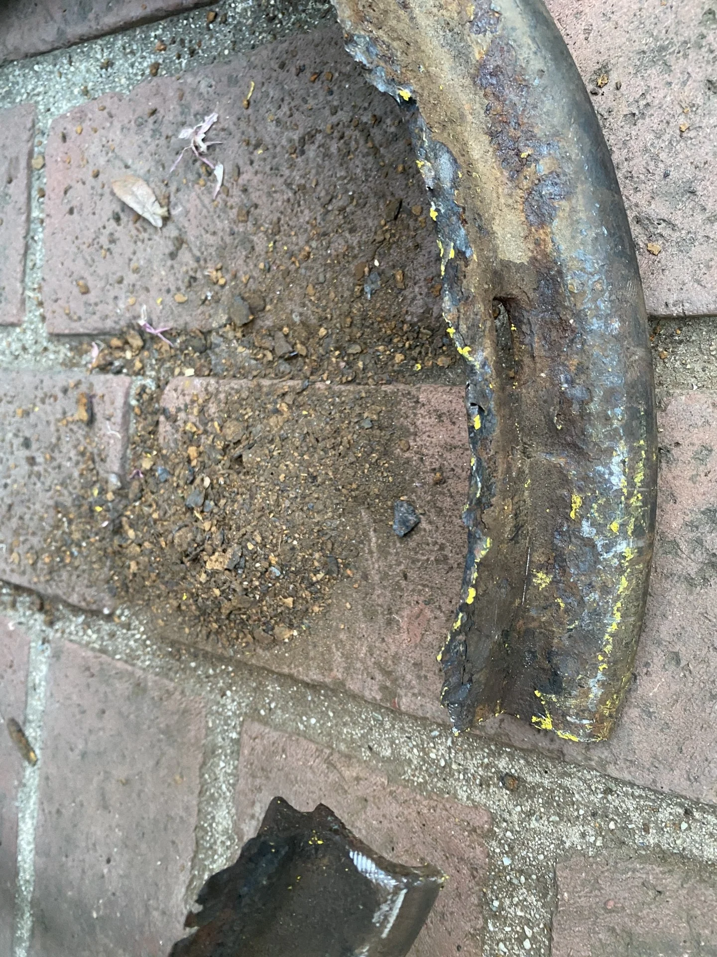

Not going to lie, I’m having second thoughts about keeping my split rims. I thought breaking the ring off was going to be the big headache, but I was able to accomplish that with the help of some crow bars and my son. What I found when we broke it free was not pretty:
But what really has me licked so far is that I haven’t been able to get the tire off of the wheel!
I’m not admitting defeat just yet, and I’m hoping that this is in the worst shape because it’s the spare and has a tire that’s been on it since before I owned the truck seventeen years ago. The fact that it’s a Dunlop makes me wonder if it might even be original 1983, but I didn’t look closely for any markings on it while I beat my head against it today.

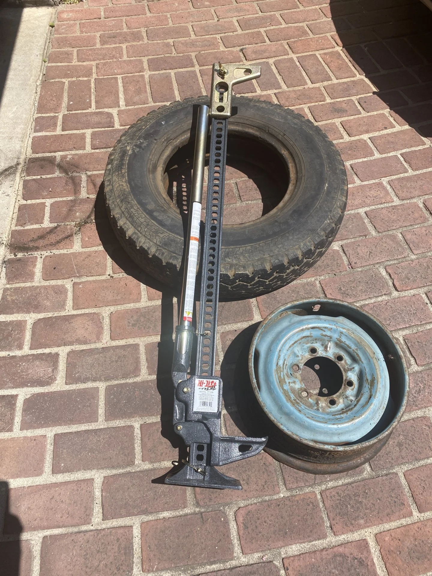

Jumping on it, it felt like the bead still needed to be broken, so that makes sense. I’m going to see if I can find a cinder block to put under the rim, so I can jump on the tire instead of the rim.
Have access to a tractor with front loader bucket? That’s me bead buster, and I’ve done variations on this as well

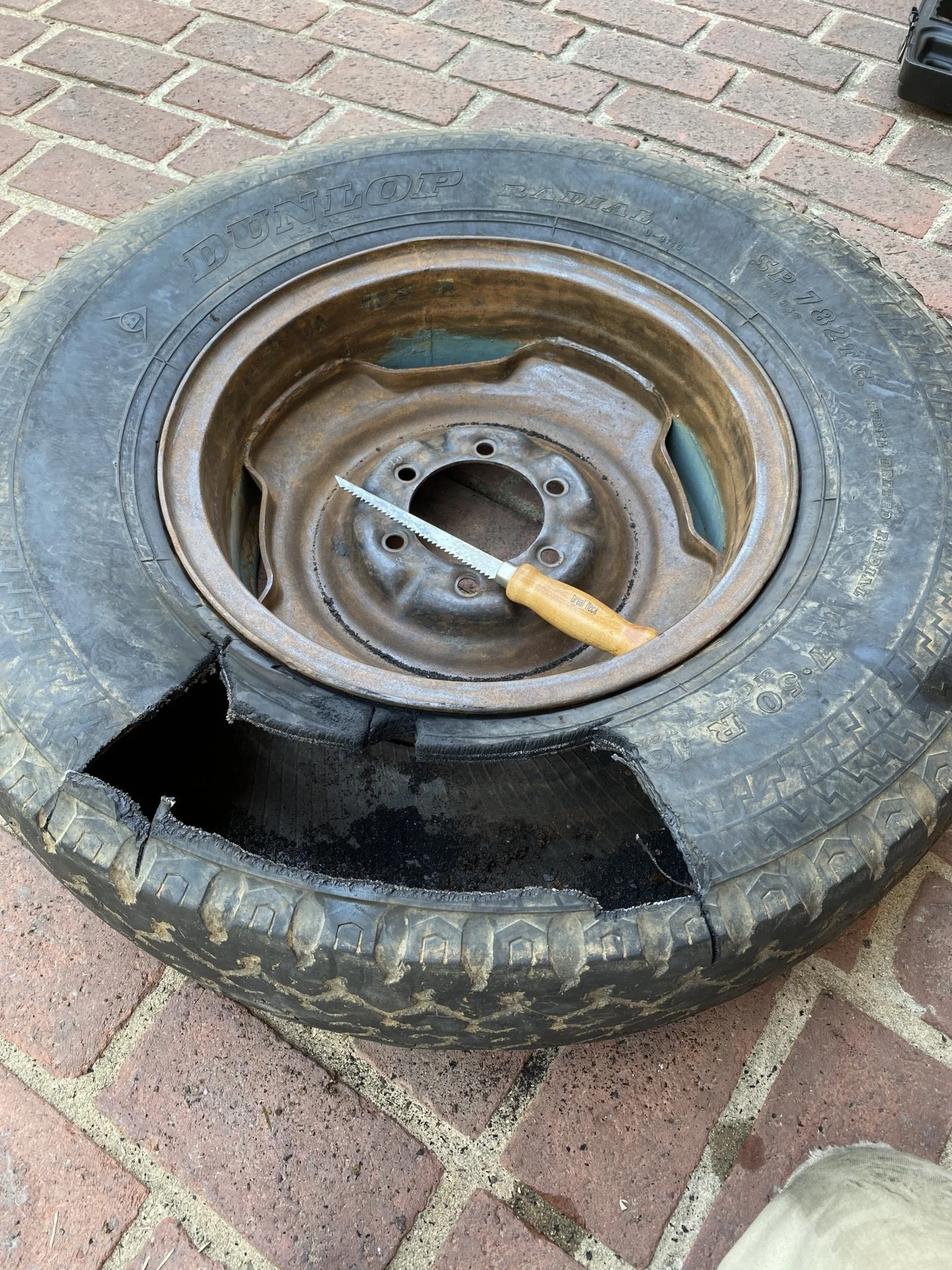

last resort is to cut the tire off

Been around splits for years now. The spares are usually the hardest to do. The inside bead needs to be broken. Luckily I have a tire machine and have had to use it to break the inner bead on occasion. Once new tirea are on, I can change one out in 10 minutes!! Don’t give up!!

Spray wd40 or some sort of penetrating oil in between the rim edge & the lip of the tire. Let it soak a while, then drive over the tire itself, as close as you can to the rim. It should pop the bead off, then no need to cut. Also get yourself some tyrepliers if you are going to keep the splits. A million times easier, assuming you aren’t going to go all in on it tire machines & such.
