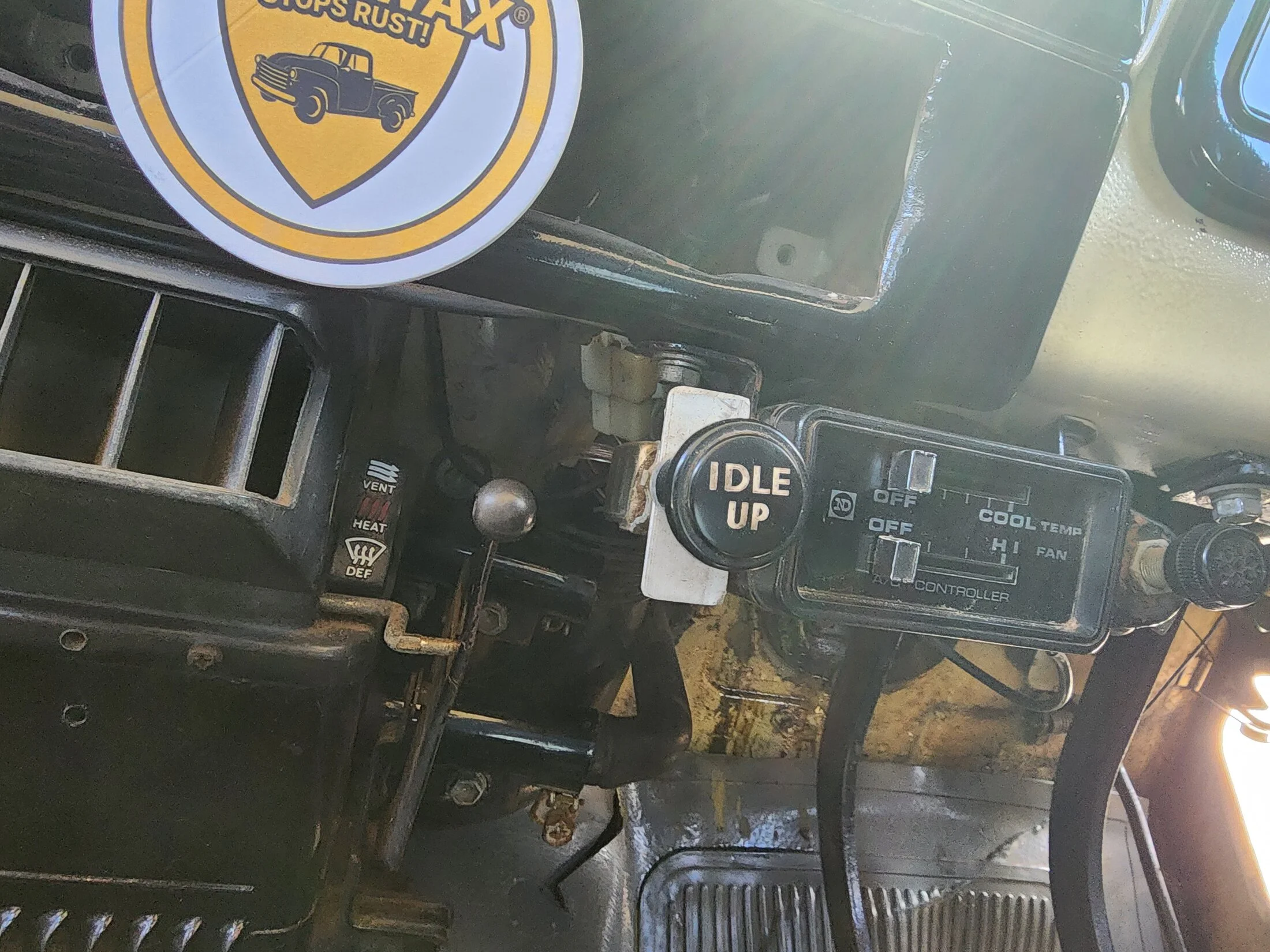

I found myself in a fj45 , rhd . 1982 but it has an HZ in it
I had shared some details in my earlier posts. This post is more specific to the AC unit it has.
It appears to be a factory unit with a factory controller.

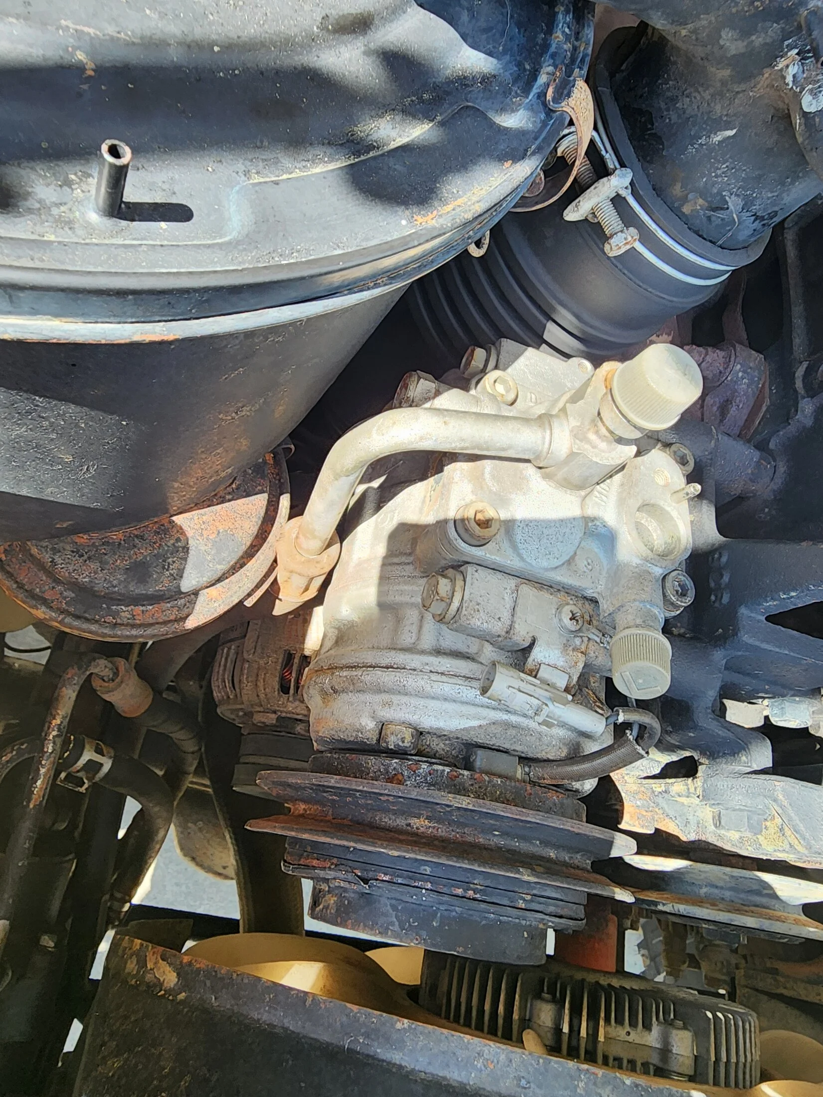

I don't have a belt for the compressor but suspect the pump to be bad as it won't turn with any decent ugga on it .
I want to try to get a new compressor and get some lines made or purchased.
It has stamped MD21 on it but that doesn't seem to pull up anything resembling my compressor layout
The search function has produced an amazing amount of information but I dont see anything that gives me an aha moment of solid confidence that I am looking at the right stuff.
Should I even try to fix this compressor and run the unit or look at some other kind?

What is that under the air cleaner that’s cutting into the high pressure side hose crimp? Where is the compressor low side line?
Thanks for looking , low side is missing and I suspect I will need to replace a lot of them .

I’d have very low expectations for that compressor, it appears to have been open to the atmosphere for some time. The clutch unit doesn’t have an “air gap” as it should when not activated/turned on.
w
Thank you. it is infact locked up
I found a local shop to make the lines , he doesn't have the adaptor or manifold needed for the compressor ends.
Is there an appropriate compressor. one on the truck has MD21 in the case . that brought up compressors but not any in a fj45. Lol.

Which compressor
What adaptor do I need ?
It looks like a Nippon Denso. I bought mine from Rock Auto to fit my 12HT. Find out what LC came with the HZ motor and go from there.

I found a 471-1141 referenced somewhere on here and I was able to get one shipped
I also read that using a 3fe fj62 for vehicle will give correct drop in replacement.
