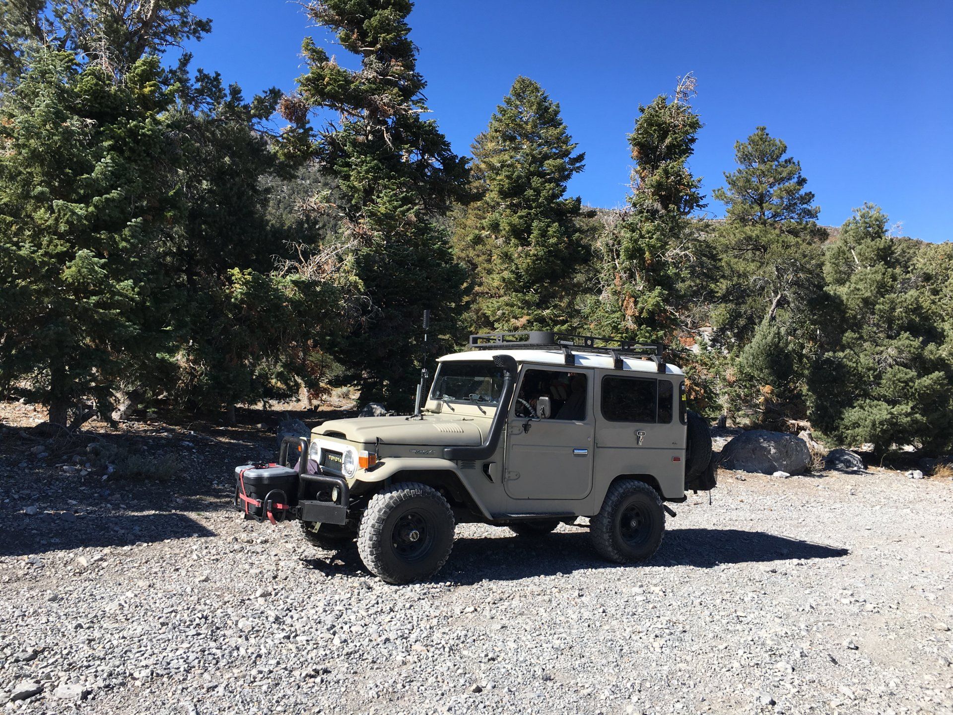

Chester and I drove up above Cold Creek this morning, with the
Intent to spend a few days driving new (to us) areas.
44 drove performed flawlessly (20" of vacuum) easily maintained 70 mph, with both tanks full... until we reached 6k' and a steep incline... then, 44 bogged down significantly.
I wasn't real concerned because I knew we would be at the end of the road before long anyway and would start back downhill.
Question: what's the best approach to take to make 44 perform equally as well at 7500' and 2400'? Is that possible? Or, will I need to adjust the timing every few feet of ascent/descent? :rofl:
Anyway, we climbed to the Bonanza Trailhead at 7500' and snapped a few pics and headed back down... again, 44 performed flawlessly... of course, downhill is easy. :love:
Then we entered the Refuge, with the intent of driving the 47 miles to US93, to head up to Sunnyside. But, 10 miles into the Refuge, the fuel gauge quit reporting the aux tank... I haven't looked into this yet... either the sender has failed or the float is stuck or has fallen off the sender.
