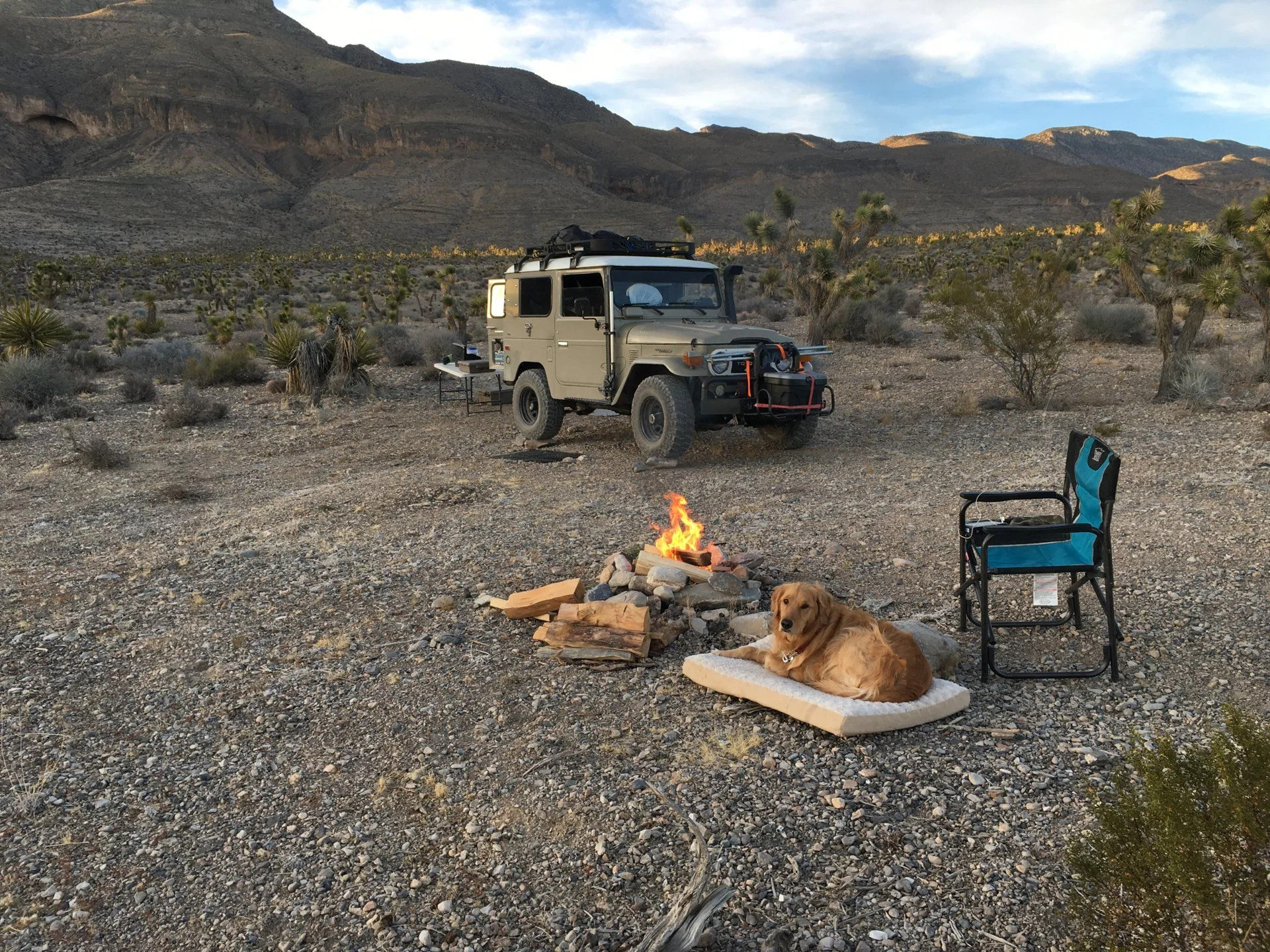

Interesting pictures. It is real nice not to see mud (the real thing, not the forum) as there is a lot of it around here at the moment. In post 2437 you mention it was chilly. What was the temp? In some of the other pics it looks warm, but in the pic of the campfire it is easy to tell that it is getting late, and I know the desert is supposed to cool off at night. It has been getting cooler here lately, sometimes very close to freezing at night and in the upper 40"s and low 50"s in the day, and very wet.
In most of the pics there are "trees", and in the pic of Chester laying in front of one I am able to get a perspective on size. Are they all similar in size? I'm assuming those are Joshua trees, but I've never seen one in real life, only pics, so I don't have any mental pics to go off of. The pic of the campfire and 44 just doesn't give me a good perspective. The tree to the right of 44 might be taller than 44, and then again might not be.

Yep, the "trees" are Joshua Trees and, like all trees, they start small and grow ;). The one behind Chester was about 6' tall... The one to the right of 44 was about the same size as 44.
