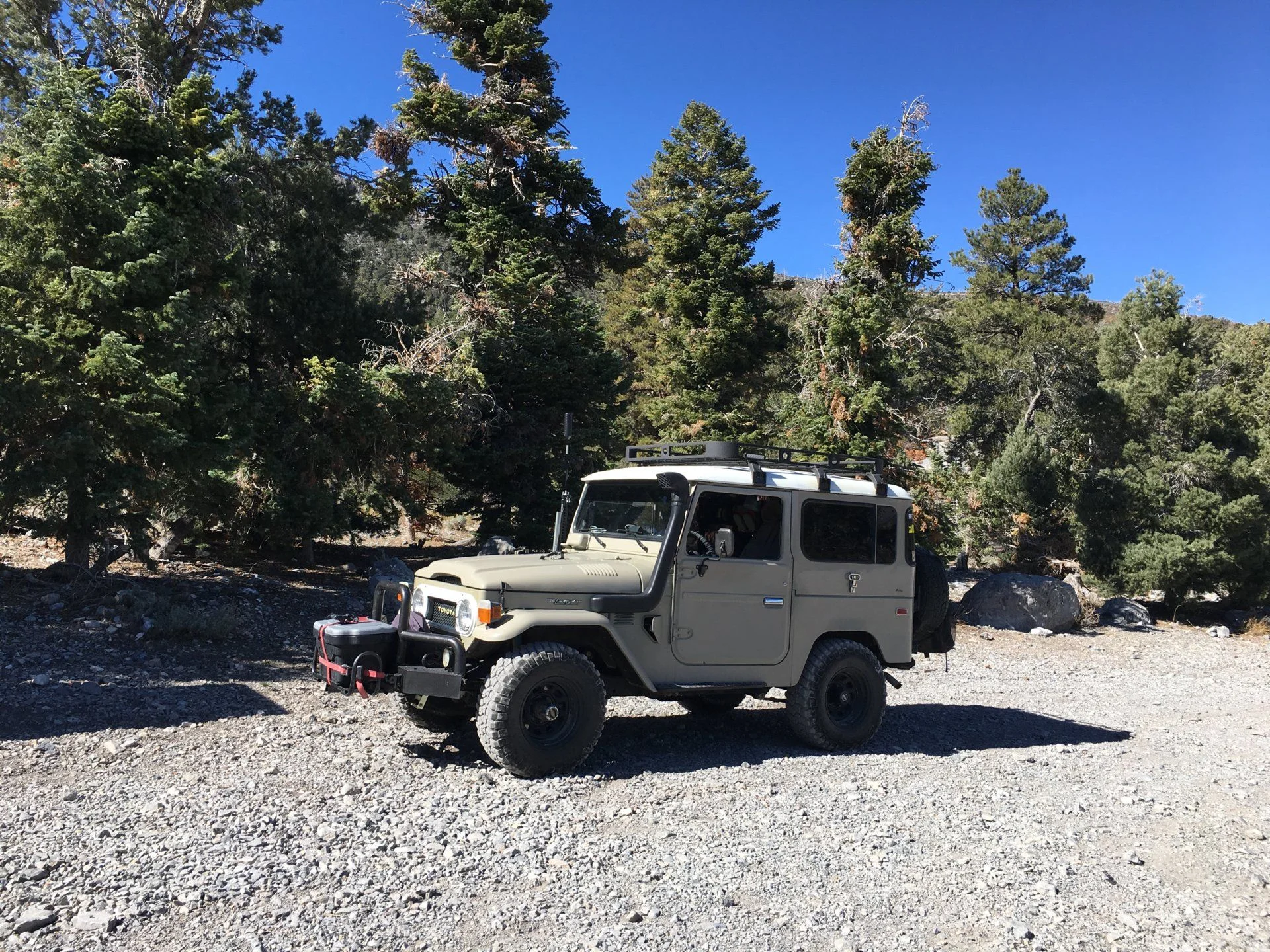

44 drove performed flawlessly (20" of vacuum) easily maintained 70 mph, with both tanks full... until we reached 6k' and a steep incline... then, 44 bogged down significantly.
I wasn't real concerned because I knew we would be at the end of the road before long anyway and would start back downhill.
Question: what's the best approach to take to make 44 perform equally as well at 7500' and 2400'? Is that possible? Or, will I need to adjust the timing every few feet of ascent/descent? :rofl:
Anyway, we climbed to the Bonanza Trailhead at 7500' and snapped a few pics and headed back down... again, 44 performed flawlessly... of course, downhill is easy. :love:

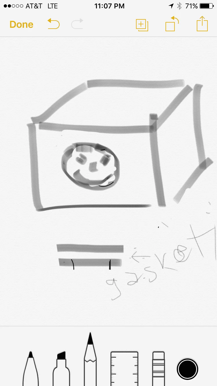

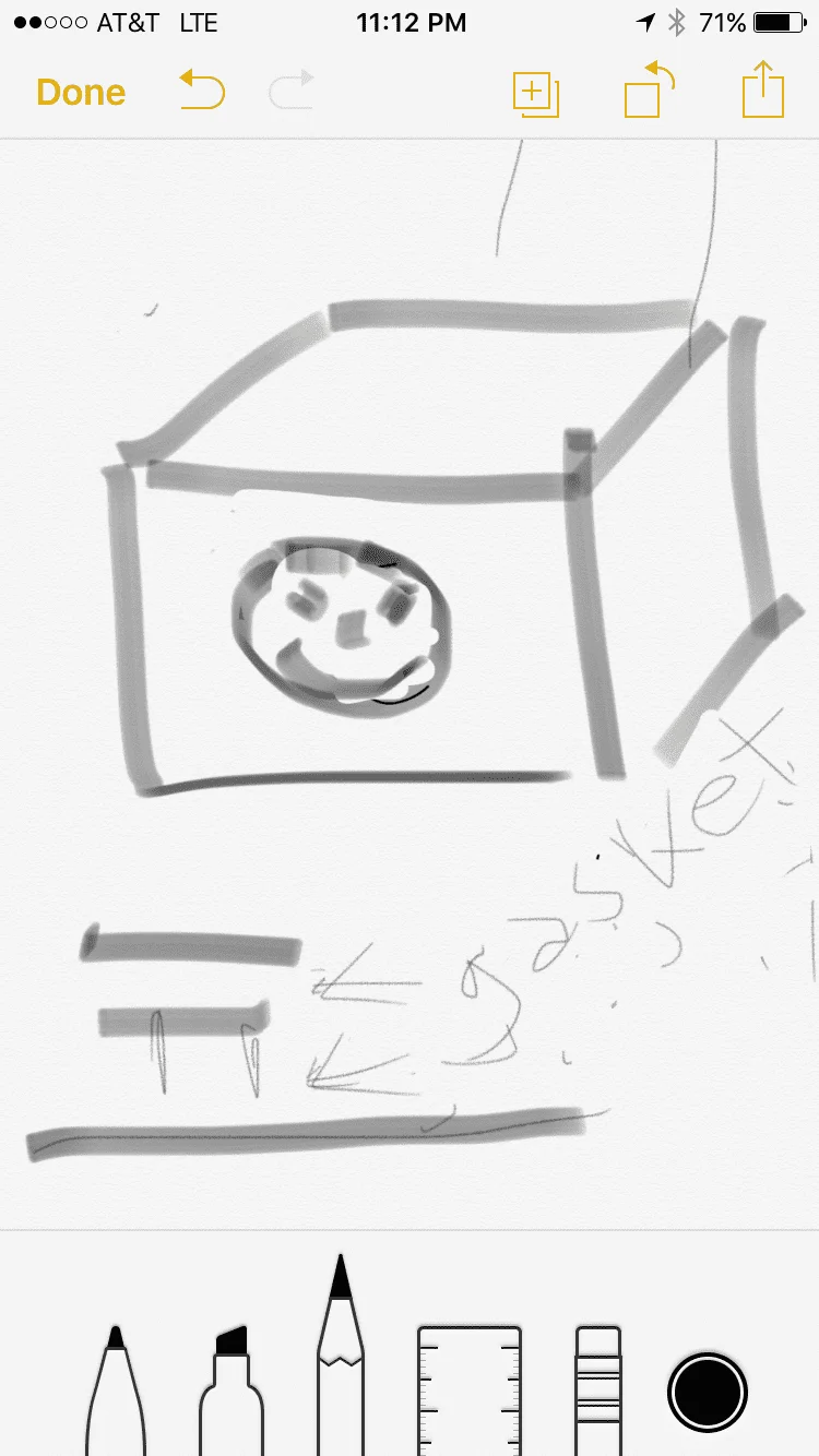

This is intriguing, Michael... but, every time I think I understand it, I lose my mind...
1. How big is this ring, to only require 2 screws?
2. What sort of sealer between the ring and the tank? Or, do I use a gasket, as shown below?
