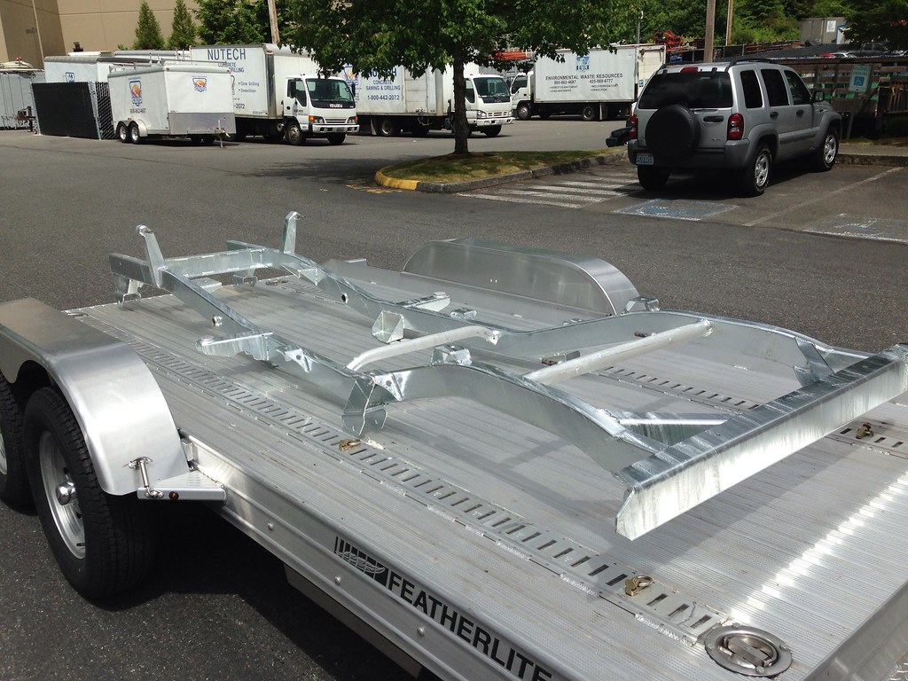

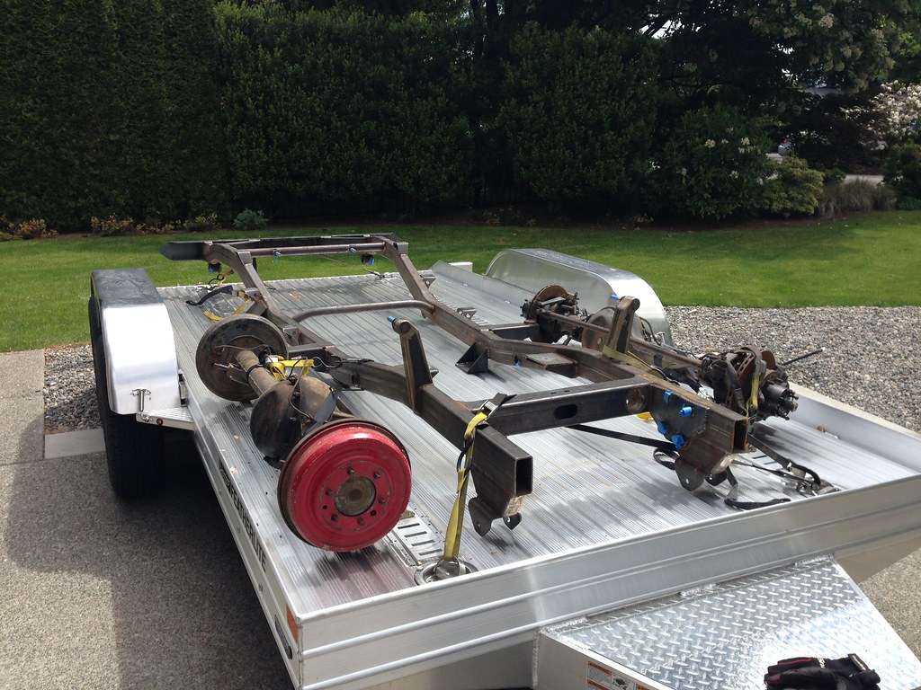

Subscribed! How hard was it to find the crate diesel? Looks like you did a shackle reversal with spacers between the frame and leaf spring hangers? Can you give us a little more info on this? Looks like it will be awesome!
Took the frame in for galvanizing, axles to get rebuilt and ARB stuff thrown in. Just waiting for the phone call to pick it all up.

Aqualu made my frame based on my tire size and shackle reversal request. I needed to get as much clearance as possible with the front diff and the engine block (tight with the B3.3)

Picked up the frame from Ace Galvanizing in Seattle. Drove it straight to Powder Vision for powder coating. Thanks for the tip boys.
