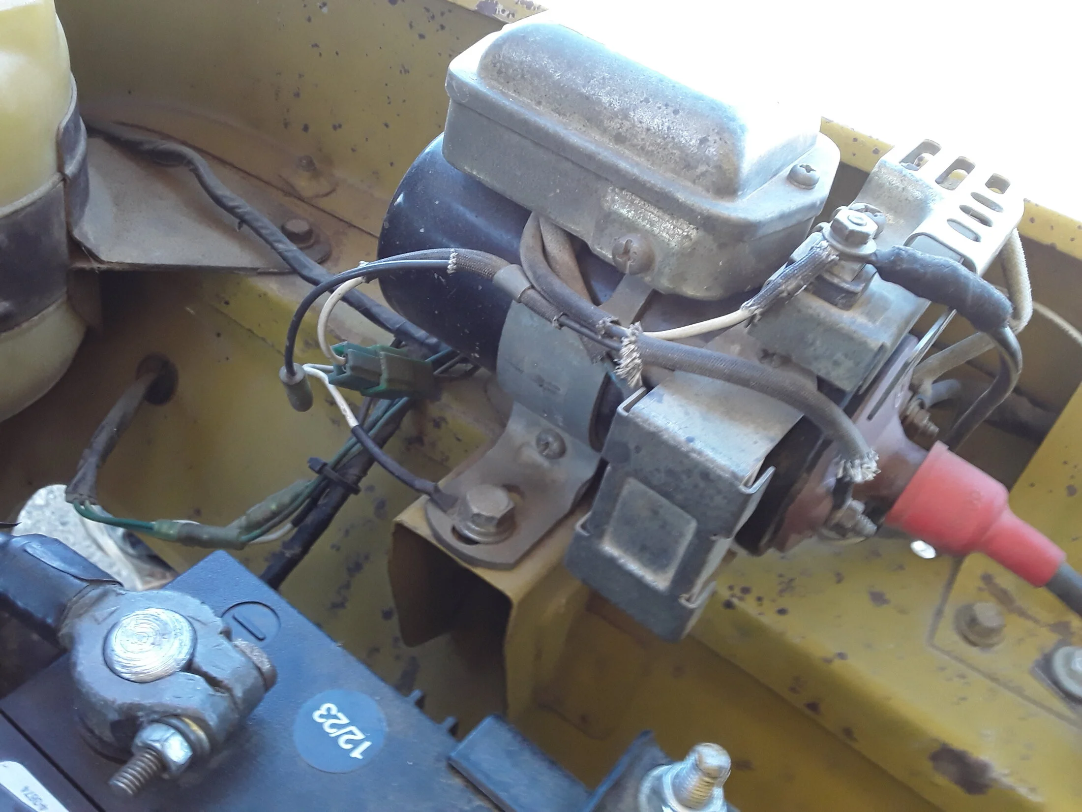

My igniter set-up includes a resistor for the coil (top), and a resistor for the igniter (inboard side of coil). Plus, the heat shields on both of the resistors. I'm not sure if this is correct for my year / build date.
The Haynes Manual explains how to re-wire it so the coil can run on the distributor's points-set without the igniter. The negative coil terminal (low voltage) leads to the points-set, and the points run to the capacitor, before engine ground. You'll typically install a capacitor on the distributor breaker-plate, or on the outside of the casting. These capacitors are readily available. You'll want to service the points, more often, if you don't run the igniter with the coil.
