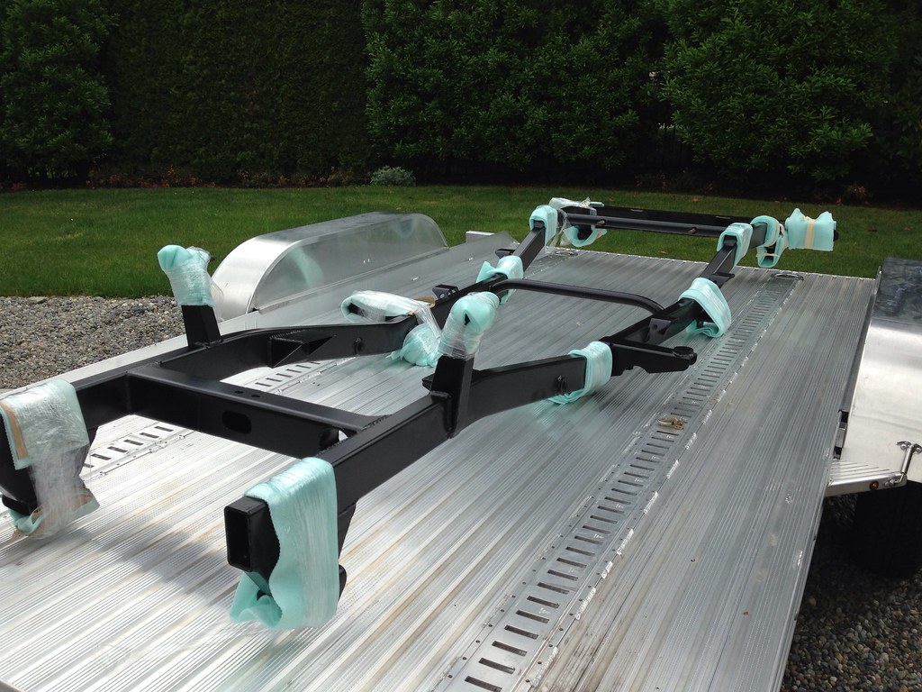

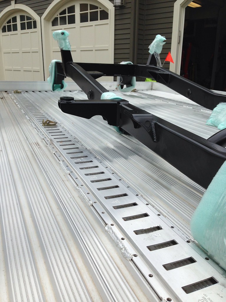

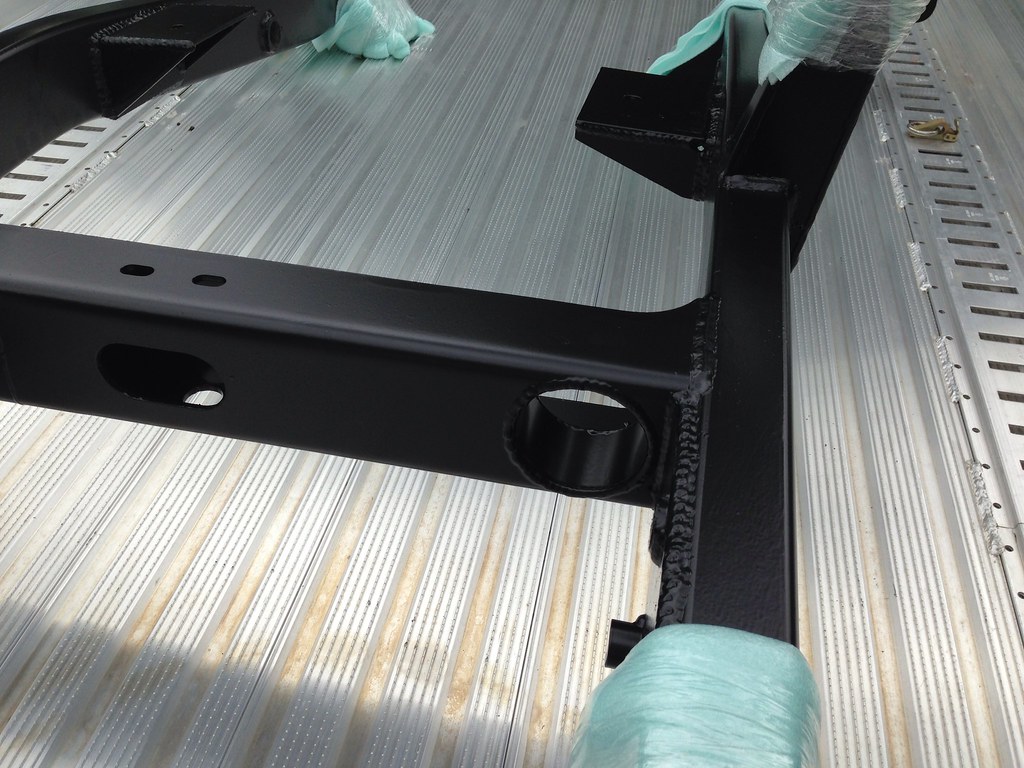

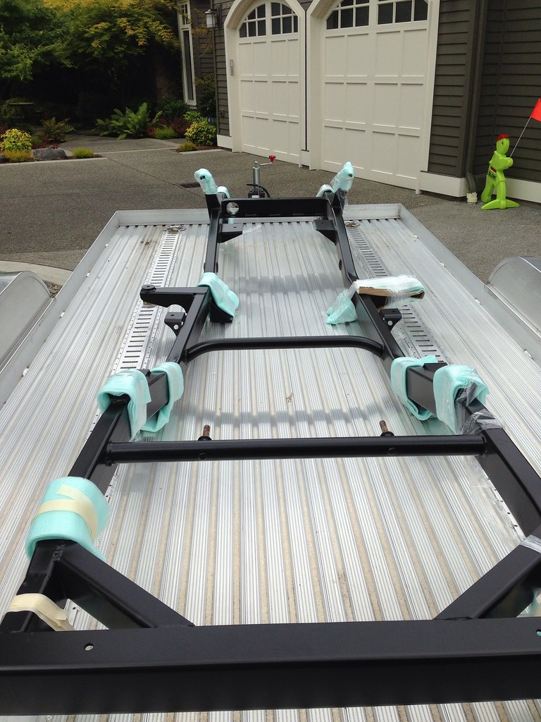

Back from powder coat
Doesn't compliment the trailer as nicely as it did when sporting the galv but it will look a whole lot better under the rig.
Took the frame in for galvanizing, axles to get rebuilt and ARB stuff thrown in. Just waiting for the phone call to pick it all up.

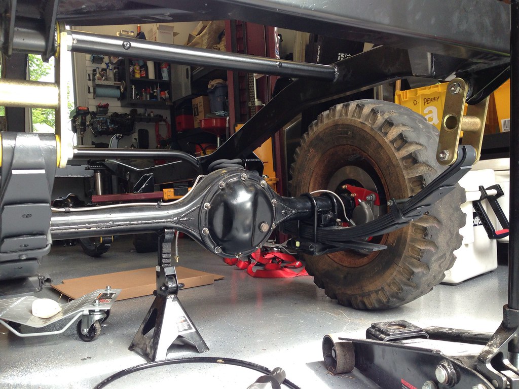

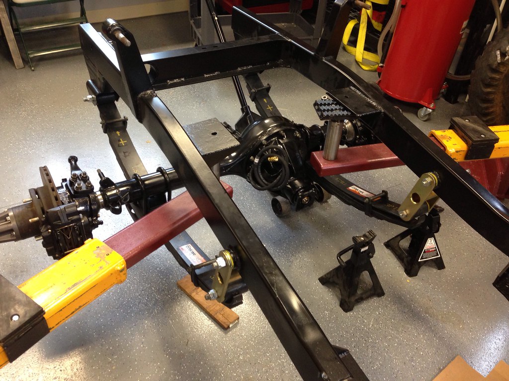

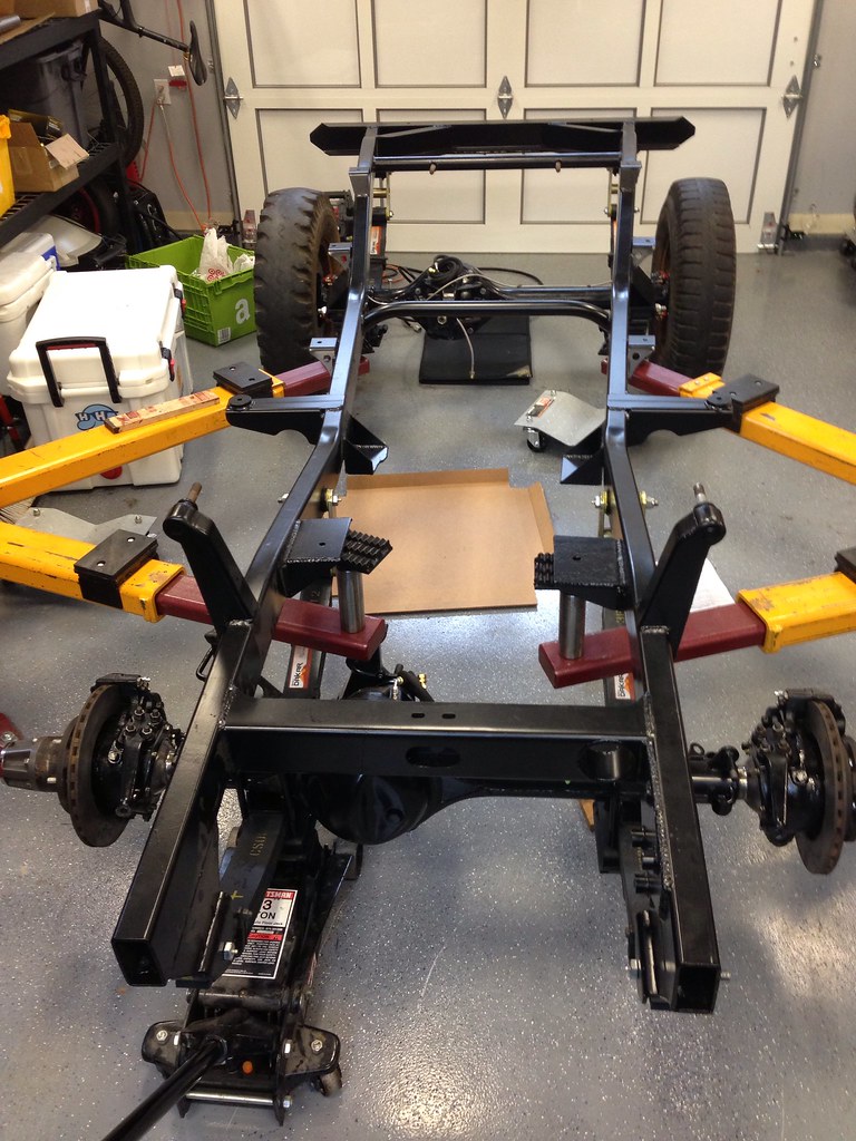

Work has gotten in the way of my build, but I finally found some time today to strap on the axles.
Fronts
Rears going on
Overhead

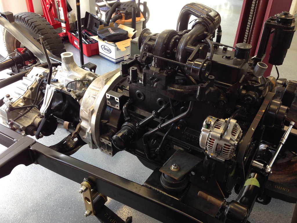

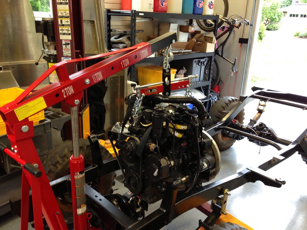

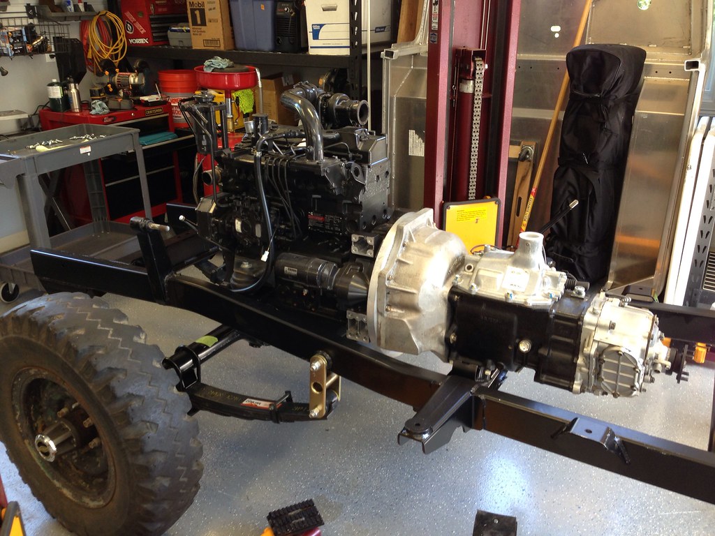

put the clutch together and mounted the engine and tranny
Bitch trying to get all the right bolts and bearings to make it all fit.
Looks great! What are you doing for brake lines?
No idea! I am basically tackling each task as it comes along, haven't gotten there yet. Any recommendations on a kit and/or bender for the hard lines?
Tackling the steering (saginaw) next.
Very nice project. I love your garage too!
