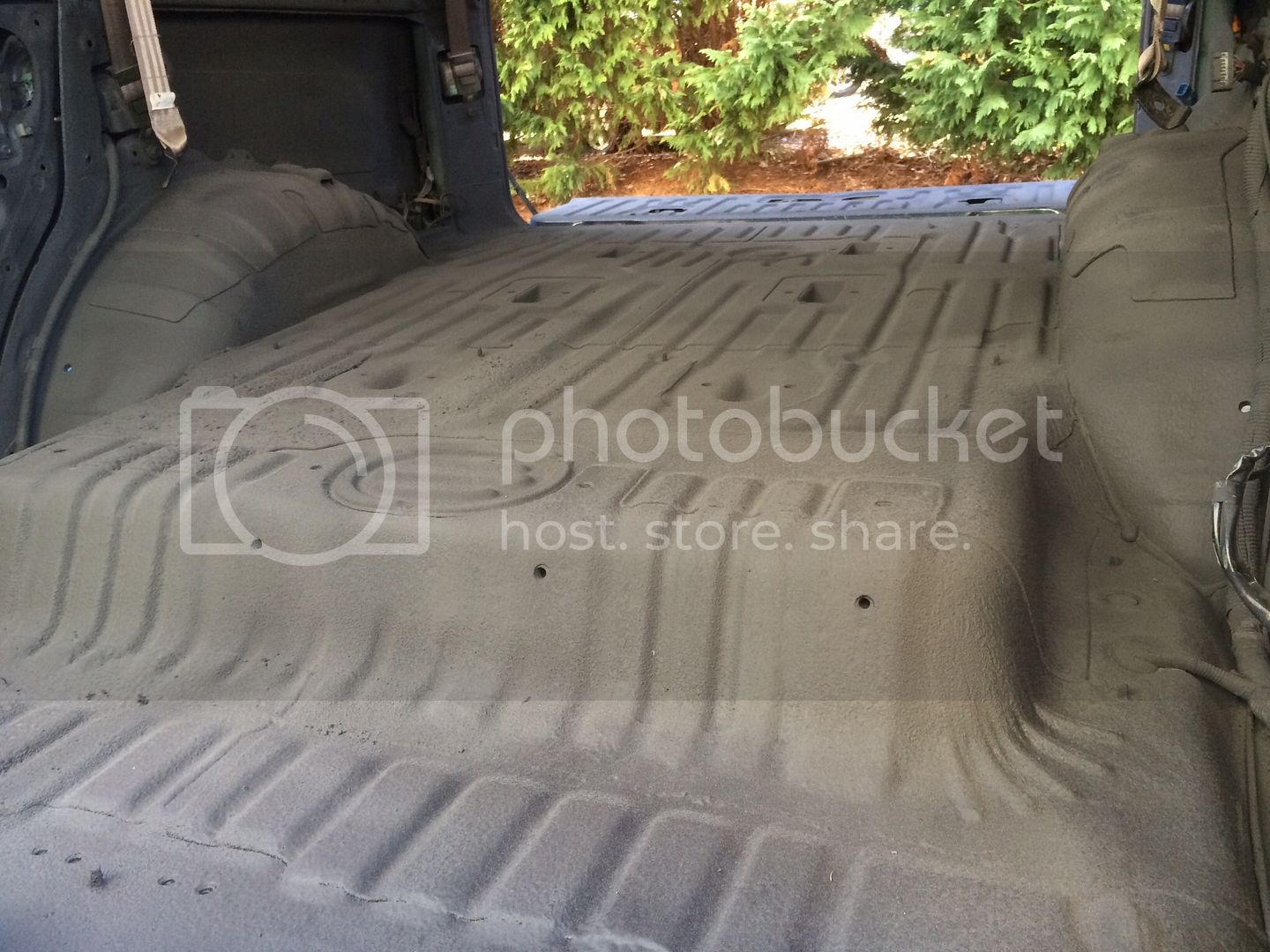

FINALLY had the time and temps to get the Lizardskin applied. I'm just using the "CI", their ceramic insulation, couldn't justify spending more would make much real difference acoustics for my use.
After applying the 4 gal to the inside of the 80, I can't imagine doing this with adhesive tiles, the variations in the floor/bed would be a nightmare to get into the spaces. I wound up putting 3 coats on, first one light as directed, 2nd heavier then a 3rd a couple days later. Due to my usual luck, my 2nd coat was interupted by a line of thunderstorms that came so hard and fast, I couldn't get the doors closed up before getting wet. Fortunately, I had enough to apply a 3rd coat to help repair the areas that got wet.
For me, spraying wasn't a problem but I have a decent setup to do so. It sprayed on easy, no problem with coverage and seeing how thick it is being applied. This is what they callled black. I will use it again for sure, now to the pics...

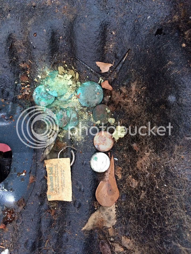

Before, including the reward under the rear heater box...

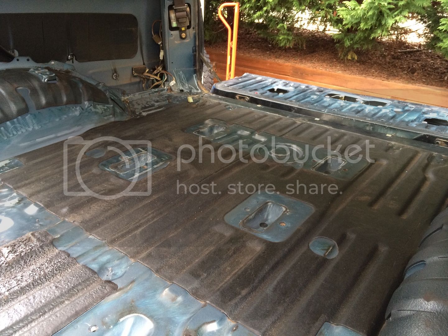

After...
8 gallons????
D A M N
The instructions from Lizardskin say to apply the SC (sound control) before the CL that I applied.
What I like is that its a "sealed" surface now. I'll go through the holes and posts with a tap & die to clean up any threads.
I did take the time to scuff the surfaces (but for inside the doors and panels) and wiped it down with acetone. All that does add up to more prep time than one might do with the mat type stuff. I had to keep reminding myself that this is the floor that carpet goes over, I'm a bit obsessive sometimes...

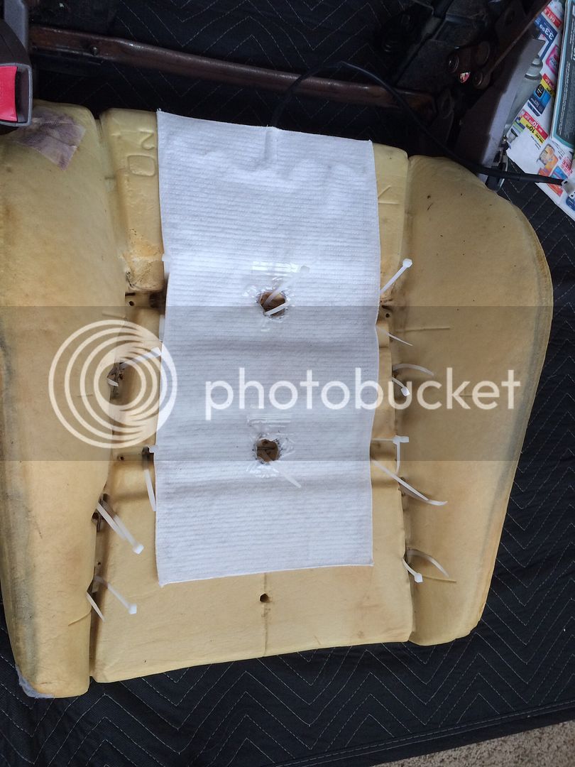

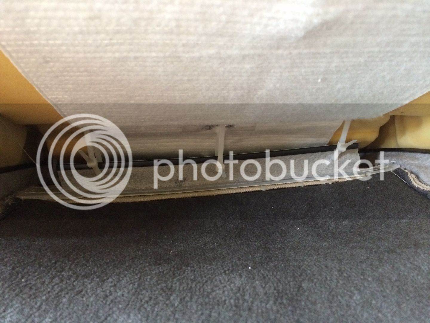

Working on the new leather from Shane gives me a new perspective and respect for those who work in the auto upholstery industry. I had some issues using the hog ring/pliers and getting things tight. Going through the instructions for the heated seat inserts, they recommend using a zip-tie in the center section, under the heating element. This made me think...
After careful inspection of the removed hog rings, I opted to go against professional advise and used zip-ties instead of the hog rings. I could find no appreciable wear on the removed hog rings, considering they appeared to be copper, been installed/used for 17 years, I felt comfortable doing this. I'm being a bit of a guinea pig, if they fail, I'll get to do it all again. I was able to pull them tight as I moved along, pushing the "head" into the foam after trimming the excess. Saved me so much frustration, time also but the frustration was the biggest benefit to me.

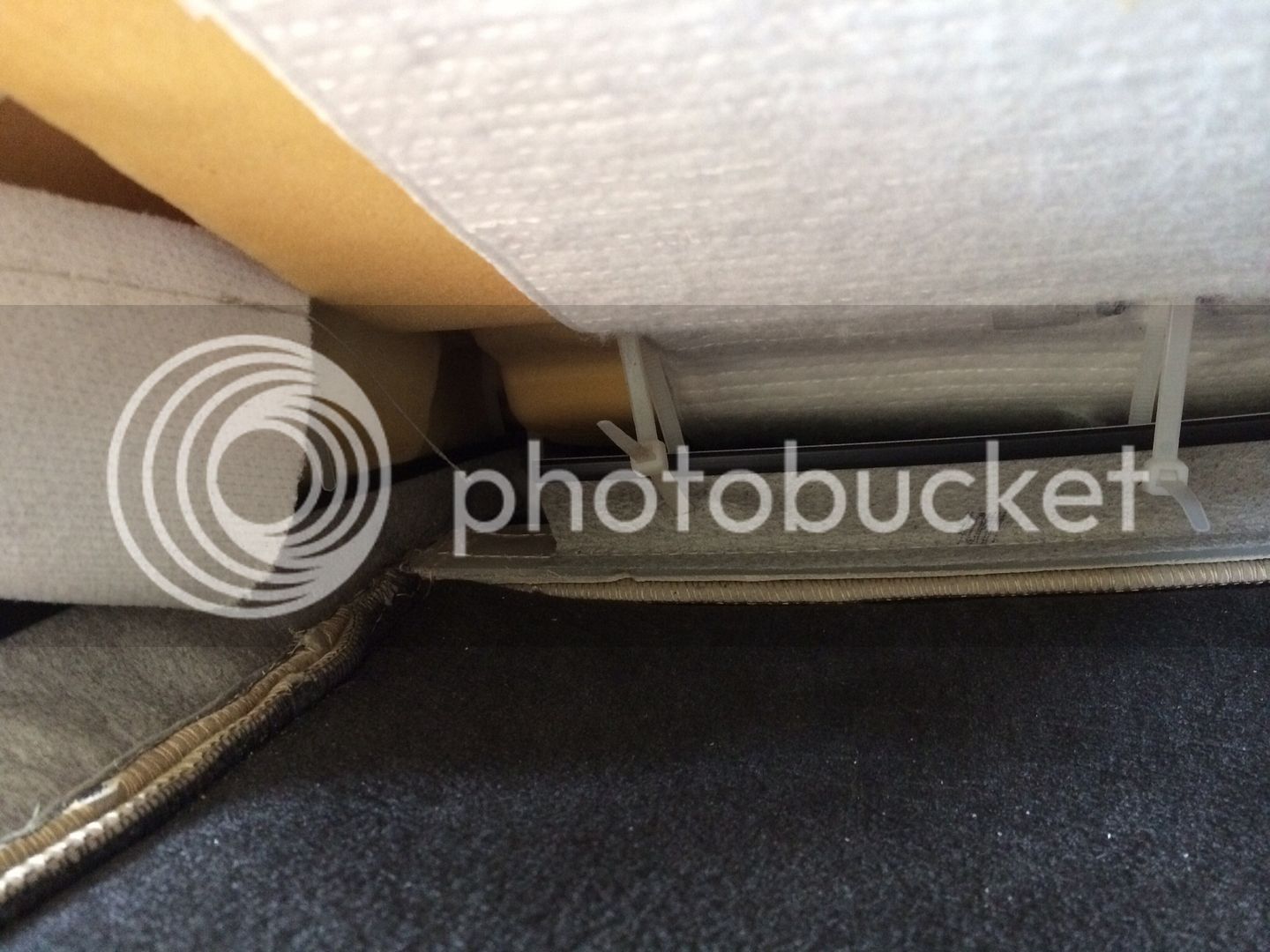

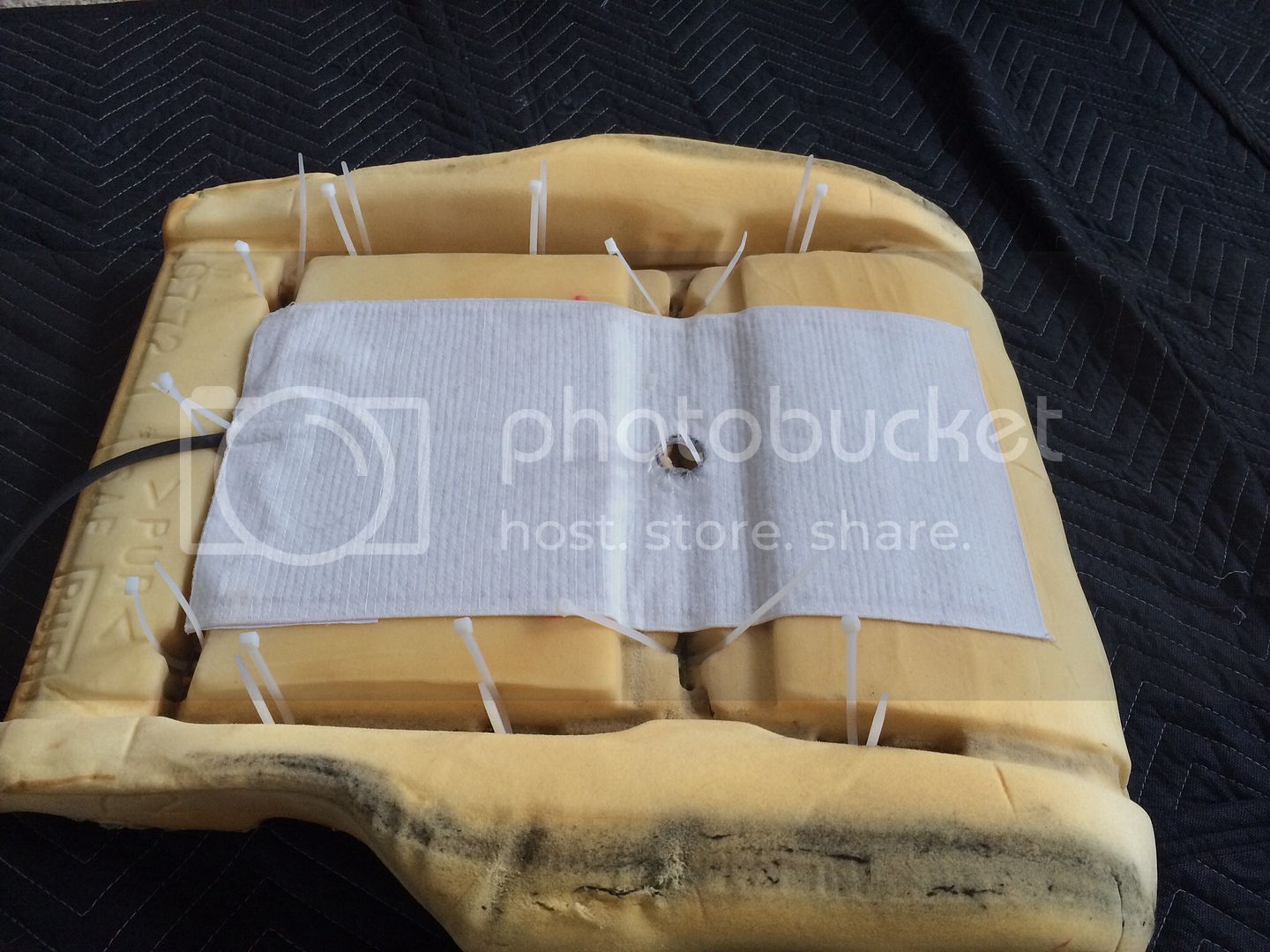

Here is a couple pics of how I did it using the zip-ties...
Very happy with the results...
