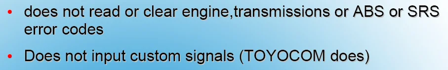

Looks like a cool bit of kit, but the OBD1READ can't read or reset CEL, ABS, or SRS and I don't think Toyocom is available. I am not sure why newer versions of essentially the same thing dropped features.
The ability to easily read or reset ABS/SRS codes would be nice.
It would be even awesomer to send custom codes to the ABS system...no more custom cables to bleed the ABS...

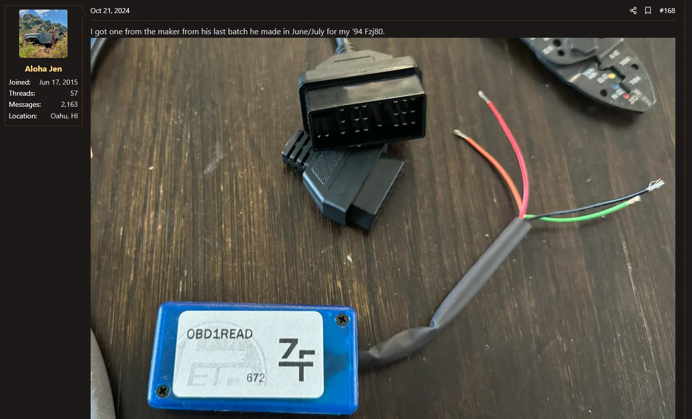

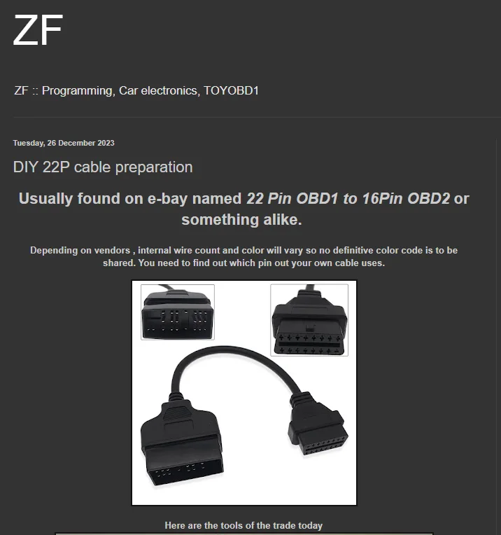

But...he's now only selling his WIFi reader for ODB1; he was selling a connector with it, but it's not listed that way anymore. You now have to buy the DLC1 connector and make it up yourself. I just checked the conenctor he sent with the setup I bought from him last year, and it in fact includes a 22-pin connector. The 23rd terminal you're missing is the ignition timing override; that terminal isn't in the aftermarket connector.
You won't need that for the SRS, ABS or cruise control circuits, though.
Here's one that looks like what he sent me, minus the OBDII adapter (he conveniently cut that off for me):
