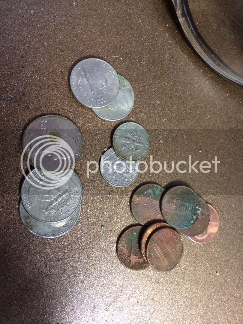

Hear you there.
Put 14oz in the KM2/TRS on the FJC, and not enough.
Conventionally balanced the Krawlers on TRS on the 80 and regret. Think I'm going to pull the Monster Valves and dump 16oz of Airsofts or break a bead and use two golf balls.
Hear you there.
Do the pellets fit thru the valves? That is something to consider...
Yes.
Would have to unbolt, but there's only a bit of thread sealant maintains the seal, so wouldn't be too big of a problem.
Golf balls would not, but hope it doesn't come to that.
