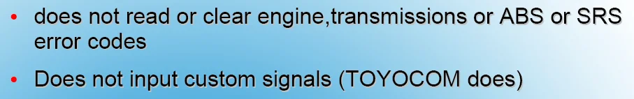

Looks like a cool bit of kit, but the OBD1READ can't read or reset CEL, ABS, or SRS and I don't think Toyocom is available. I am not sure why newer versions of essentially the same thing dropped features.
The ability to easily read or reset ABS/SRS codes would be nice.
It would be even awesomer to send custom codes to the ABS system...no more custom cables to bleed the ABS...
