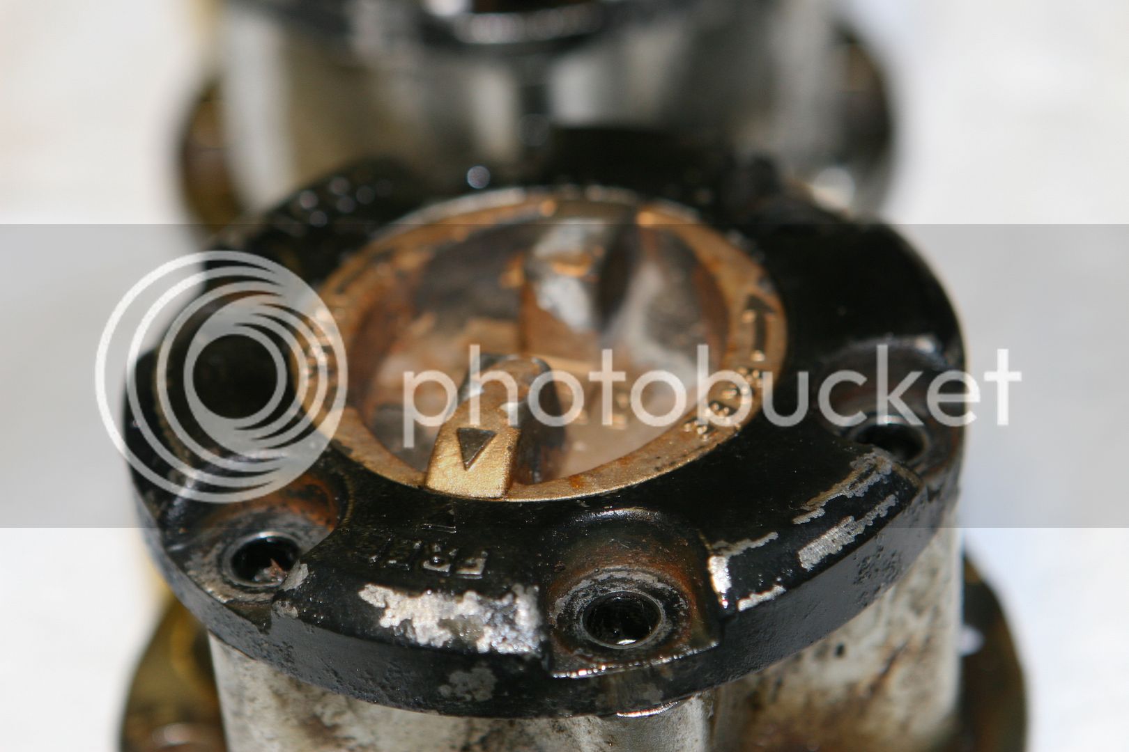

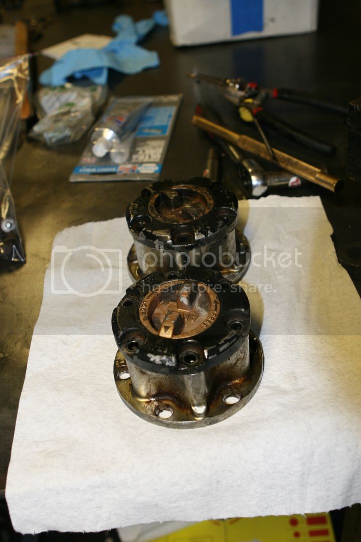

One thing I had to address are the manual hubs I'm planning for this build. Fortunately, I had a set off my FJ45 that I won't be using in that build, so the were meant to be for the 80. They were a bit beat, rock rashed enough to have wiped off some of the lettering. Glad I have the blast cabinet and powedercoat set-up, took the time to get them cleaned up.
There was so much corrosion and rash, I had to spend some time with a variety of grinding stones, wire wheels, and sanding drums to get them looking reasonable. Enough BS, here are the pics...

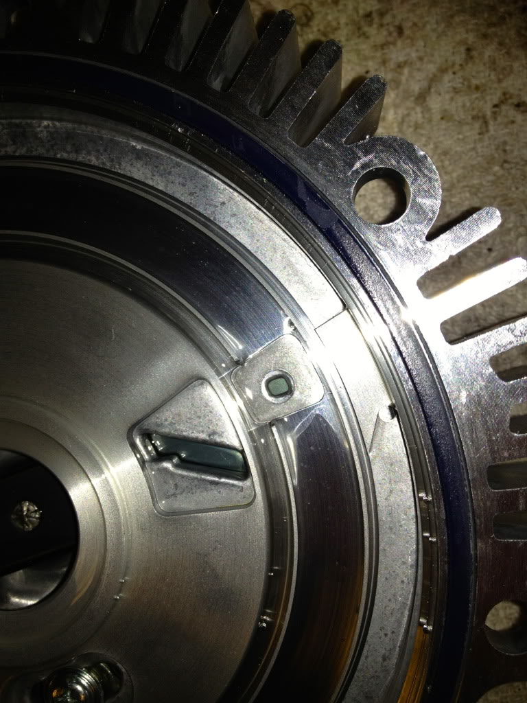

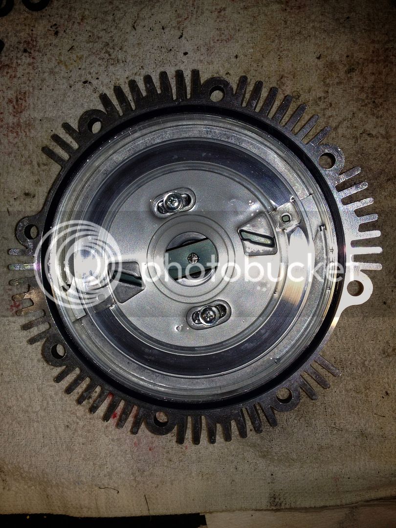

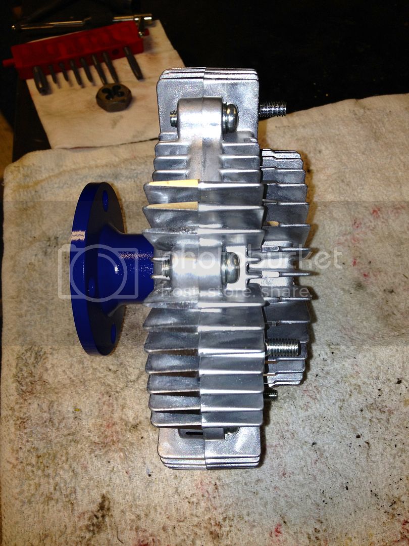

I've picked up a steel OEM radiator that is 9 mo old (from a poor sole whose motor consumed mass quantities of oil), thermo/gasket/hoses/clamps/PCV/belts/idler pulleys and fan clutch, all OEM. Nothing fun to show there but thought I'd share doing the "blue fan clutch upgrade".
Getting a new OEM fan clutch, why not take the time to do the upgrade before throwing it in. Thanks to Landtank's detailed thread, very simple and easy to do. I found some 15k CST fluid at the local hobby shop (50 ml for $3.99), would have done 20k but the tool told me he had it on the phone, someone else must have come and bought him out before I could get there...:rolleyes:
Just a few pics of the process, before...
Shots of "windows" before any adjustments...
Windows after adjustment in 95 degree bath...
Tomorrow I put it in with the radiator and all then continue with the axles after this nice distraction...:beer:
