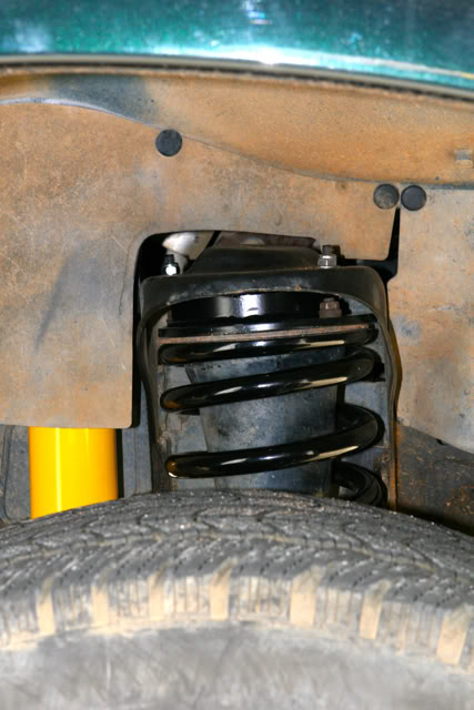

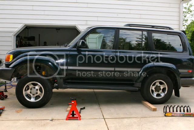

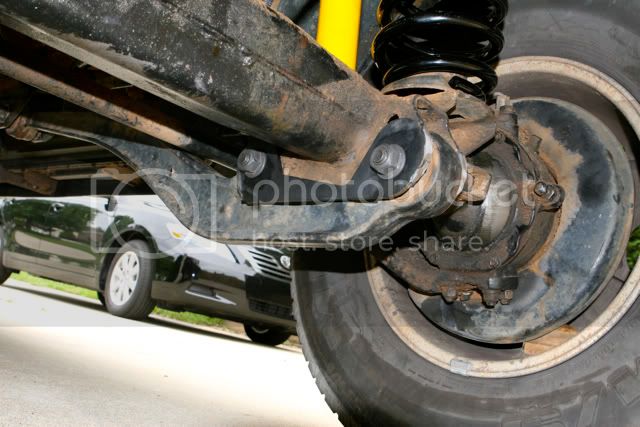

Not being one that can leave well enough alone, along with MetalTech having a "clearance" sale, gave Mark a call and he had a OME J lift on the shelf he wanted to move. That and a set of his spacers to reduce and stinkbug appearance and on it goes...

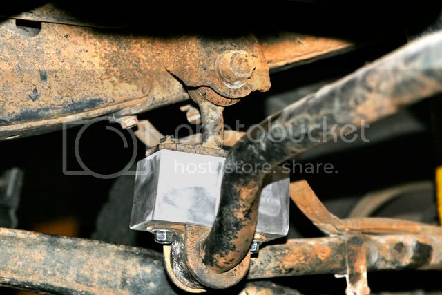

Used Landtank brackets and a home-made sway bar spacer...
Of course, after a bit of suspension upgrade, I had to put some shoes on it to match so I dropped 5 BFG KM2's in 315/75/16's. That way the girls will be above most of their threats of safety. So she drove for the past few years, safely taking daughter 1 and daughter 2 through their HS driving.

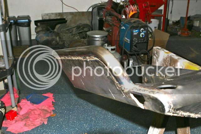

A few relatively minor upgrades were performed while the girls were driving it. First was a 4X4 Labs rear bumper kit. Our club (Olde North State Cruisers) went in on a group buy, I helped build a couple of them in our club's first group buy and couldn't let this one pass by...
It came out great, I really like Luke's design and the form/function of this bumper.

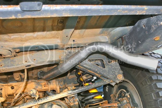

Then, a bit of an exhaust issue came to light so I had our local exhaust shop bend me up a nice set up from the down tube back...

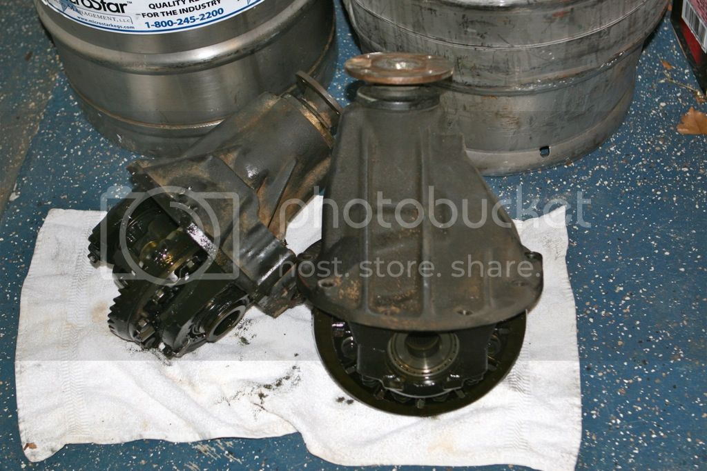

Next up, swap in a pair of OEM lockers. I was lucky to pick up a complete set from my friend Chris at Toyota of Dallas who sold me his set complete with wiring, OEM switch, everything to do an easy swap. But, I'd thought it smart to do a bit of work on them before I threw them under the rig.
Going with a fresh set of Nitro 4.88 gears...
After a bit of time with the wire wheel and a paint can, looks pretty good so far...

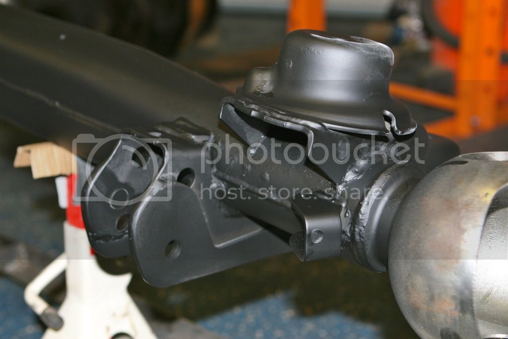

Another set of Landtank brackets on the new axle. They are much easier to drill/install when the knuckle is off and the axle is on a stand...

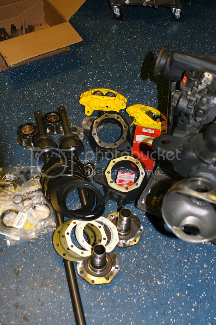

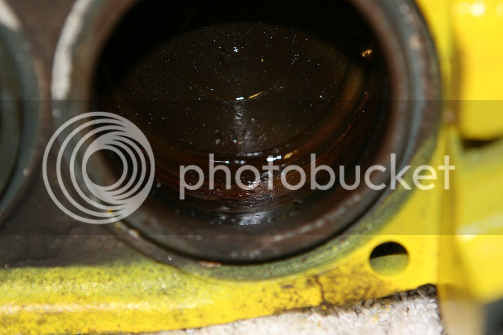

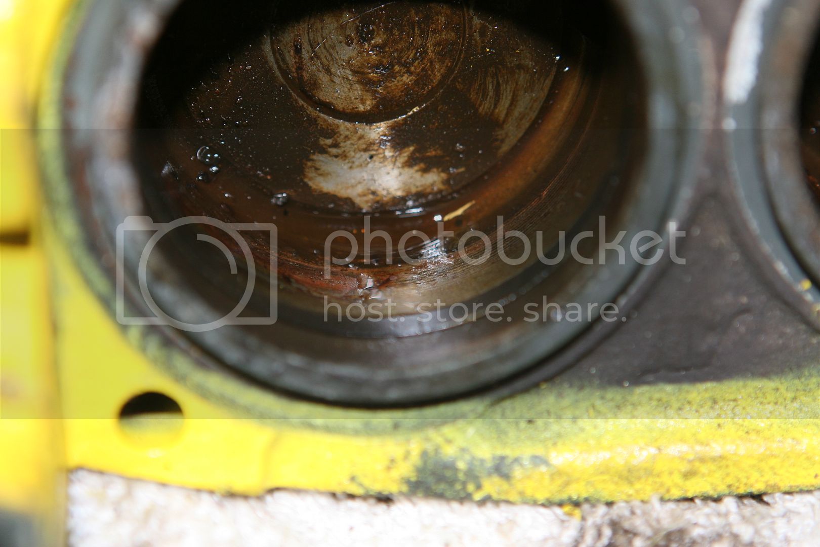

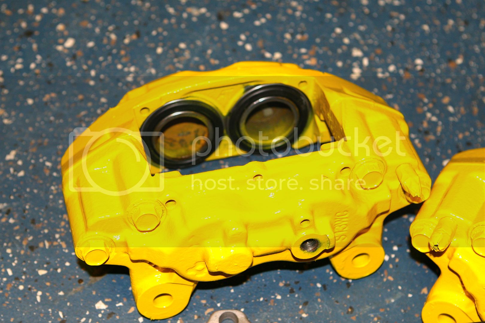

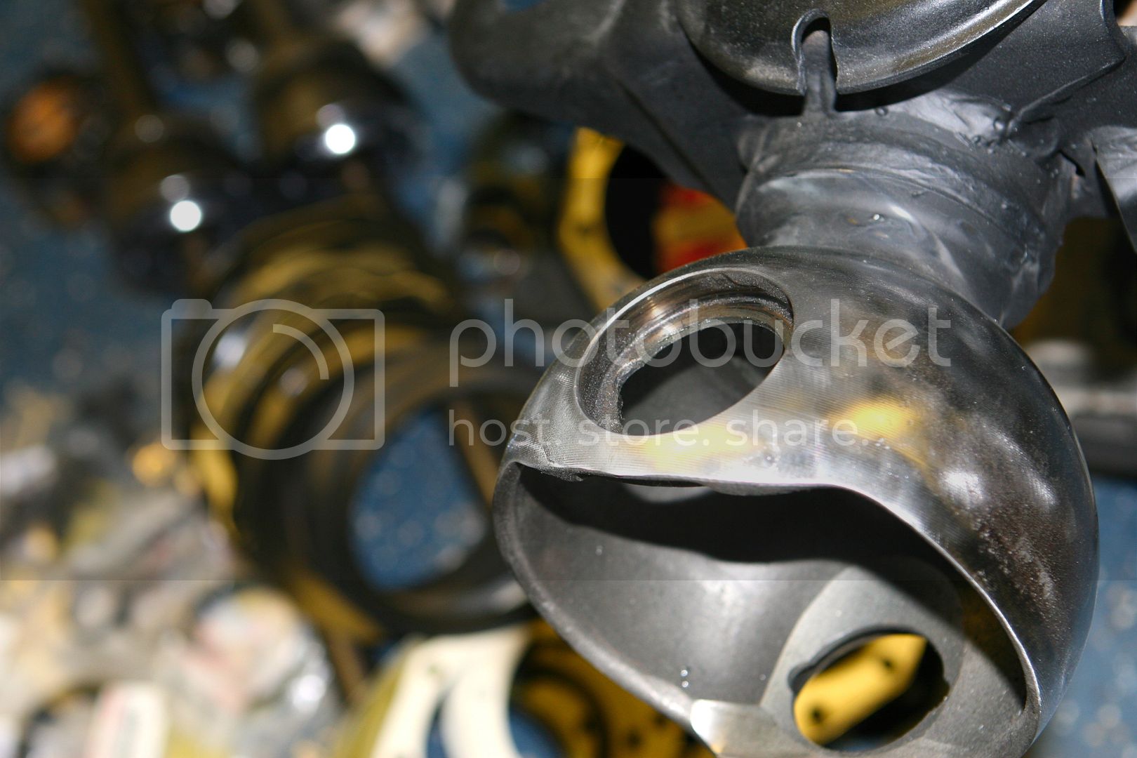

And, my wake up call for the morning. A fresh set of Longfields cut w/groove for hubs, all OEM stuff thanks to Chris at Toyota of Dallas who included the complete knuckle rebuild kit for the axles. I'm including Marlin seals and Longfield wipers. I rebuilt the brakes with OEM seal kit along with a fresh coat of LiveStrong yellow fitted with some TRD pads...
Gave some love to the knuckles with a scotchbrite and elbow grease...

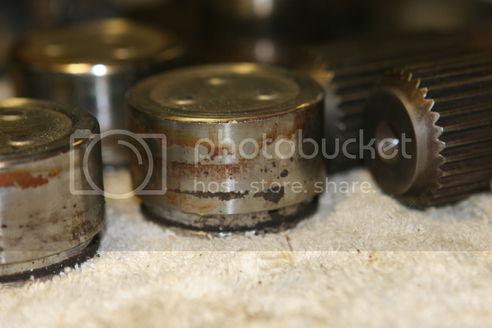

Fresh seals, learned some things doing this bit of maintenance. Found one frozen piston and a torn seal in another. Very glad I had planned to do this and had the seals on hand. Not a tough job as long as one has the right tools. I'm glad I had an ample source of compressed air to get the frozen piston free...

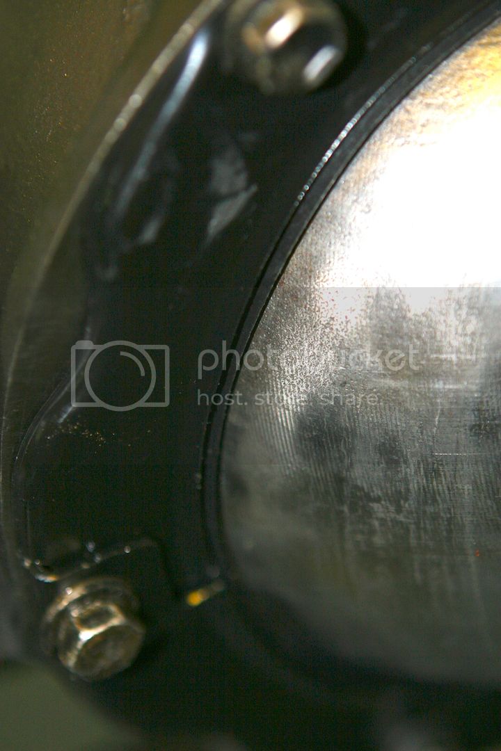

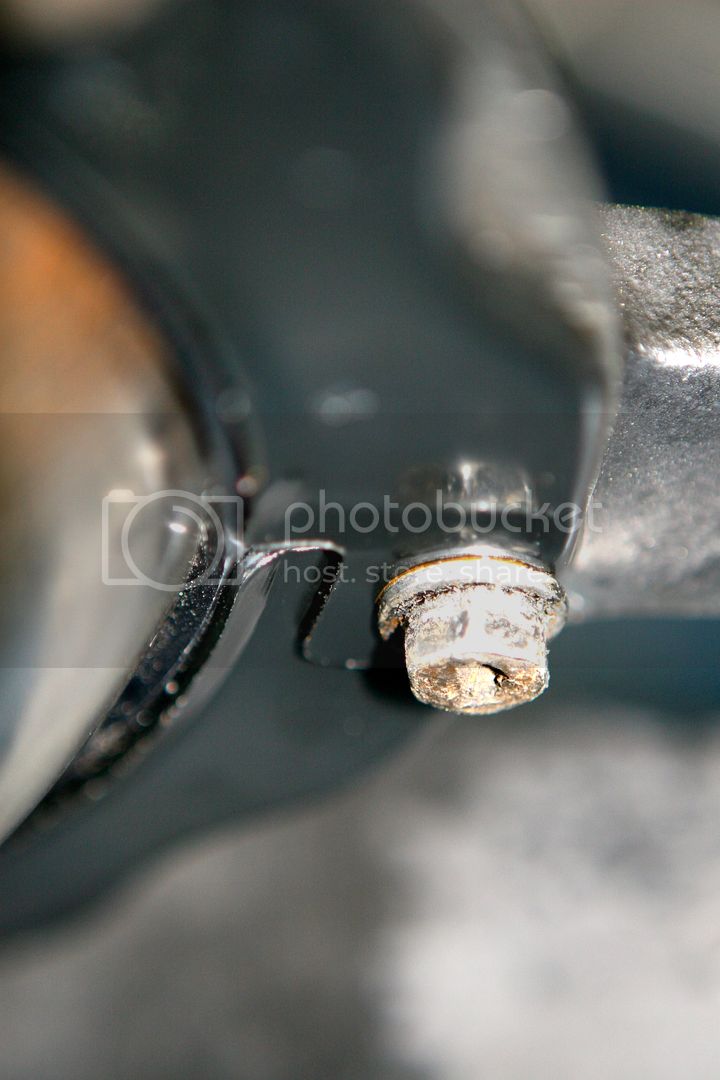

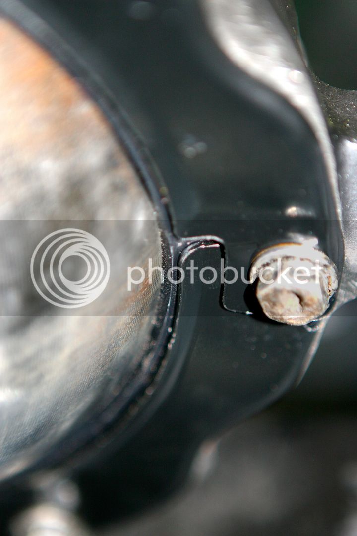

I did use the Longfield wipers and find them a simple yet genius design. I have only helped others do knuckle PM before, first time on my own. The ease of install for me and how the Longfield wipers went on was much better than juggling the felt/rubber/steel rings, for the FJ/FZJ80, it replaces all three.
I tried to take some close up pics of how mine installed to share with others who haven't seen them installed...
I can't see going back to OEM unless these go south real quick, which I don't expect. I can see how the UHMW will mold/wear/form into an effect seal, as time goes on, it should only get better IMHO.
