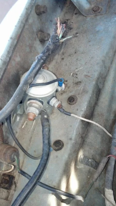

Getting to know what's under the hood.
Can someone explain to me what this is and what its for please.
That appears to be a solenoid for the snow plow hydraulics. The thick black wire at the bottom of your pic probably goes to the snowplow motor (or did.....).
Has the wiring harness completely melted through (bundle of wires above the solenoid)? That can be relatively common on a snowplow running the stock alternator......ask me how I know (or look at the smoke stains on the side of my rig).
Thanks...so it can be removed then...I don't want anything in there that isn't doing something.

I'd get it running before you start removing stuff. You never know how the wiring is set up and you want to make sure it still starts and runs after you remove PO-installed wiring.
I kind of agree. Do one thing at a time to make trouble shooting easier. The wiring is likely to be hacked. Since you didn't do it, you don't know the logic. Wiring from previous owners, is one of the most difficult things to work around.
I'm going to bet, that this truck needs to be re-wired form front to back. You are in the good zone for some help from Coolerman. I think he makes new harnesses for this year.
X2 on getting it running before thinking of tearing into it
