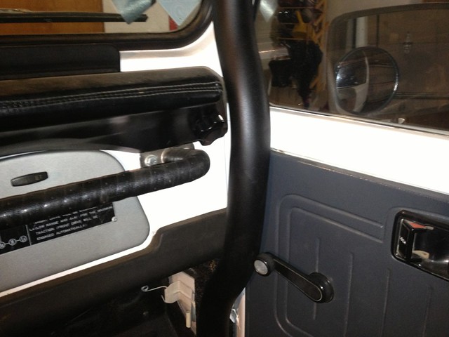

My cousin is a professional welder and helped me out with it. After reading a lot of posts here, I was pretty anal about getting the fit just right so I could roll my windows down, remove the windshield knobs, etc… We had it tacked together and everything looked great. Took it to the shop to weld it up, brought it back, put it in and couldn’t get the windows down. Doh! Did a little adjusting with which bolts get tightened up first and it is better. I have to push it a bit, but it works. Anyone know of a slightly shorter window crank that would fit?

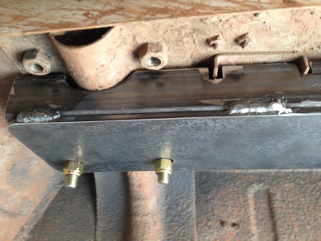

Definitely feel like the kids will be safer. Went with the front and rear frame tie-ins and the grab bars. I didn’t want to cut the wheel well supports, so I bought some 1.5x3” steel to build spacers. (see the pics) I think 1x3 would have done the trick, but the steel supplier I went to didn’t have it. We were moving pretty fast when we put together the frame tie-ins and I didn’t think about the fact that I wouldn’t be able to paint the tops of the custom tie-ins. Not sure how long that setup will last before it rusts out. I tried to spray a lot of paint up there, but… Not sure that I have a whole lot of options at this point to get at them other than cutting them out or removing the tub. Also not sure if the bolts need to be trimmed so the wheels don’t catch on them. Guess I should jack one wheel up to see what the clearance looks like. May have to use shorter bolts and sink the nuts into the steel.

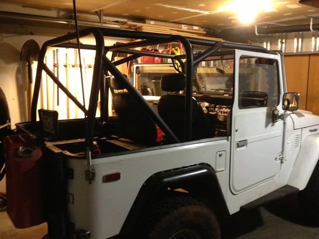

I have noticed that the cage seems to shimmy when I am driving down the road. Not sure why it does that, but it is distracting and I worry about it rubbing against my dash pad over time. Any ideas?

A couple of tie ins between the windshield and the front hoop would likely resolve the shimmy. As for the clearance, how about usiing a come along to tweak the front legs a hair? They've likely warped a bit when they were being welded... Even a ratchet strap to pull them together while you bolt them down might help.

bikersmurf, thanks for the ideas about pulling the A pillars in with a strap. Will have to give it a try. The shimmy is in the cage, so I think tying it to the windshield frame would just make the windshield shake. If I just can't get it, I will shoot you a PM ;)

There's too much distance from floor to top of windshield. A dash bar will stabilize the front hoop and stop the shimmy. If you notice the mid and rear hoops don't have that same shake. Same happens when people try to build external cages with pillars that are unsupported for over four feet. After a couple hundred cages I'm kinda familiar with this

A dash bar just above the pad will solve that

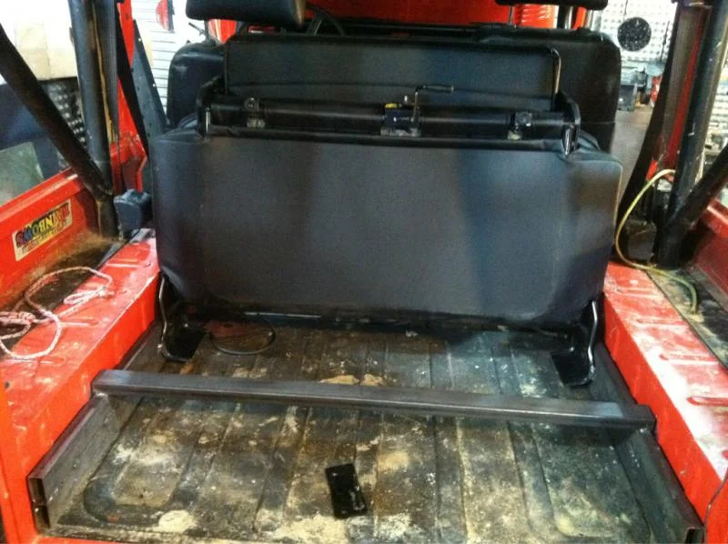

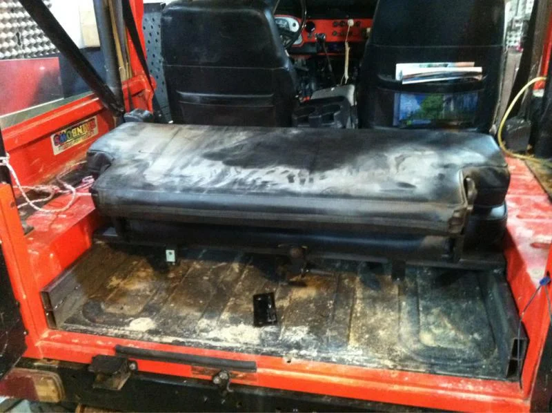

My plan is to weld a piece of flat stock across the bottom of the seat and mount three harnesses to it. I searched for a seat that could accommodate three kids and I kept seeing the Little Passengers seats for $700 -$1,000 depending on options. Those seats are roughly 40" across. Then I saw the Bestop Trailmax seat and it's 41" across. I'd only ever seen them set up with two seat belts and wondered why no one ever tried three seat belts. I ordered one and had three of my kids test it out. They fit comfortably. I'll post some pics when it's finished. The arrows are where the harness will be attached.
41" seems narrow for 3 car/booster seats... The trailmax seams ideal size wise for a 40. I'd like a better rear bench, but seating for 3 is required.

I thought so too. I am no longer using booster seats but three 10-12 year olds fit comfortably.
SouthB, how will you tie in the rear of the seat? Whatever you tie in with will have to take all of the weight and force of the kids in a frontal impact. That cross bar and tie ins will need some beef...
