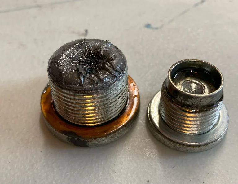

- Changed diffs and TC at 32k with Ravenol fluid change package for the 200 series (magnets on diff plugs looked good with some black sludge but no sizeable metal particles otherwise, hoping at 100k to find less)
Front Diff drain and fill plugs & Rear Diff drain plug (all fine black powder, magnet makes it look different)

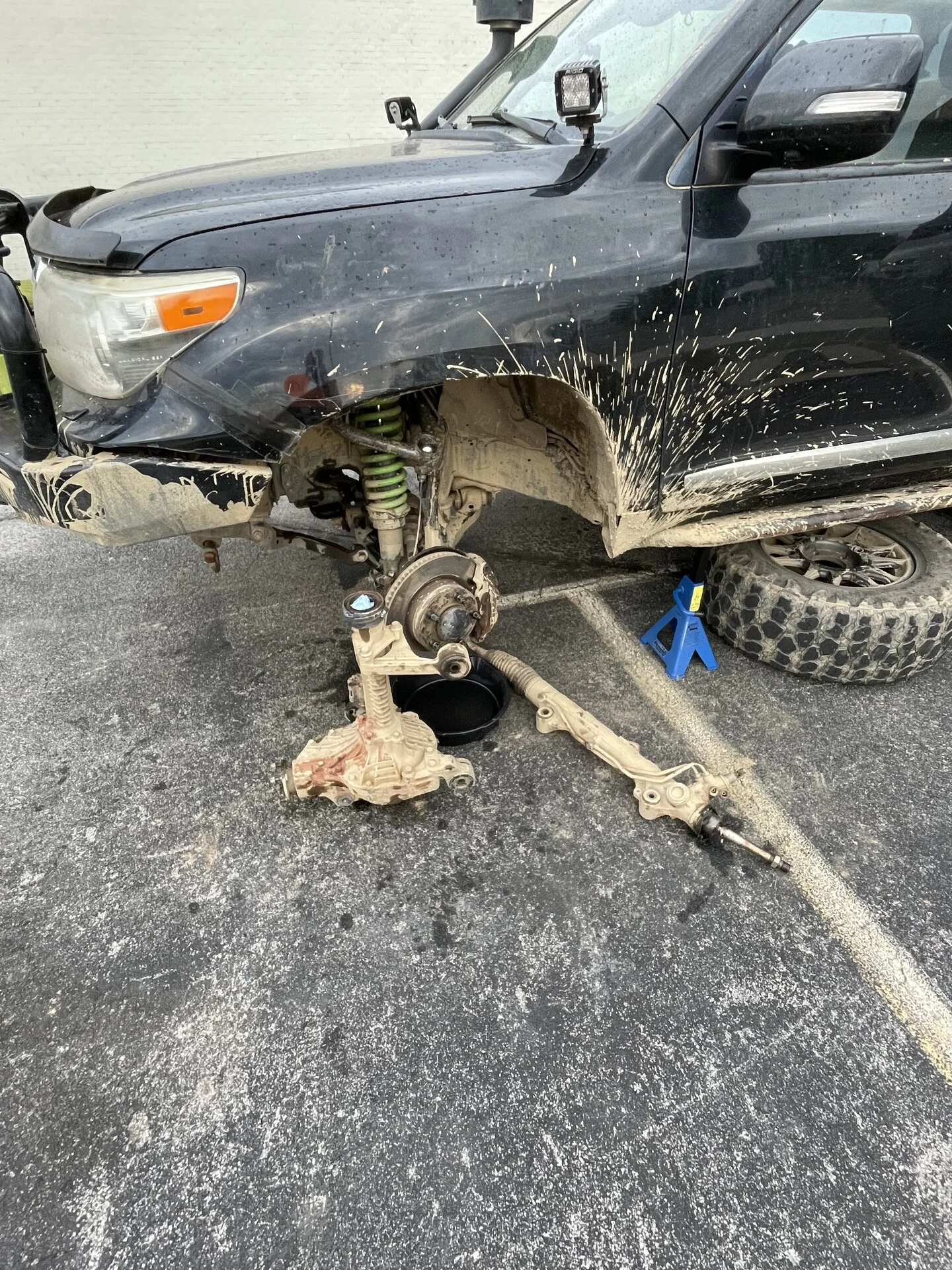

After blowing out a rack and seizing a vane pump at Windrock I went through a few vane pumps and two racks even after flushing about 10 gallons of fluid through the system during the whole operation. It was a real headache trying to figure out the issue. In the end I realized contaminates were causing the valve in the vane pump to hang.
One I put if the filter I had no more issues. The other option was to replace all hard lines and cooler 🥴
I was much happier with the $15 filter 👍
Fun times in the parking lot:

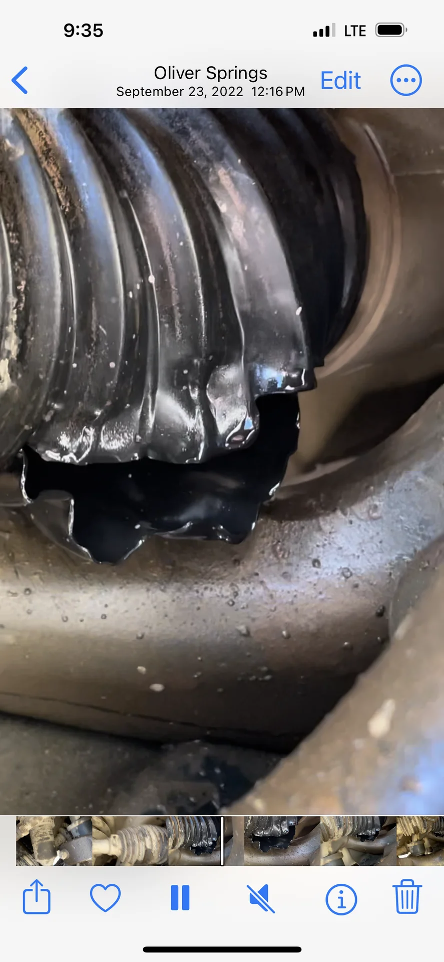

Looks like there was a little bit of pressure behind this blowout 🤣
