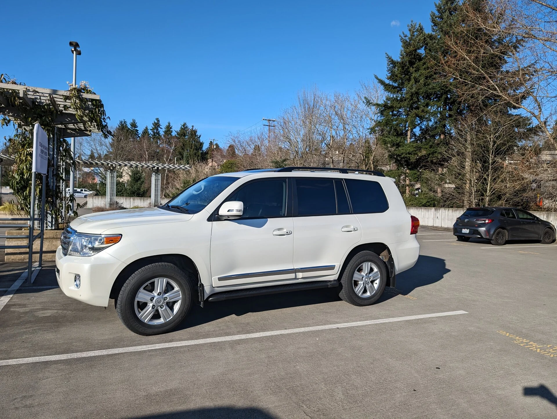

I just purchased a 2014 with 42k miles, I'm going to start driving it a lot more than the last guy did. Any recommendations on services/maintenance I should do because of the age of the car and not the miles? It still has its original tires and brakes!
Due to the age, I might even add changing the front and rear diff fluid, transfer case fluid, and transmission fluid might be a good idea as well.

Nice find. I assume you’ll get new tires. Those are 10 years old and IMHO need to be retired. :rimshot:
