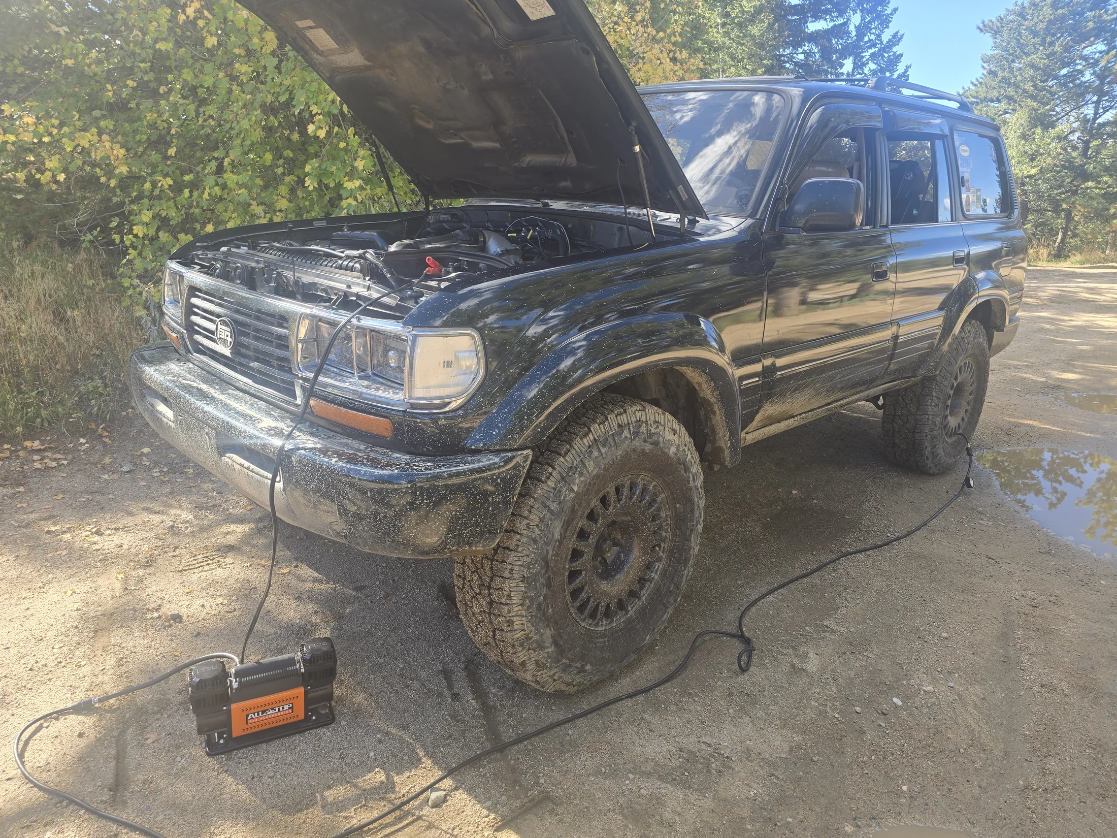

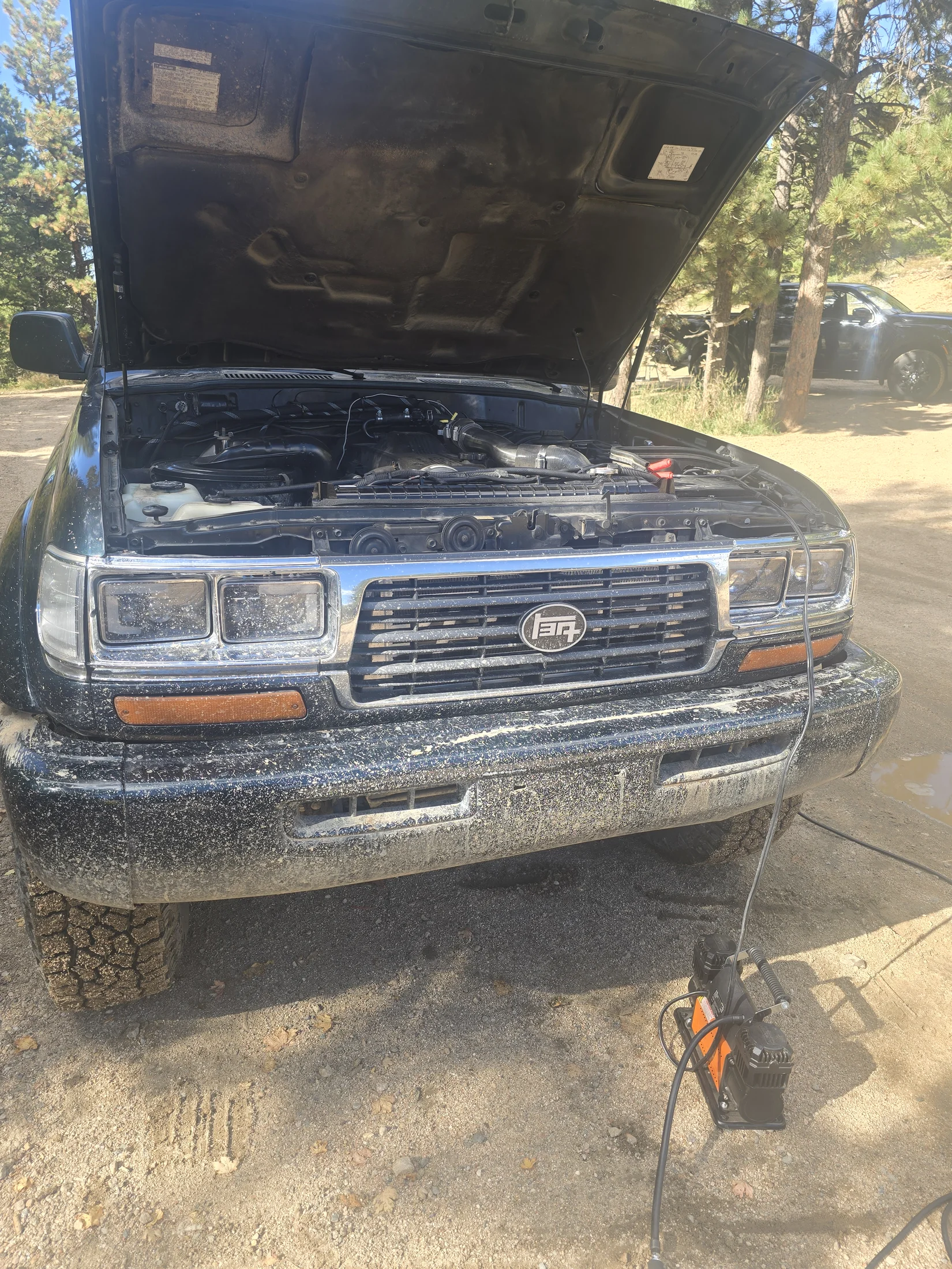

Offroad maiden voyage today. Everything is working as intended.
Its fun learning to drive again with the 5speed manual, especially in the mountains.
Drove it around 150 miles today total, no hiccups. Just smooth sailing. Dropping it off tomorrow for AC lines and recharge.
