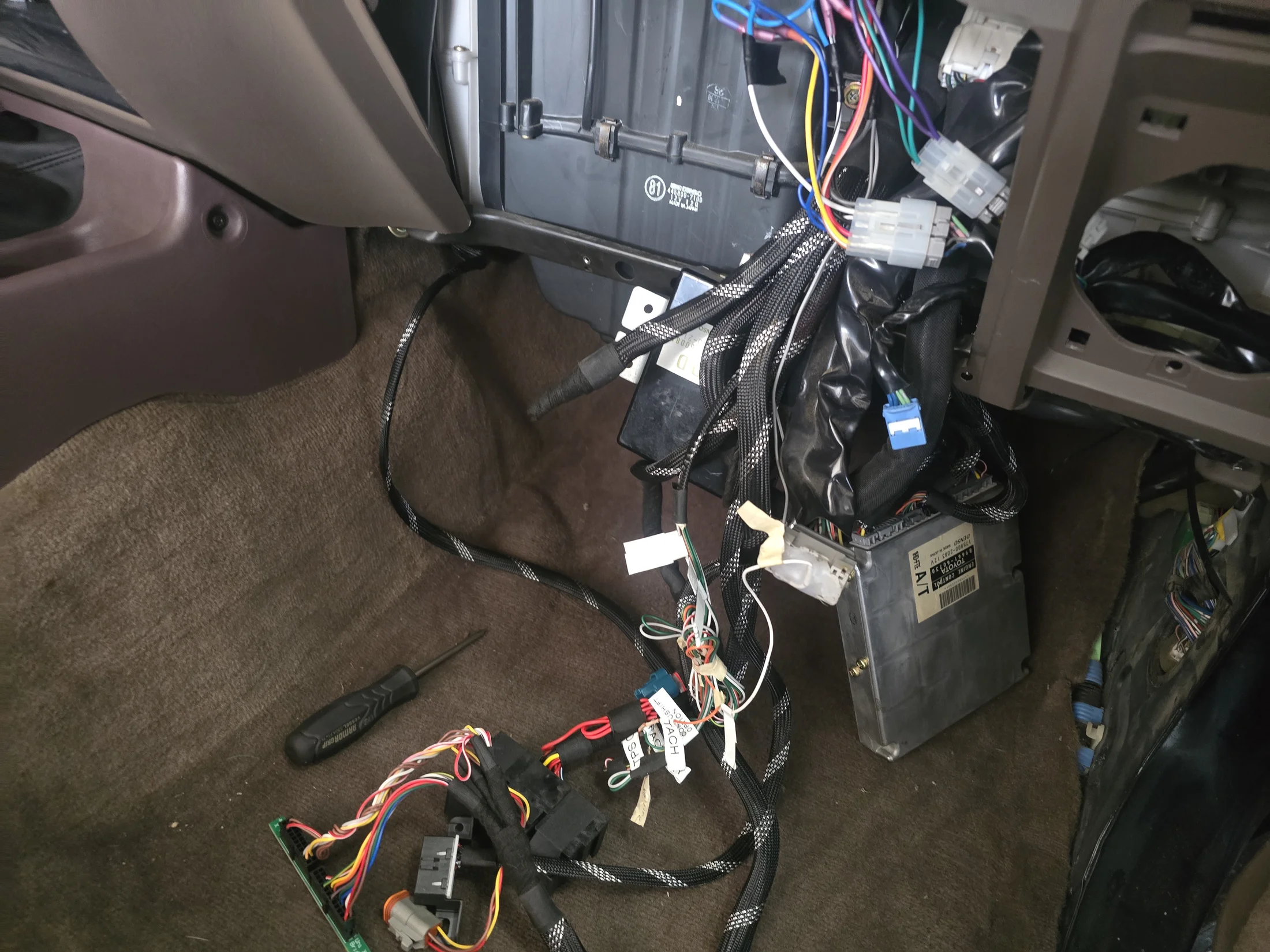

micks harness is nice, but its really long and bulky. Its going to be a pain to route and tidy up, I either have a lot living in the engine bay in a roll, or its in the passenger floor board. We'll see how I organize it after we get her running.

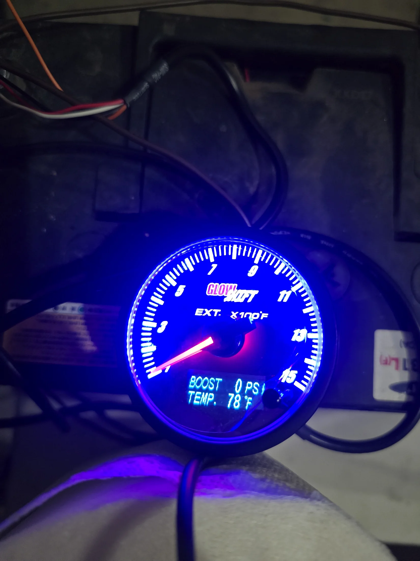

Picked up a glowshift 3in1 EGT,BOOST,TEMP gauge ill be monitoring during.

I'd rather a harness be a bit too long than a bit too short. Might be worth getting creative with the routing and seeing where you can waste some length.
Oh yeah for sure, I'll pretty it up!

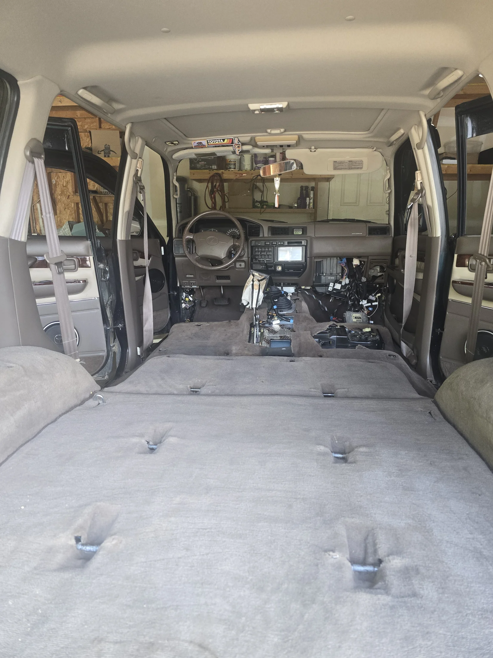

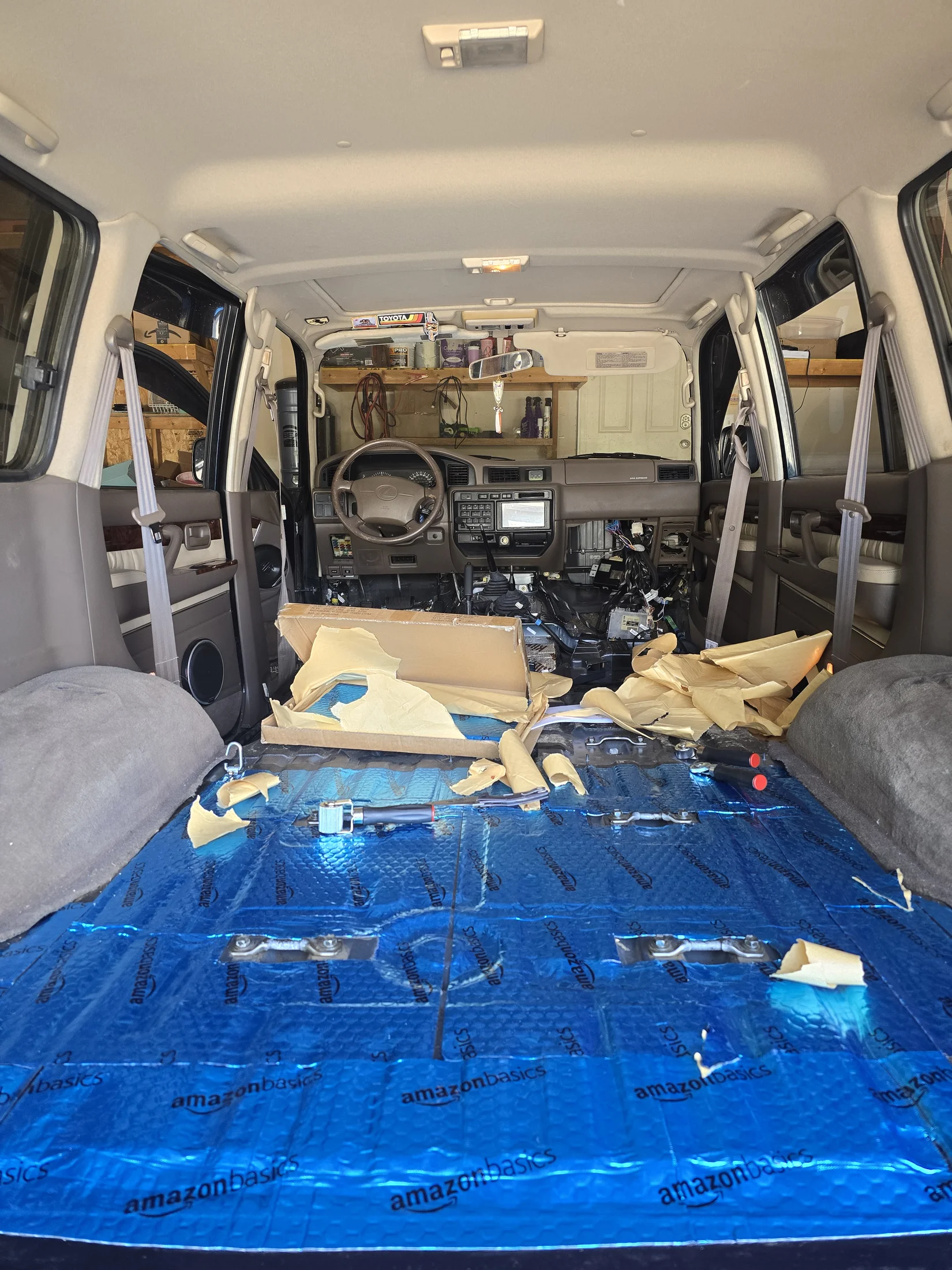

Avoiding the engine bay for a few, i just need a break from staring at wires lol.. Moved to getting the interior in.
I probably work in a super ADHD way, ill partially finish one task, move to the next partially finish that one, in a viscous cycle until they are all complete.
Let's get this pig buttoned up today, shall we?

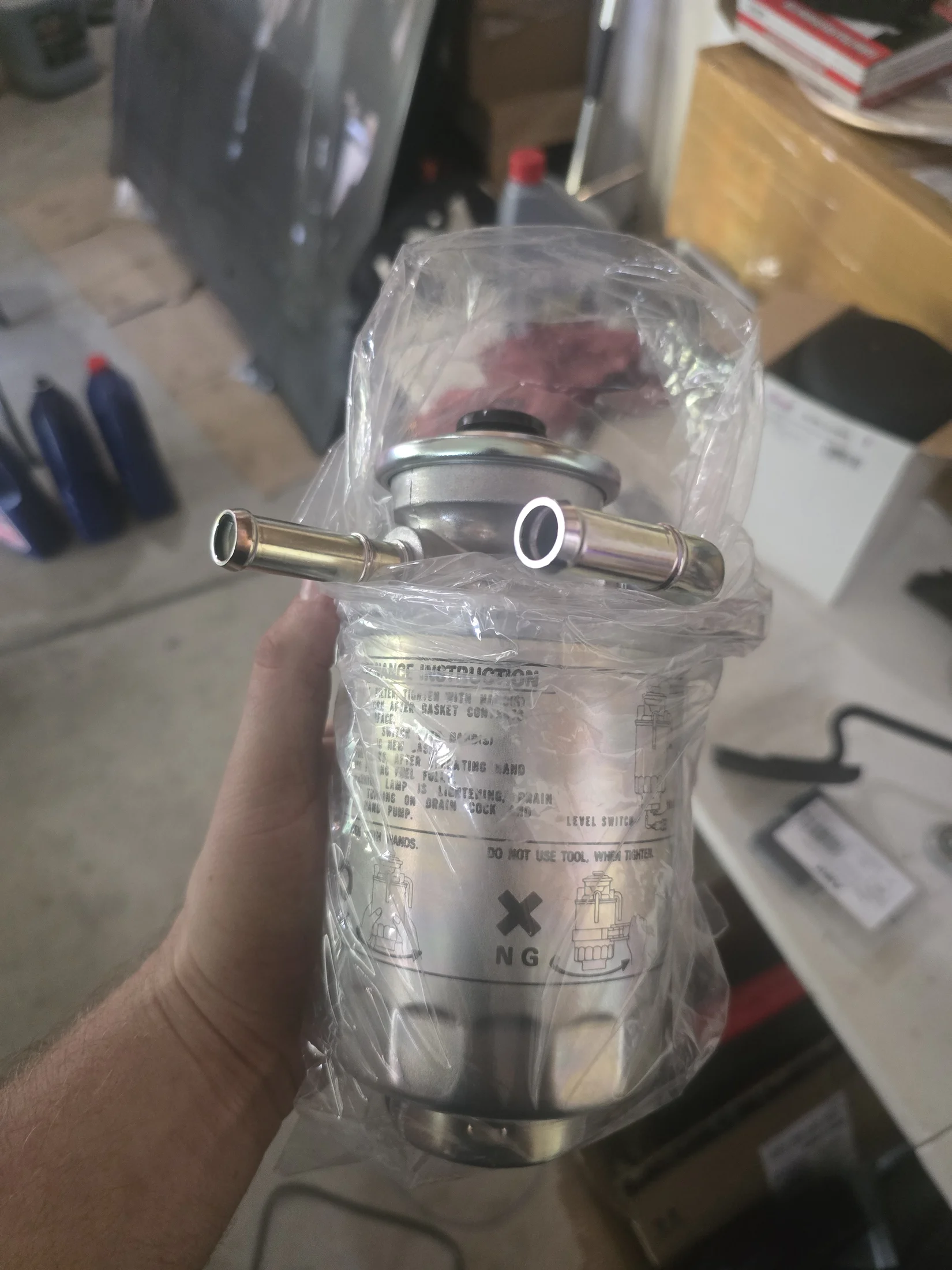

Also got a new primer/fuel filter assembly, ive heard the diaphragm breaks down inside, and then they can pull in air. Im going to run my old one for about 50-100 miles with the old filter to catch anything from the tank when I was draining, flushing it, etc.

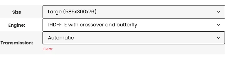

I noticed your PDI kit was the crossover delete style - why did you end up going crossover delete? I'm not seeing an option for delete/vs keep in the GTurbo site options, though they show images of both, whereas the actual PDI gives you a dropdown menu :bang:
Did Gturbo ask what you wanted? Worst case I can shoot them an email, but figured I'd ask since you just went through this.
Order from PDI, Gturbo just sends one assuming you have one of their aftermarket turbos, and a cross over delete. This has caused me quite a bit of headache.
If I wouldve noticed/thought I wouldve made sure it came with crossover piping, and setup for a stock turbo. Something ill just have to remedy in the future.

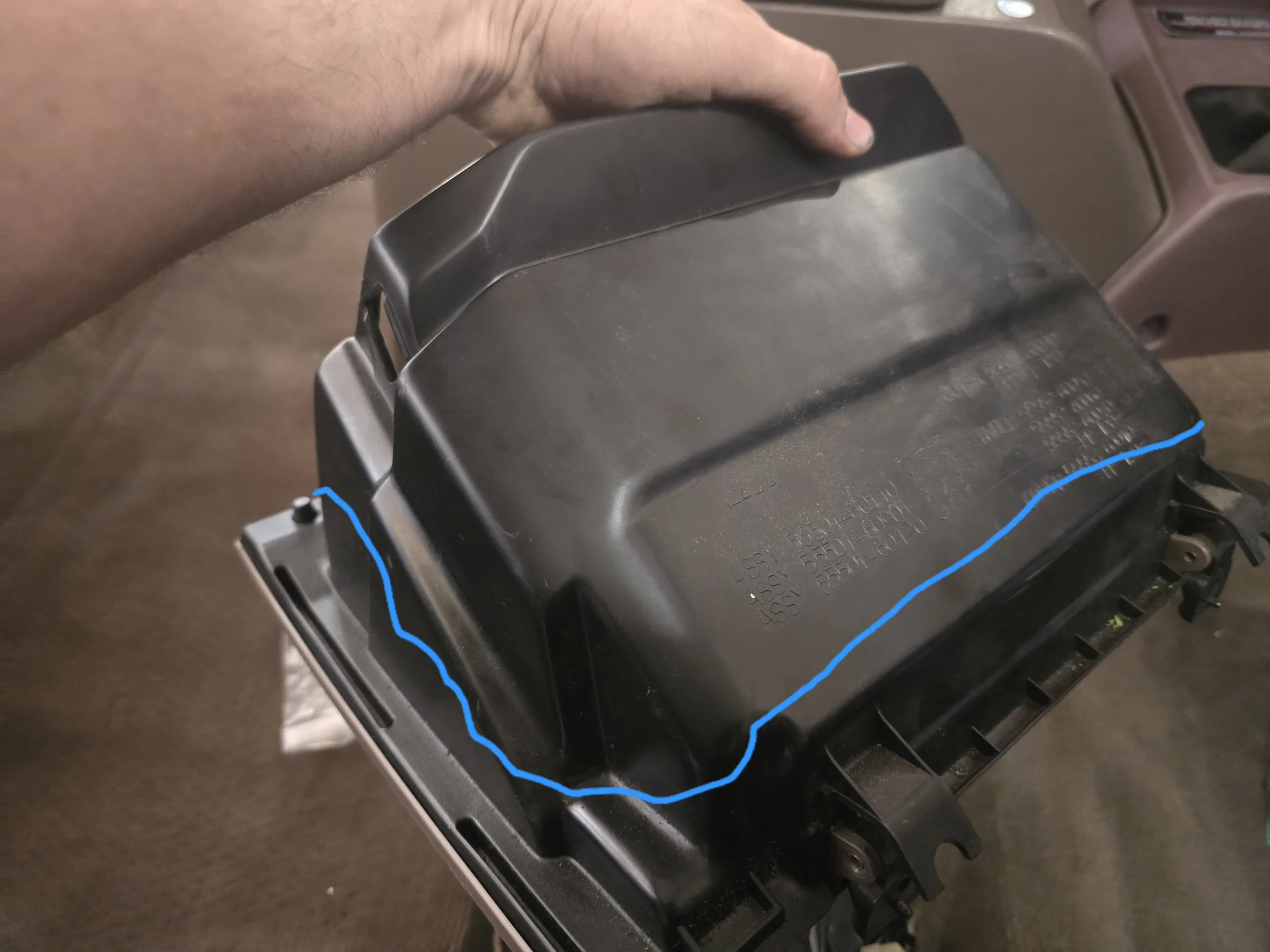

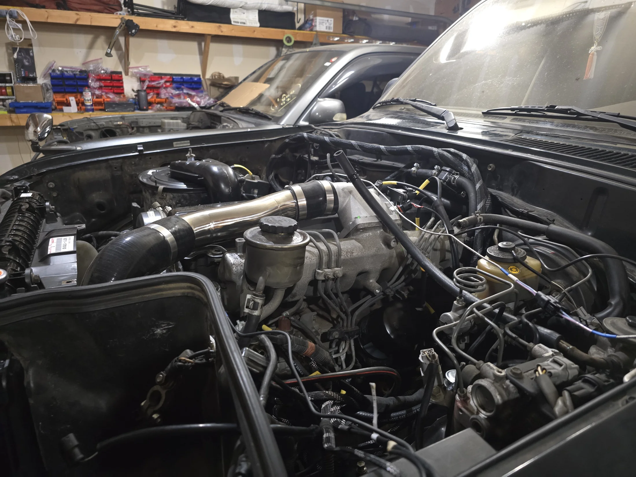

Help me feel better about this. Ive got a lot of loom to hide, do cut my glove compartment lid? I hate the thoughtView attachment 3985732View attachment 3985734
You weren't kidding about it being LOOOONG. I'm not sure what I'd do, but it wouldn't be the glovebox. I'd tackle shortening the harness before that, but I'm pretty comfortable with wiring.
Shoot, I wouldn't cut the glove box either!
I'm going to probably have the same problem so hopefully we can find a good solution for you!
Cut all the slack out of the wire. Was the harness made for RHD configuration or something?
Comes from Australia. great harness, I gave the measurements from the firewall to the 1FZ ECU.
