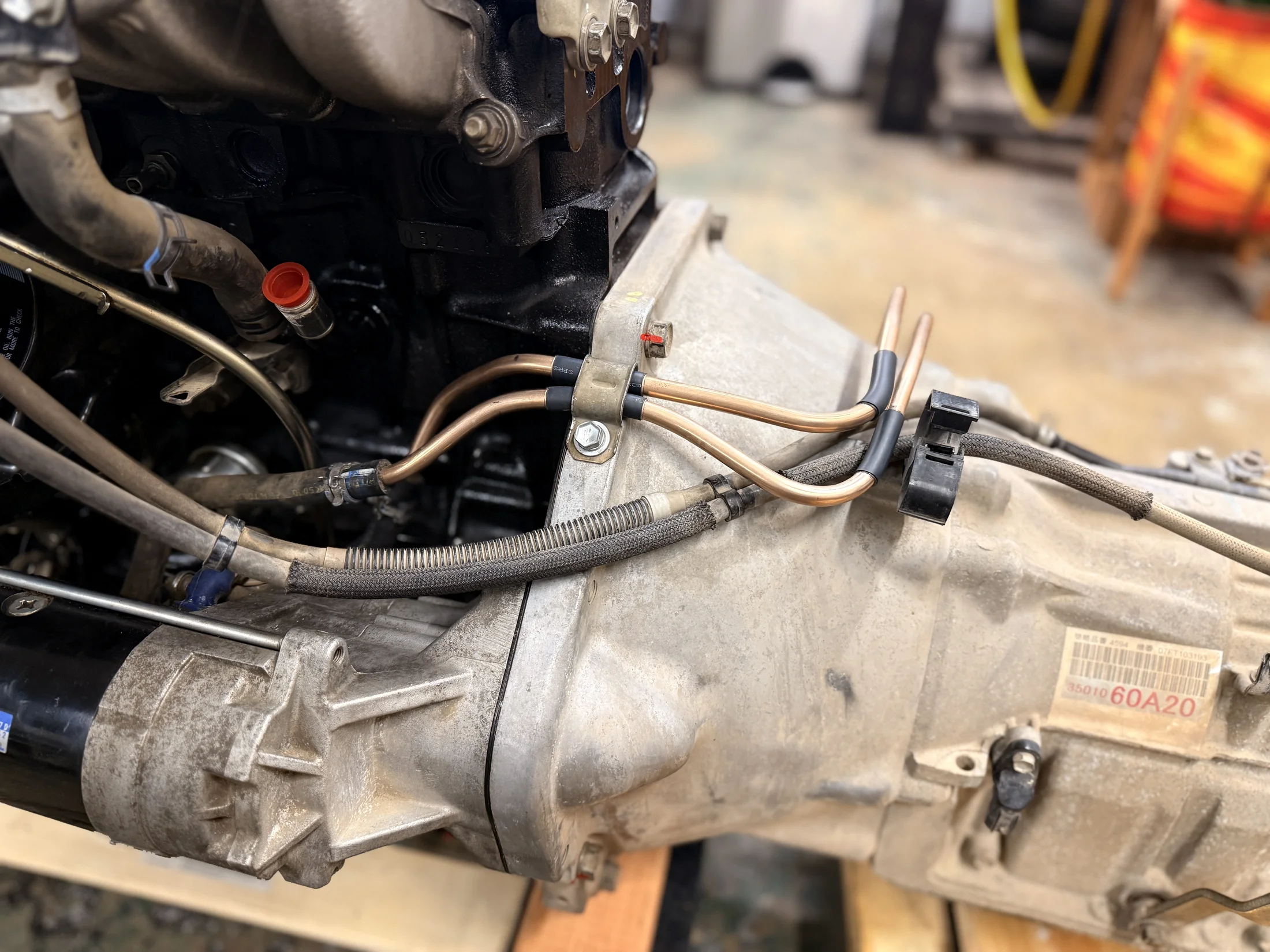

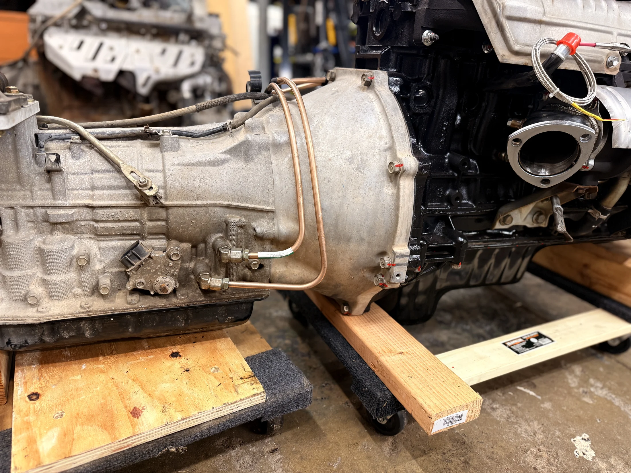

@Mag71k5 crazy timing, and thank you! However, I now know they're M14x1.5 - Today I went to 3 auto parts stores in a row, until I ended up in the back-of-house racking of an o'reilly going through random bins of fittings marked "NO REFUND", and found three of the fitting I needed. I asked how much and the store associate said, "I think we'll Merry Christmas those for you". Nice. :beer:
So I picked up some 3/8" NiCopp line from them and started dreaming up some hard lines. I drilled and tapped a hole on the trans bell housing to use an OE line bracket, still using adhesive lined heat shrink out here. Depending on trans temps, the heat shrink might be re-activated, but we'll see.

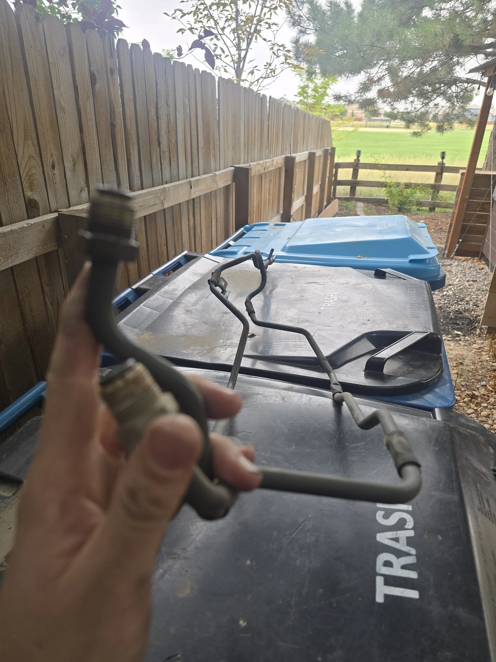

Planning to re-use the small steel hard line section from the 1FZ that routes along the engine, up to the rubber lines at the front. The FTE doesn't have mounting provisions for the brackets in the same location, so I'll have to come up with some solid places to mount it using the OE brackets.

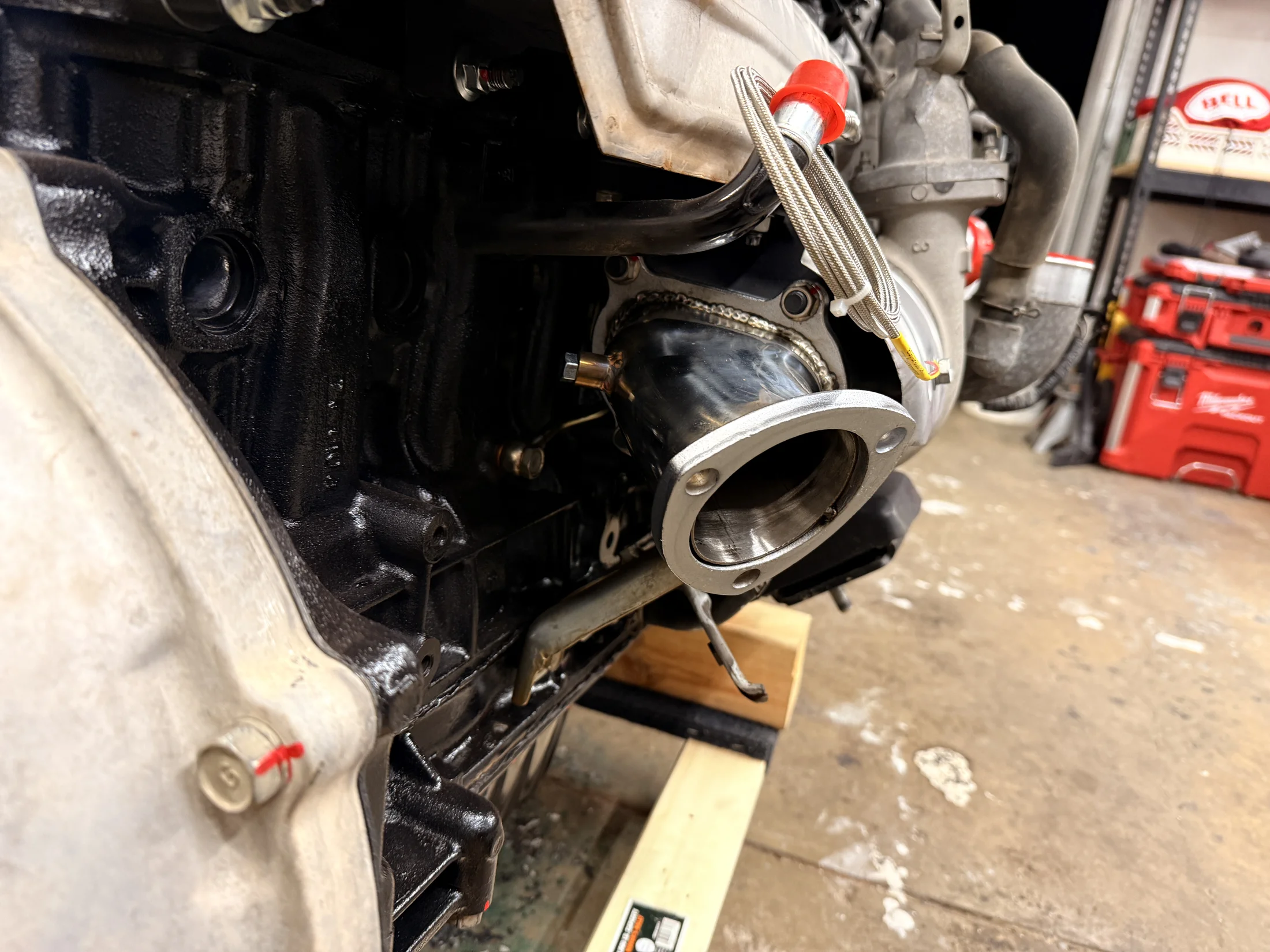

I had ordered an OE FTE turbo dump gasket and OE nuts and used those instead of the gasket provided by PPD to mount the turbo dump. As expected, the Toyota gasket looked to be 10x better quality.
i reused the 1fz hard lines. They are alot different then the 1hd lines. I could get the front factory bracket to work with a little bending but that's it. Had to custom make a bracket at the rear of the engine that hangs off one of the oil pan bolts. lines are very close to the starter, not sure if you could replace the starter without unbolting all the hard lines or not. The 1hd starter is way bigger then the 1fz.

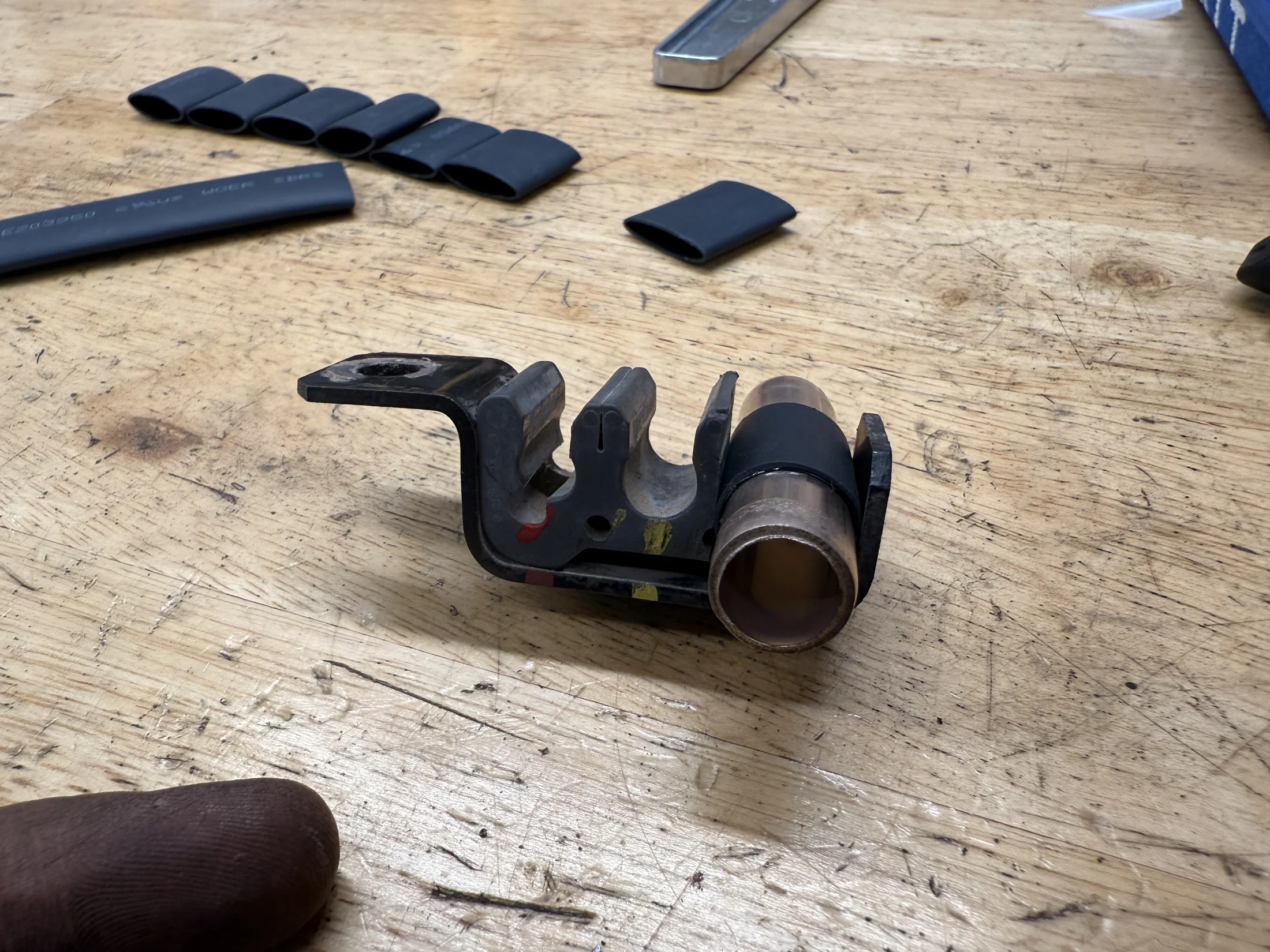

I managed to follow the original 1FZ routing, by removing a small section in the rubber isolation in each bracket, then using adhesive lined heat shrink as a hedge against abrasion with the bracket. I didn’t get any photos of it installed, but here’s how I modified the fuel line brackets

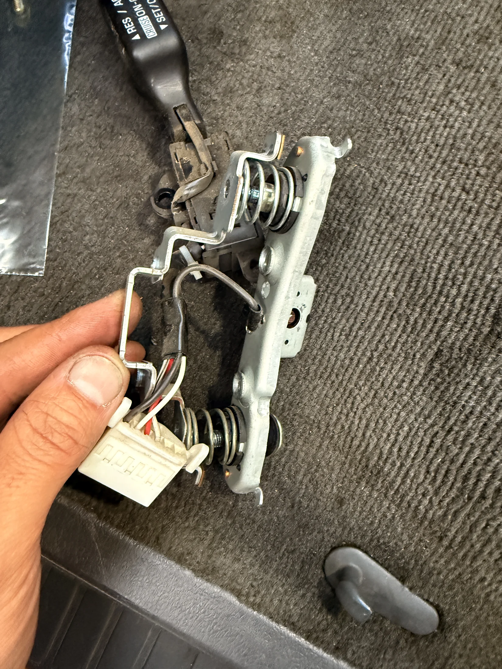

Also, finally pulled the cruise stalk to get shipped out to Lutz Auto.
Attached the 80 series chassis-to-A750F shifter adapter, from the Lutz Auto conversion kit - fairly straight forward with a right angle drill adapter.
What does he do to the cruise stalk?
I'm not entirely sure, it sounds like he is just soldering in a resistor so it can communicate with the FTE ECU.
I would do this myself, but haven't done the research on what needs to be done, and Bryan gave a very fair price to just do it for me, so a bird in the hand is two in the bush.

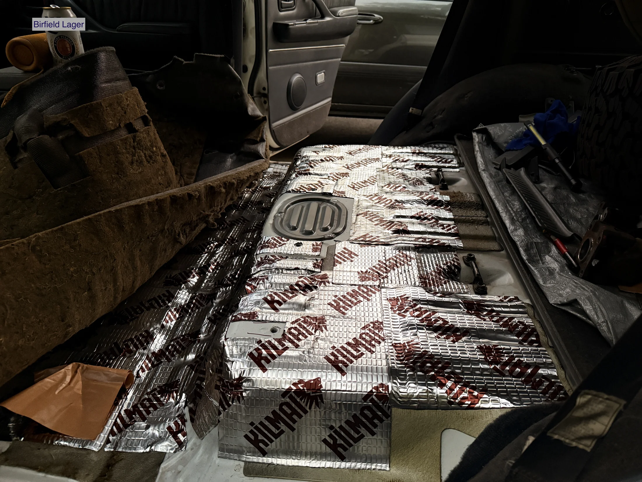

FTE Pedal is in, and I got lost installing some sound deadening thanks to the instant gratification of amazon same day delivery. What a time to be alive.

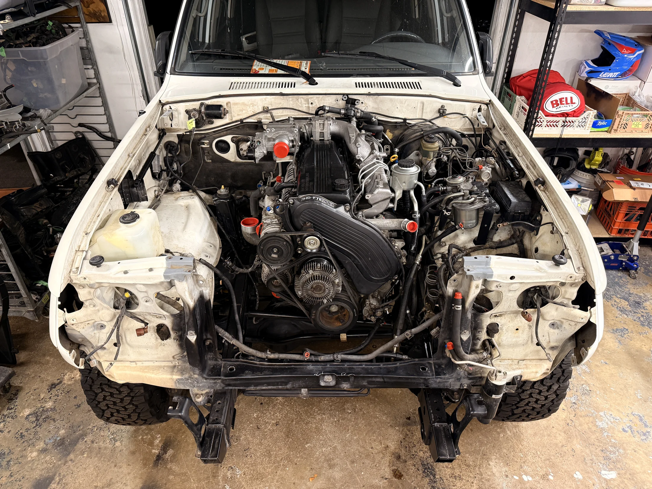

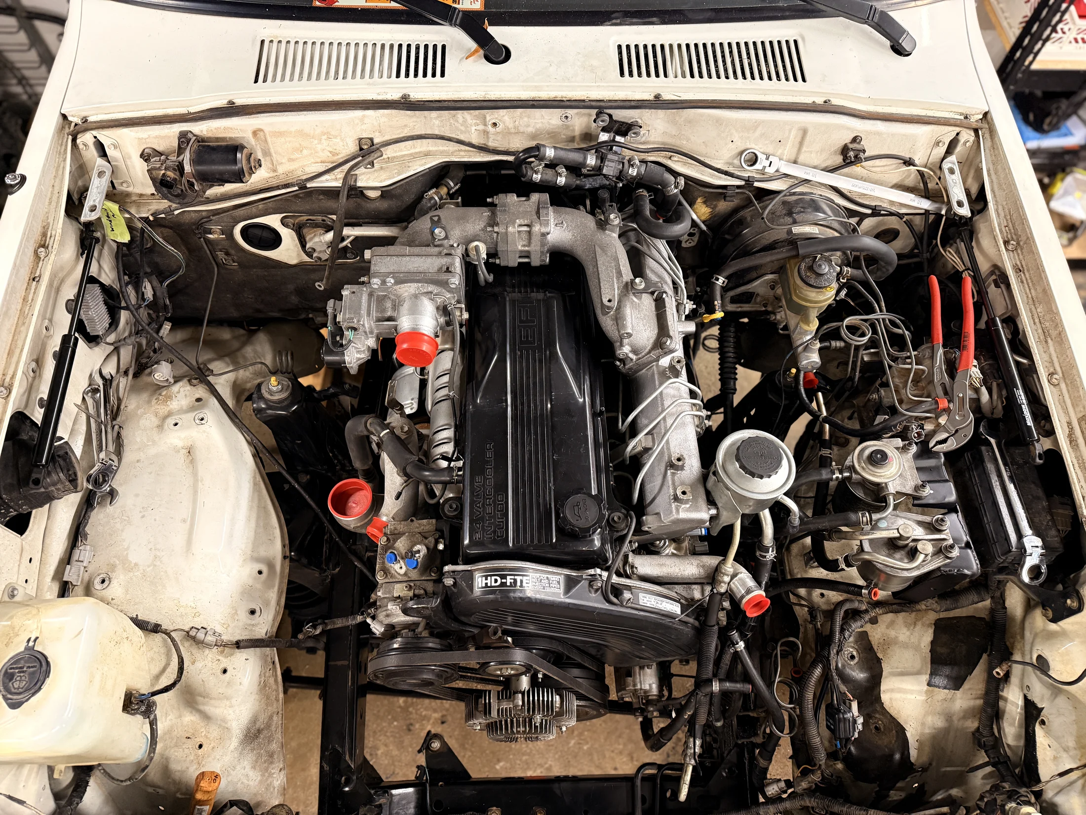

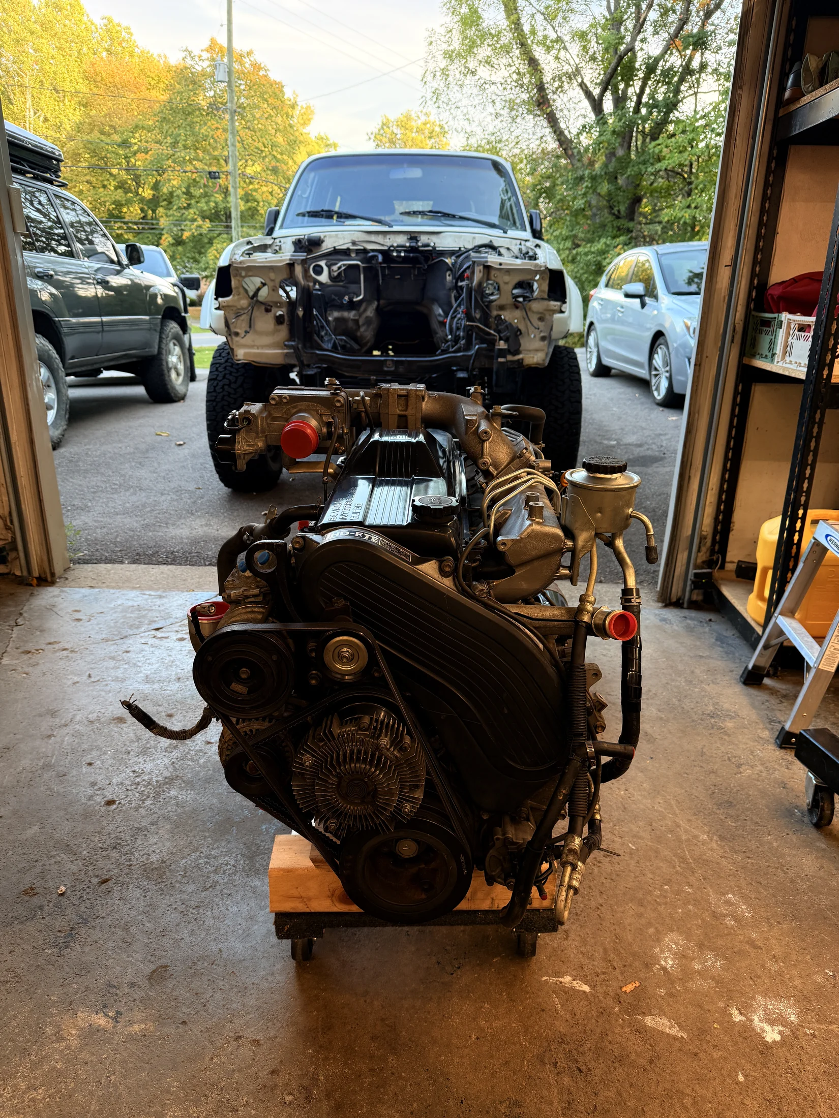

Small detail, today the engine found it's new home. :beer: :beer: :beer:
I'm going to call this the halfway point.

Small detail, today then engine found it's new home. :beer: :beer: :beer:
Great job man, how difficult was it for you to get the fte in? It was a bastard for me man lol.
