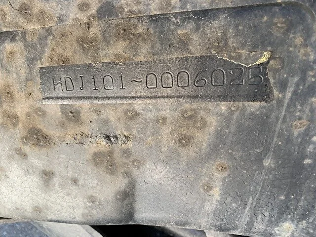

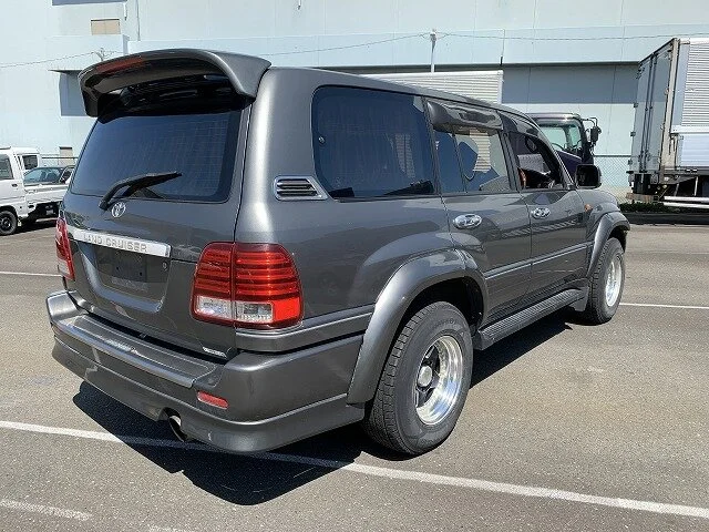

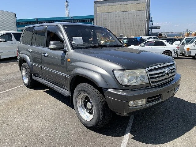

I decided to go down the painful route... with the highest gamble. a few weeks ago I bought a 1998 HDJ100 through Japan Car Direct. Mike was my auction agent, and he was great to work with. I'd pick out an HDJ100, he'd go over the auction sheets, and give me his thoughts, we did this for a about a month before we finally landed on one, I thought I could get it for a decent price. The stars aligned and my bid won it. The ship date is the first, should hopefully be here by the end of May.

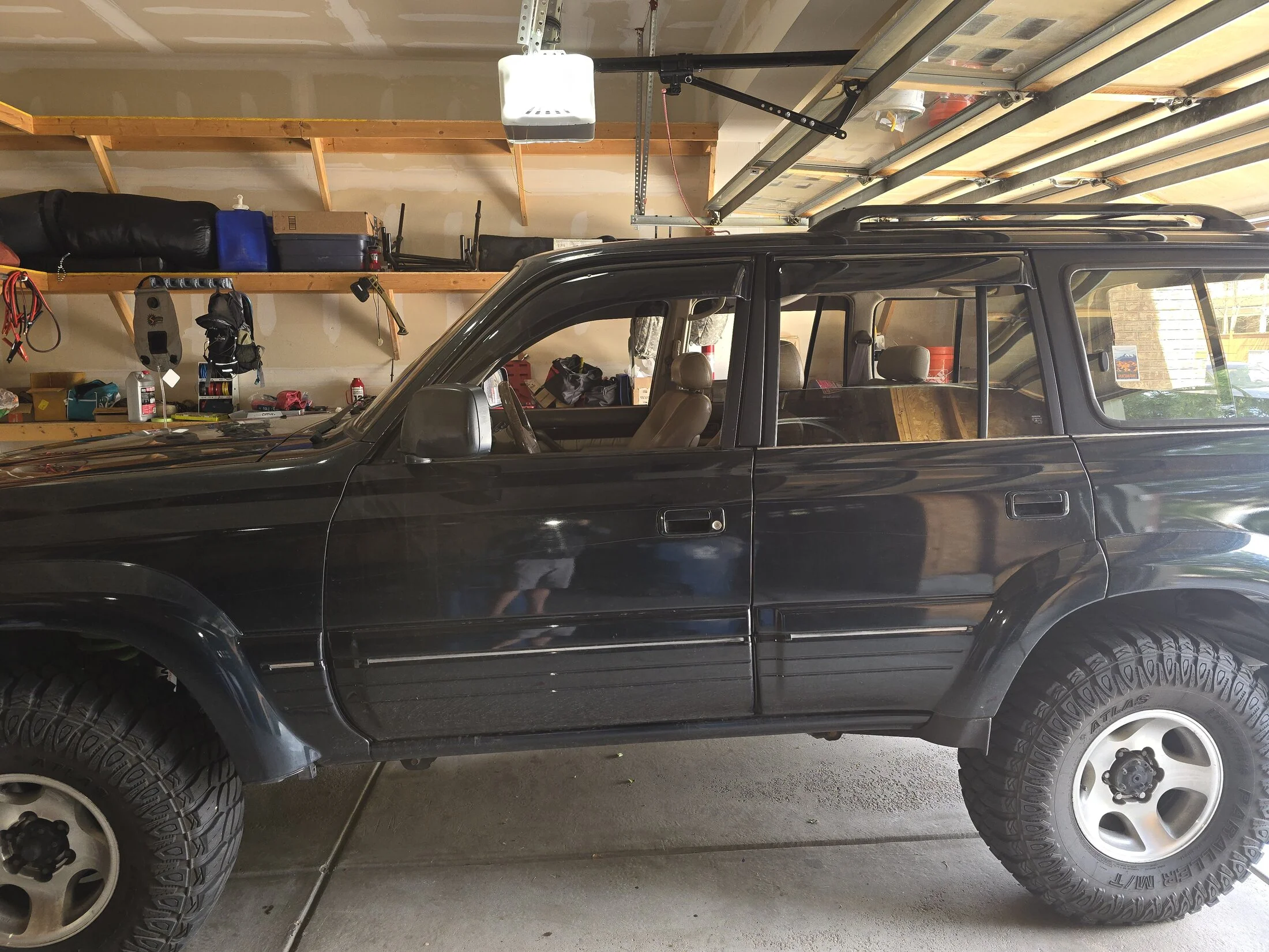

Here's the LX450, on Charlie Brown Christmas tree duty

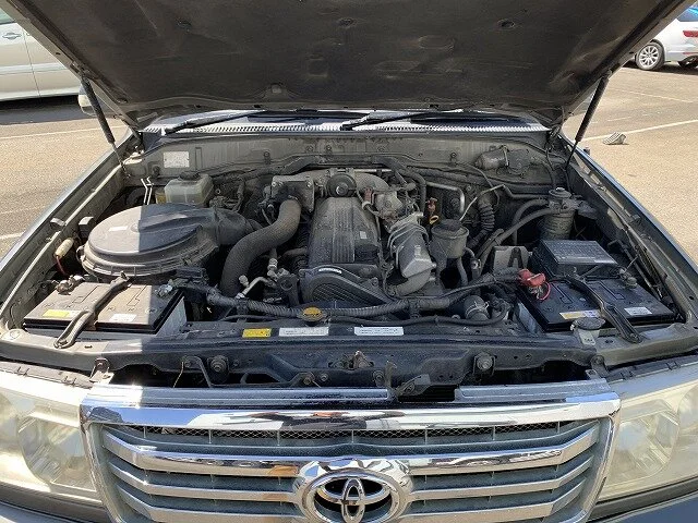

Here's the HDJ100, coming from crusty rusty Hokkaido.

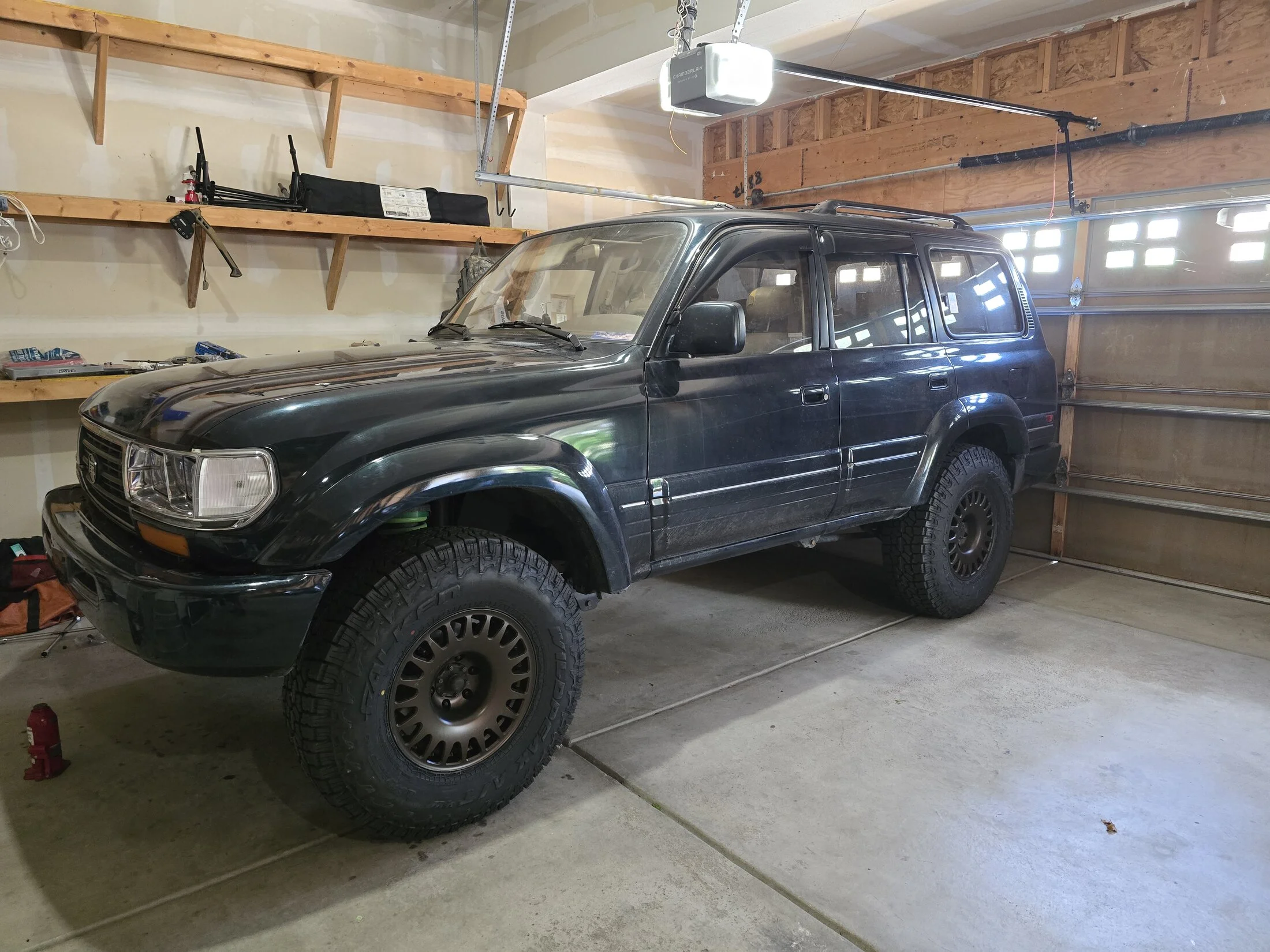

Tossed on the 35x11.5x17 Falken Wildpeak AT/4's I've had sitting around for nearly a year. So glad I replaced the Linglong MT's I had that were probably 15 years old. Going camping this weekend in her, might be the last camping trip before I start digging into the 1HD-FTE.

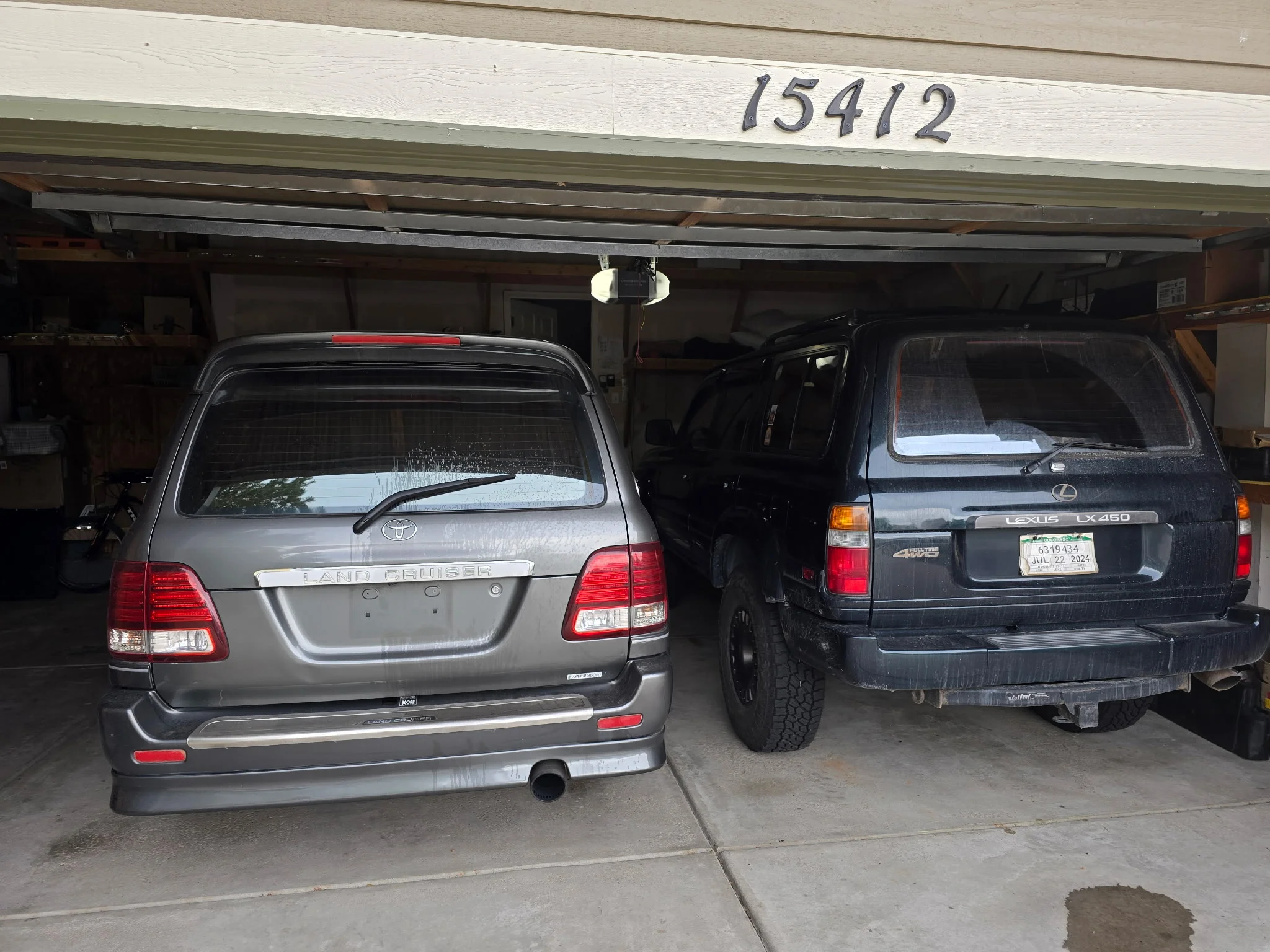

Speaking of the HDJ100. It landed in the port and was offloaded on the 21'st. @Riverrunner is trying his best to get a driver who can pick up on the specific pick up dates at the port. Which is proving to be a pain in the ass. Terminal is only open M,T,TH,F. Memorial day isn't helping either. Oh well. I'm thinking of offloading the Stock Land Cruiser wheels + 1 LX450 wheel. If anyone is in the Denver area and is interested let me know.
I replaced the outer door seals and that may have helped with the wind noise, but I also ordered the window surround film/seal. so hopefully that will quiet down the cab. the A/T's are also much more quiet on the road.

I went through this rabit hole just recently.
The 100 engine needs a few parts to work with your solid axle 80.
Youll need the oil pan/pickup tube and accessory drive of a 1HZ/1HD/1HDFT or even an FTE off an application with solid axle.
The FTE came with a different elbow for cooling return on the engine side. You’ll need one of a 1HDFT if you can find it. That coolant elbow has provisions for a turbo connection. On the 100 it’s long and won’t work with your factory radiator if you want the hoses and everything oem.
I just started mine after a few months of chasing engine accessory parts. No test drive yet but the engine sounds real good. I can’t wait to drive it

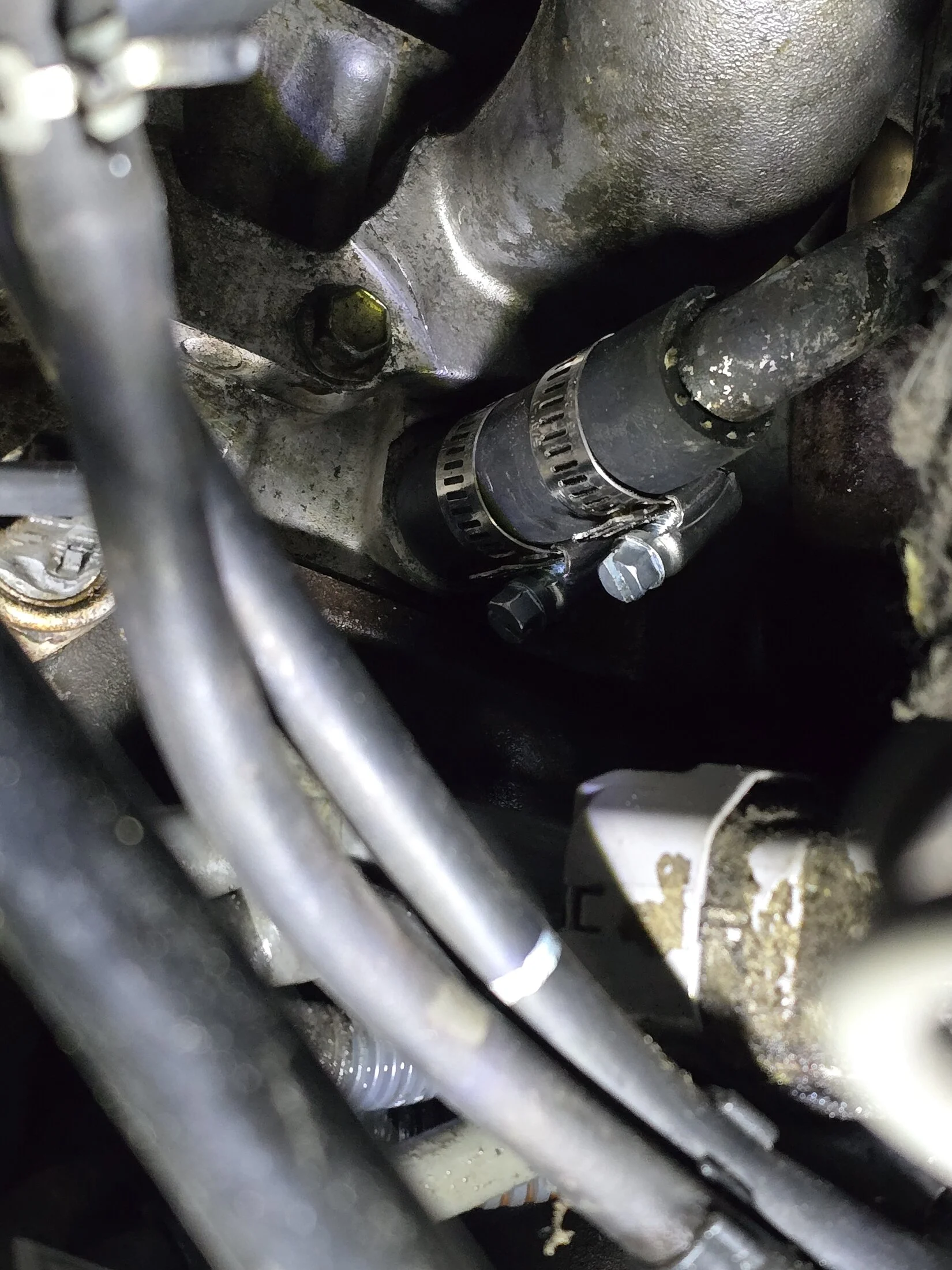

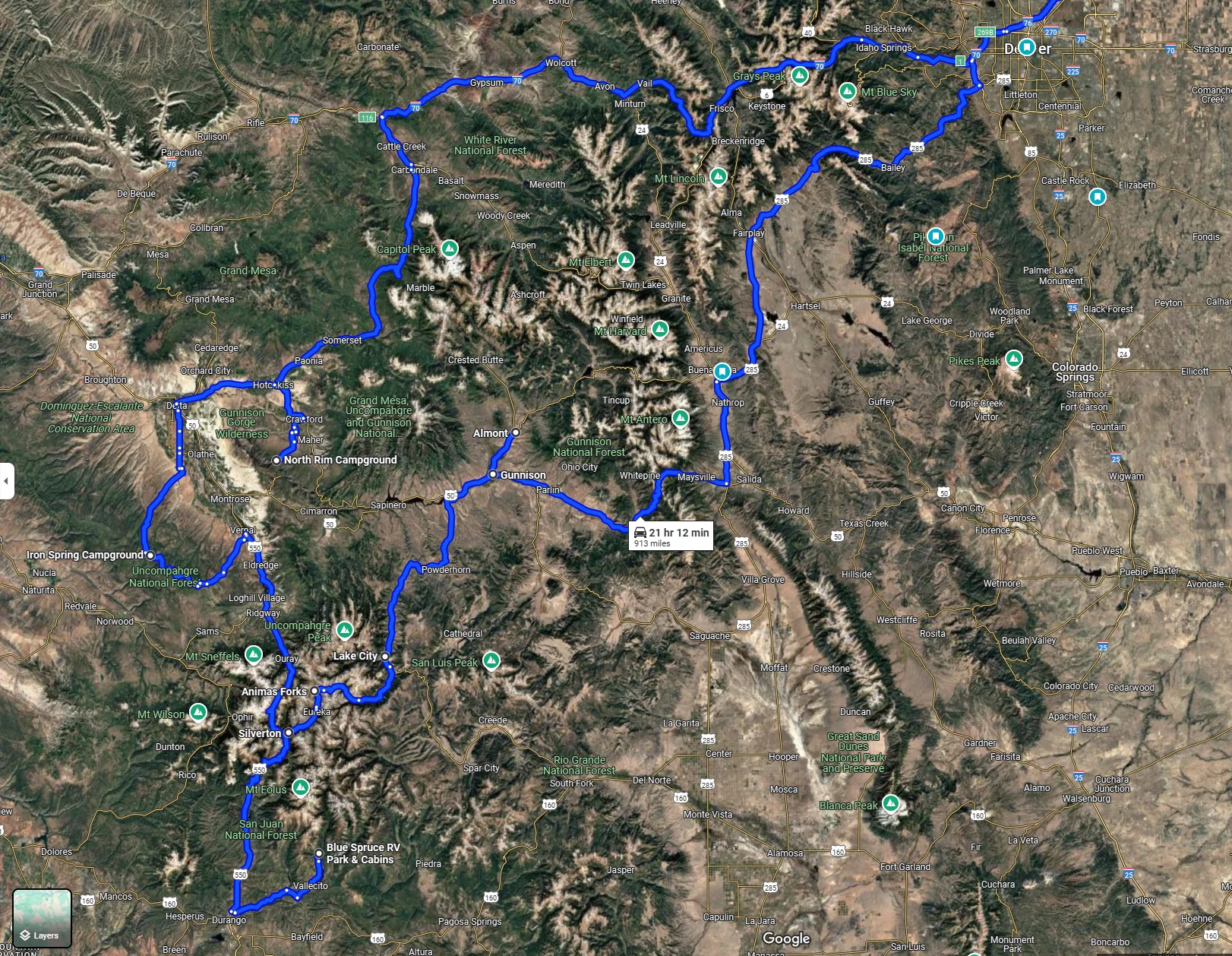

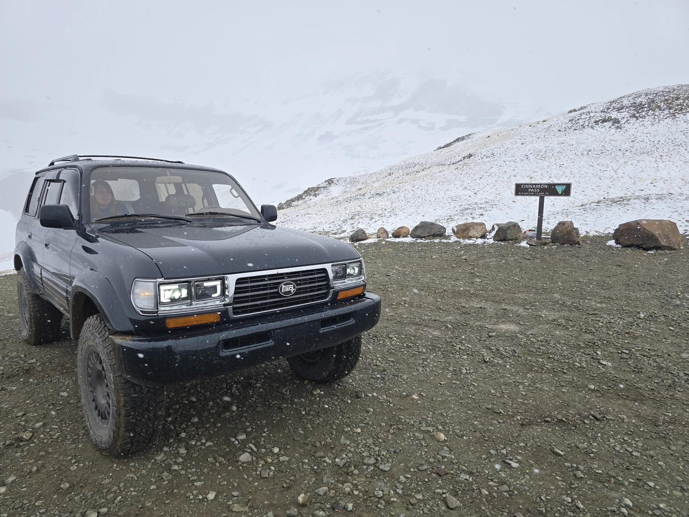

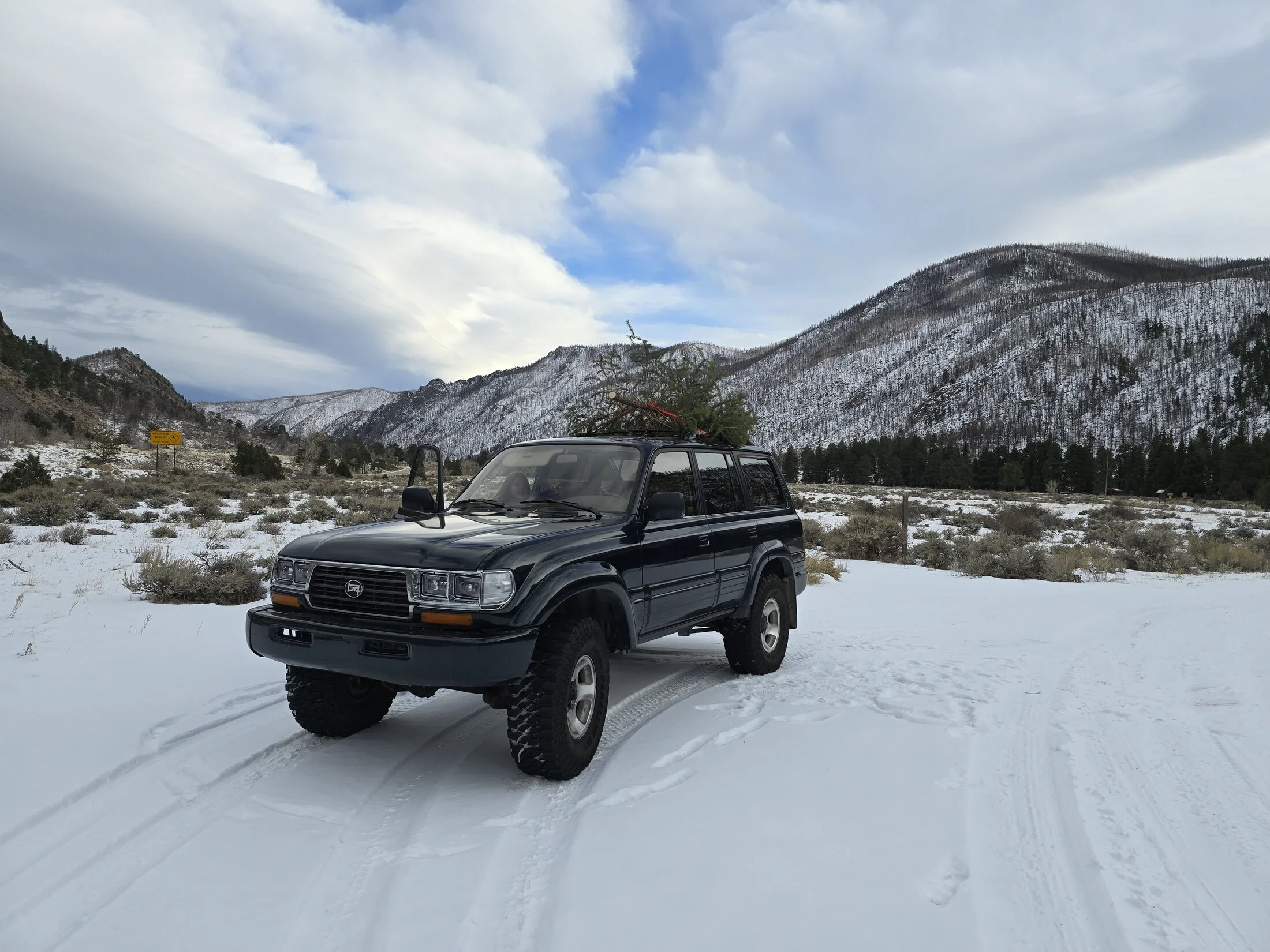

Well, just got back from my trip! Drove from Denver to the San Juans, had some awesome campsites, one was off of the Rimrocker trail in Montrose, another Off of Cinnamon Pass just outside of Lake City. Ended up driving around 900+ miles over four days. Took my wife to see a ton of waterfalls, and then we decided to check out Cinnamon. I've done the alpine loop but she hasn't so she was pretty psyched. On the way back I noticed the temp started getting a little high on my scanguage2, and it happened the Pesky Heater Hose. I just kept a watch on the temps and if it went past 205ish I'd stop and add about a gallon of coolant.
Here's pics of the trip!

Screw that thing. but it's done. Yes I used s*** hose clamps with my OEM Toyota part. I don't need it to last long, but it's holding pressure when the lexus is up to temp. I'll call it a win.

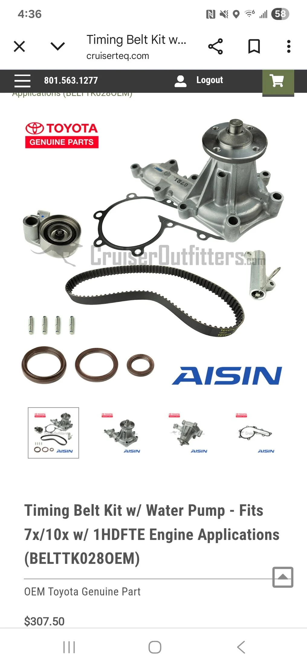

Haven't even made it home yet, already ordered a new timing belt kit.
Any other maintenance recommendations while replacing the timing belt/water pump components?
