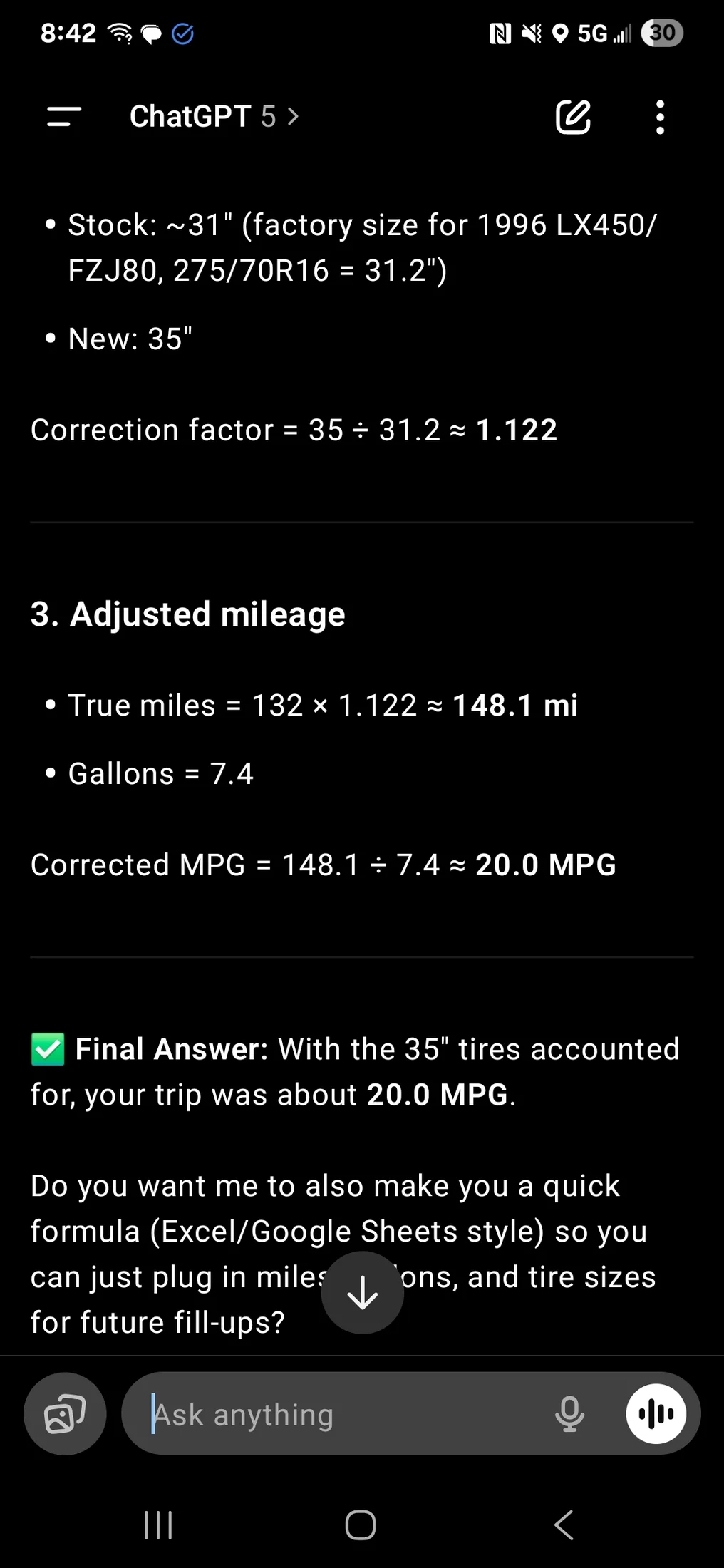

This easy to install and corrects your speedometer.

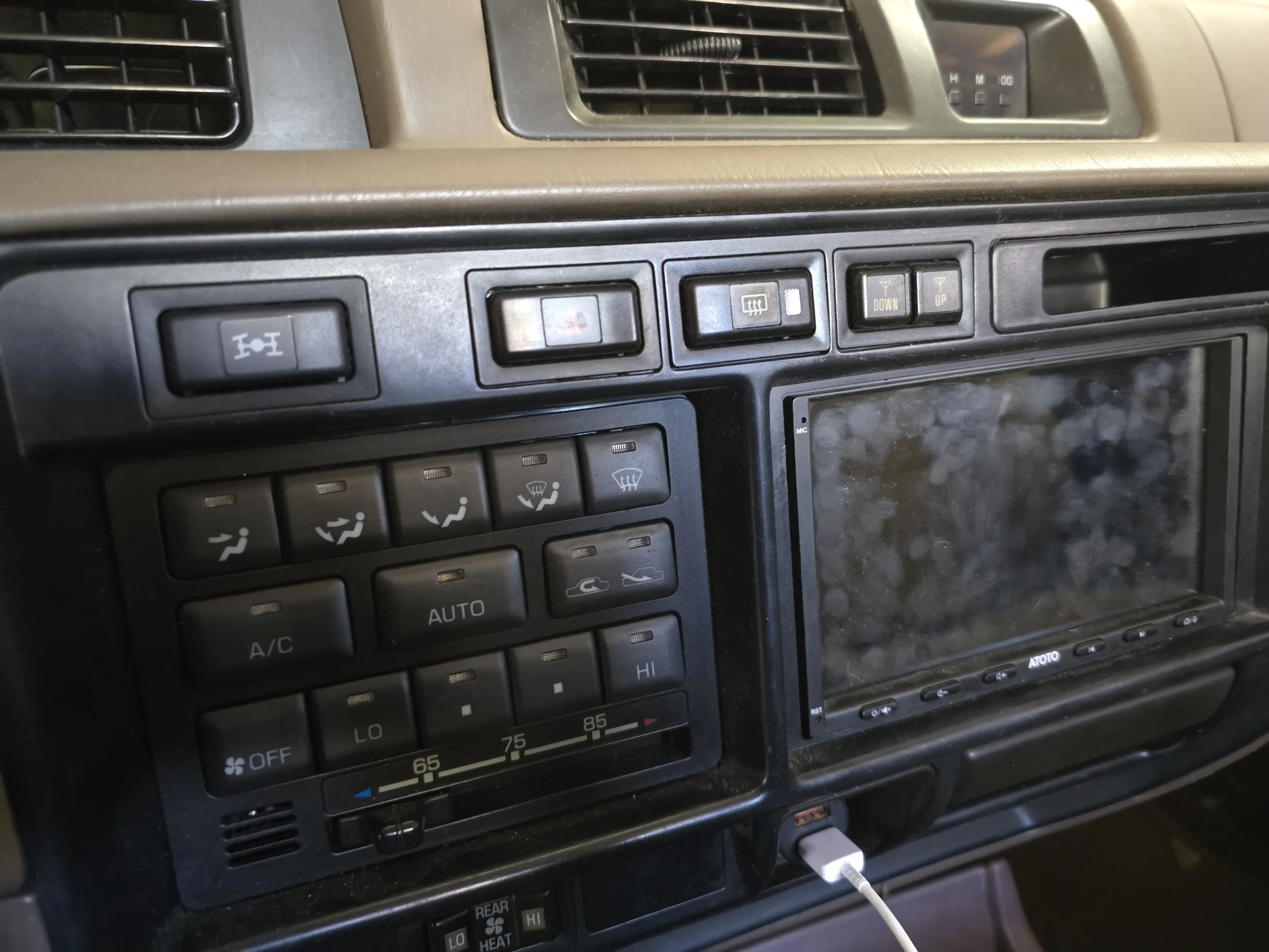

And a bonus pic of your rs3000 alarm indicator?
I'm working on replacing mine today. Just came in to look up a couple of the options because I'm trying to make it work as closely as I can to OEM, except better range. I don't really live somewhere that requires an alarm, but I love keyless entry and mine was becoming erratic.
