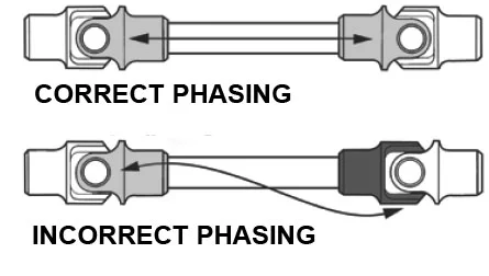

Too lazy to reread the thread ..... has anyone mentioned checking shaft to see if it is in phase?

No. What does that even mean?
It means when the two parts of the shaft were slid together it was done as shown below:
I've never had a 'cruiser that the PO phased the shafts correctly. I have had to remove and re-phase both shafts on every truck. To be honest, though, I haven't been able to tell much difference in noise or vibration. It can't hurt and I want things to be right. That's why I do it.
Doh!!! I forgot about that part. Add what I said and what Rice said and you have to two parts of Driveline Phasing
