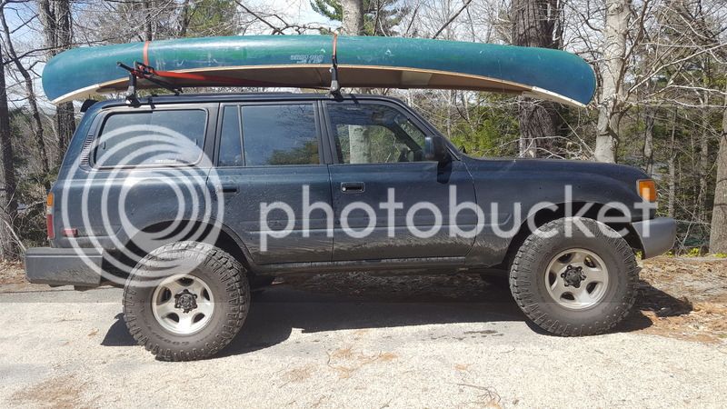

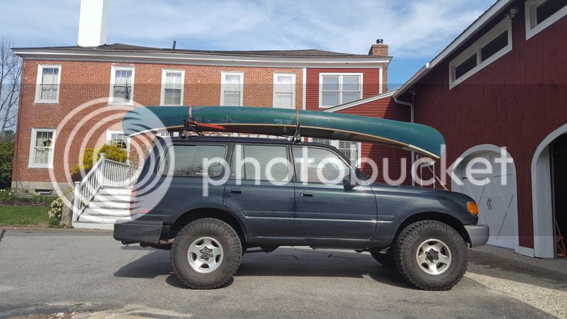

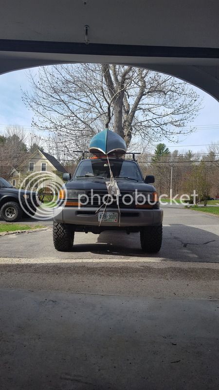

Bought a canoe a few weeks back and we finally decided to take it up to the cabin yesterday. It's a 1975 Old Town canoe... don't know the model. (I'm a canoe noob. So for tie down, I used a trucker's hitch in for the safety lines... then made another one with the extra length of line. I used ratchet straps for main tie downs)
Side view
As you can see, even with my zooming around corners, everything stayed in place perfectly. (that was a worry) The dirt roads up there were pretty wet, which made for a fun drive up.

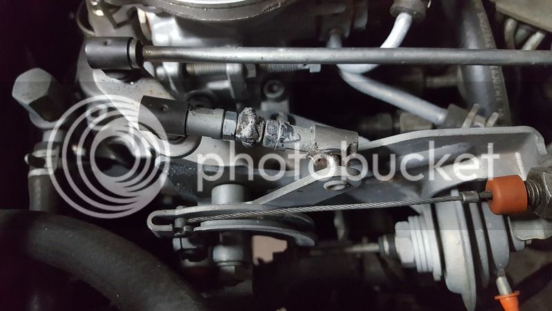

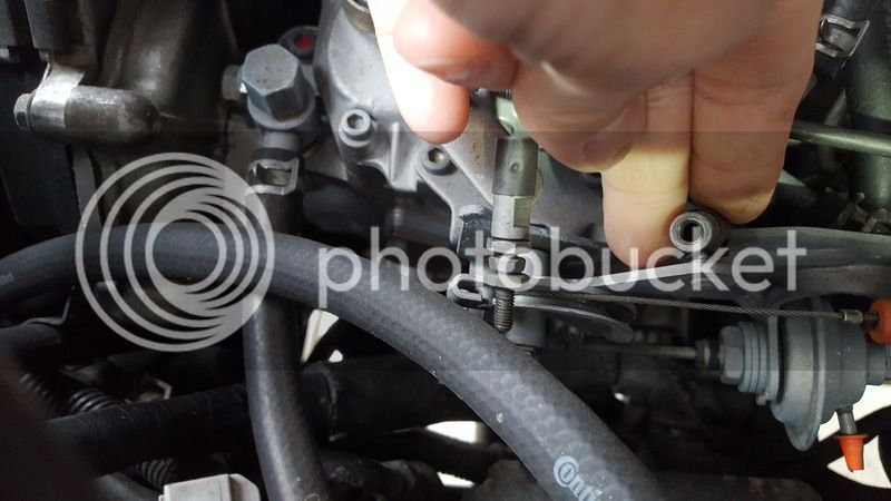

Also, after 5,000 miles of driving this rig, I had my first hiccup with it. I was driving to work and I noticed that the idle seemed higher than normal. I decided to get some fuel and check under the hood. I found this:
The adjustment linkage for the kickdown cable has come off one side. So, I reinstalled it and tightened by hand. The plan was to torque it down once I got to work. Well, after about 20 minutes of driving, I could tell that the 80 didn't want to downshift. After getting to work, I popped the hood and found the threaded rod for adjusting the linkage was totally missing. Bummer. So, as a stop gap, my buddy took me to the hardware store and I grabbed some threaded rod (left and and standard thread) along with some nuts. We cut the rod on the lathe:
Then, I had the machinist mig the two pitches of rod together in the middle using the nuts. I ended up with this: (It's not pretty, but it works for now.)
It drives fine for now. But, I'll probably make a prettier version later one, if I get some time. That's all for now!

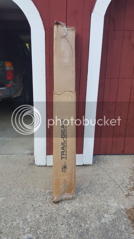

This coming weekend, I plan to start building sliders for my 80. The plan is to use 1.5" DOM rather than the standard 1.75" tube, for a lower profile appearance. Until then, I have no mods on my truck. But I did enjoy it last weekend.

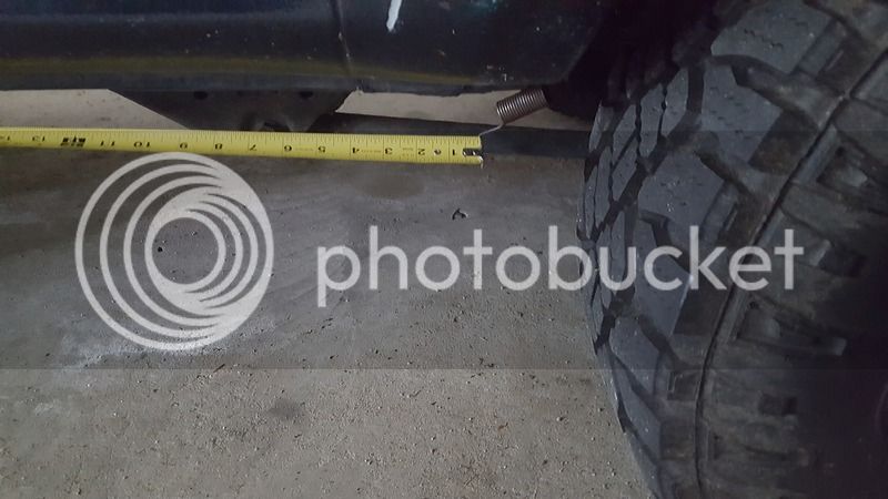

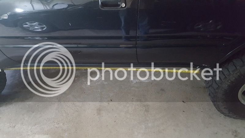

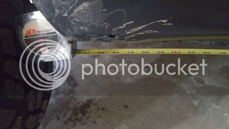

So, I'm finally getting ready to do some actual modding on the truck. Based on the advice of @Box Rocket and @Bama4door, I ordered up a set of 67" Trail Gear sliders (120002-1-KIT). Yesterday, I did some measuring and it looks like the sliders might be a tad short. Did either of you guys add some length to the sliders or do they seem to work fine at their current length? Did you bias them towards the front or rear at all? I was considering sleeving and extending the ends by a few inches...
Measurements:

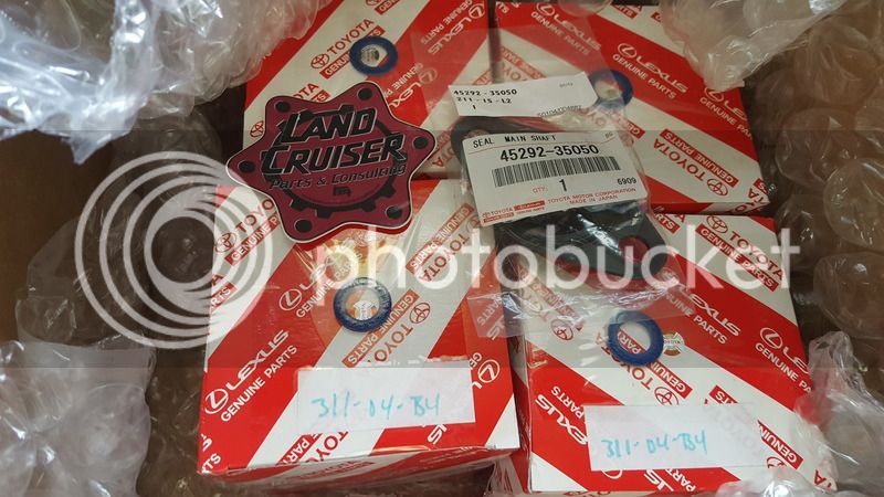

Also, this package arrived yesterday! ...but I was too tired to bother opening it. Man, I'm getting old!
