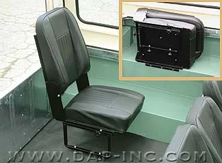

Jump seat option
This is an option I will be going with. It's a front facing jump seat for a Land Rover. Sells for $219.00 each and I think would fit in the OEM rollbar.
Google Image Result for http://www.dap-inc.com/acc/acc-img/int/LRA061-forward-jumpseat.jpg
I think you're right, rear bench is the safest. The horizontal seats, even with good seat belts, just don't support you in the direction of motion, which is inherently less/un safe.

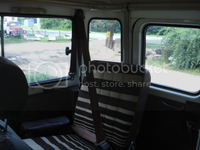

Here's a picture of mine. Turned out really nice and matches my stock front seats.
Also, these are infinitely safer than most other options, in my opinion.

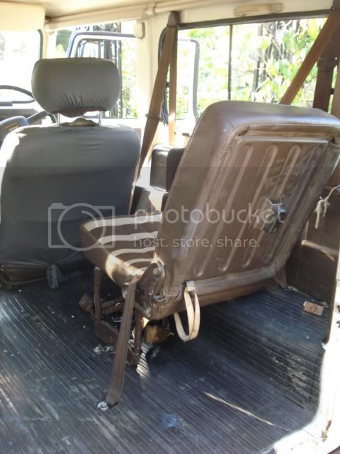

I have a forward facing jump seat on one side and cannot seem to to find a matching one anywhere.
Here are 2 pics.
With two of these, I should be able t sit two kids safely in the back.
Does anyone know where I might get the left side one? I have seem some that make up the rest of what my be a bench and if I had to get that one and modify it I would.
Also, how does someone go about picking up front seats? I would like to get some very comfortable seats that preferably sit on adjustment motors. and maybe even a heat option.
Any thoughts? I have seen the pics of someone doing 300ZX seats but I would like to find something I could see.
D. Ryan,
You have one-half of the special forward-facing rear seats on your LX version.
The missing piece is a longish bench on the other side.
It was fixed and only folded forward, not up and out of the way as the piece you currently have.
There was not a reversed setup for the LHD LX version--only the right side folded up.
The Land Rover aftermarket foldup seats come fold-up style for both sides (see an earlier post here) and when folded, allow full use of the entire floor area, unlike the LX arrangement. Some Land Rover Defender 110 owners switch to these forward facing seats, as the earliest models had inward facing benches, then later came with dual inward facing individual seats.
The Defender 90s had an available forward facing bench between the wheel wells.
