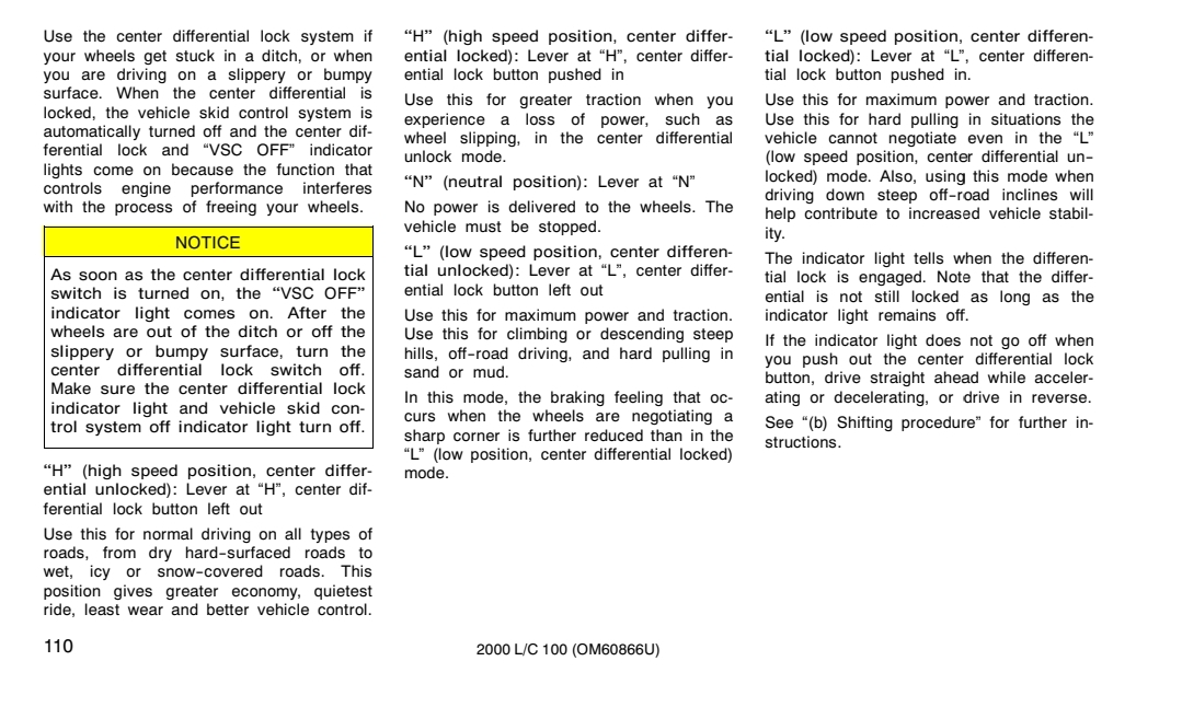

From the owners manual:
TL;DR: don't lock the CDL on hard surfaces.
From the FAQ section in the 80 series forum. All you need to know about diff lockers with pictures. Just insert "100 series" every time you see the words "80 series".
Spend some time reading your owner's manual. In short, you should only be using the differential locks, you don't specify center or rear or the year of your truck, in loose traction situations. Definitely not a parking lot and def. not just to press buttons. Granted, the owner's manual doesn't say when NOT to use the locker, think they're assuming you'll understand this is the recommended situation when TO use it and not otherwise.
Using it like you did on a high traction surface causes a lot of binding in the driveline. Can't think of anyone breaking anything do it, the tires would mostly likely chirp/skid before an axle broke, but still, it's unnecessary stress on the system.
