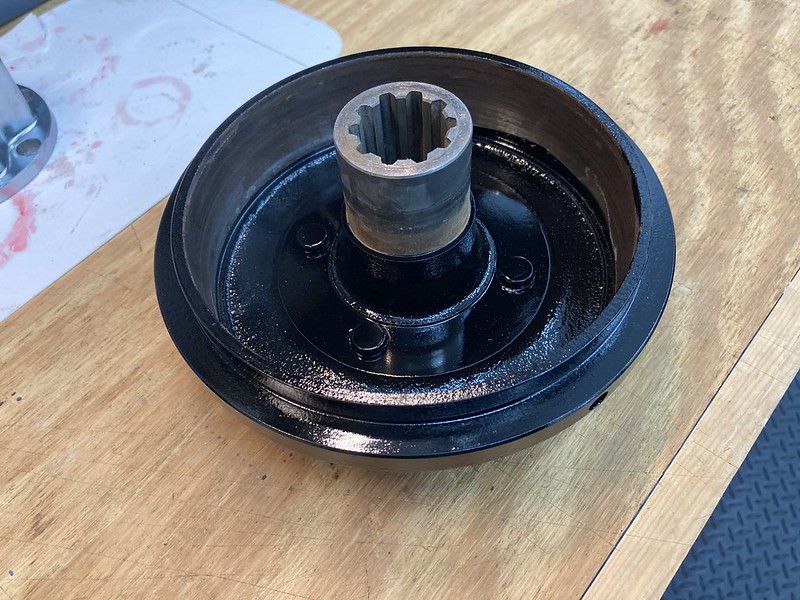

Also got an oem license plate mount blasted which I’ll paint tomorrow. On deck for blasting tomorrow is a replacement parking brake drum I found in my parts stash that fits the driveshafts I plan to use.
Painted the parking brake drum I found as well as license plate mount. Backing plate and guts ready to be mounted.

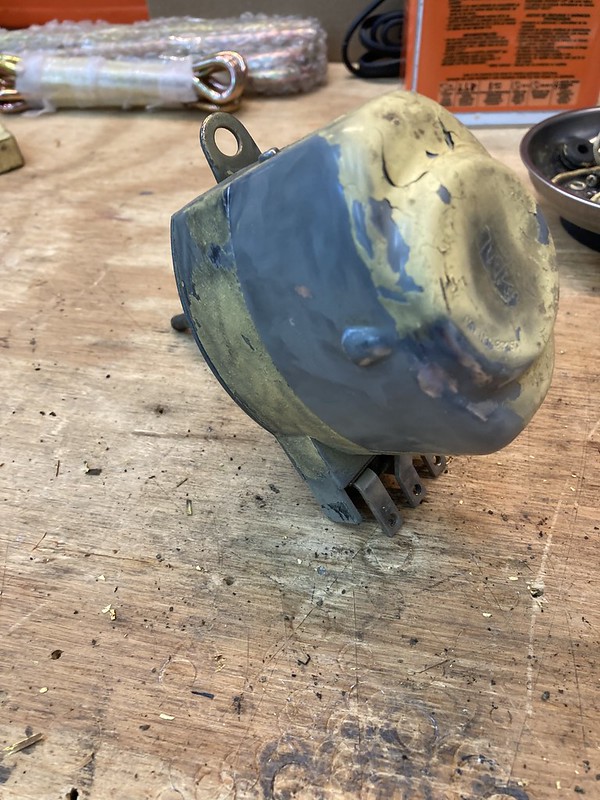

Started working on wiper motors….these things are nasty on the outside but the guts looked great. It will take me a while using a dremel wire wheel to strip off the yellow paint and dried grease before repainting a grey color.

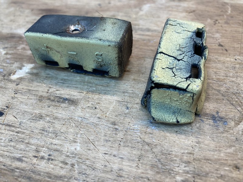

What are folks using to replace the electrical connection rubber covers? One of mine is serviceable after media blasting but the other one is pretty much garbage. @pardion ?
I have some reproduced that might be avalliable. Can’t get to them for another week. We are evacuated from our home due to a forest fire.’
just hoping the house is still there, let alone 3 Land Cruisers, and a s*** load of parts. Please check back in about a week. John
Thanks for the reply John. Praying you guys make out ok! Be safe.
