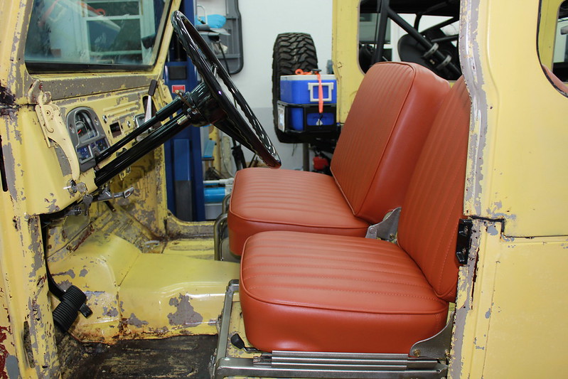

Drivers side down, passenger to go. So far these haven’t been that bad to fit aside from me installing the back cushion onto the base seat.
Most challenging part is fishing the ‘string through the base cover...was an exercise in luck.

Seats mounted! Also got the refreshed fuel tank installed with new hose and felts.
