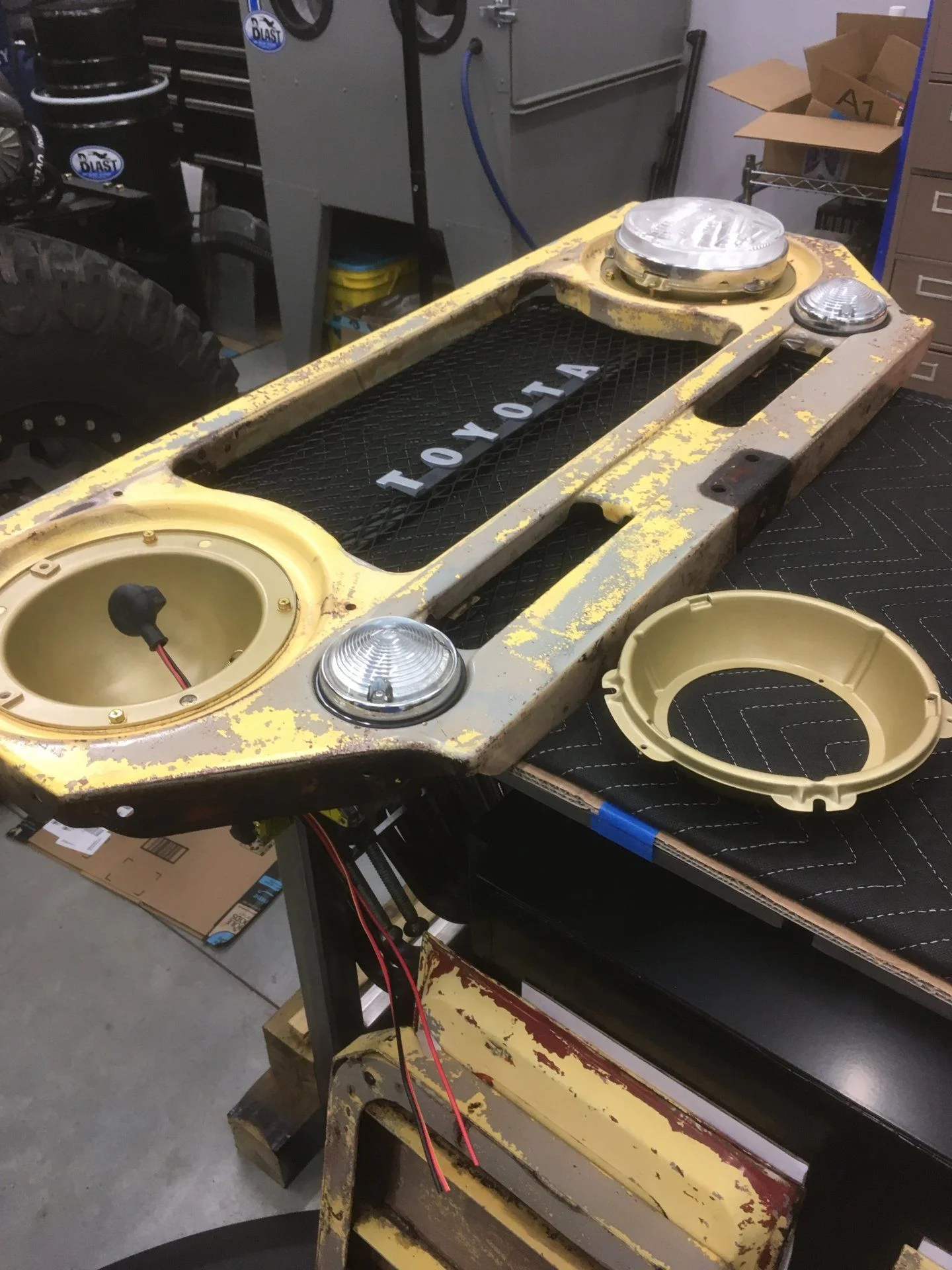

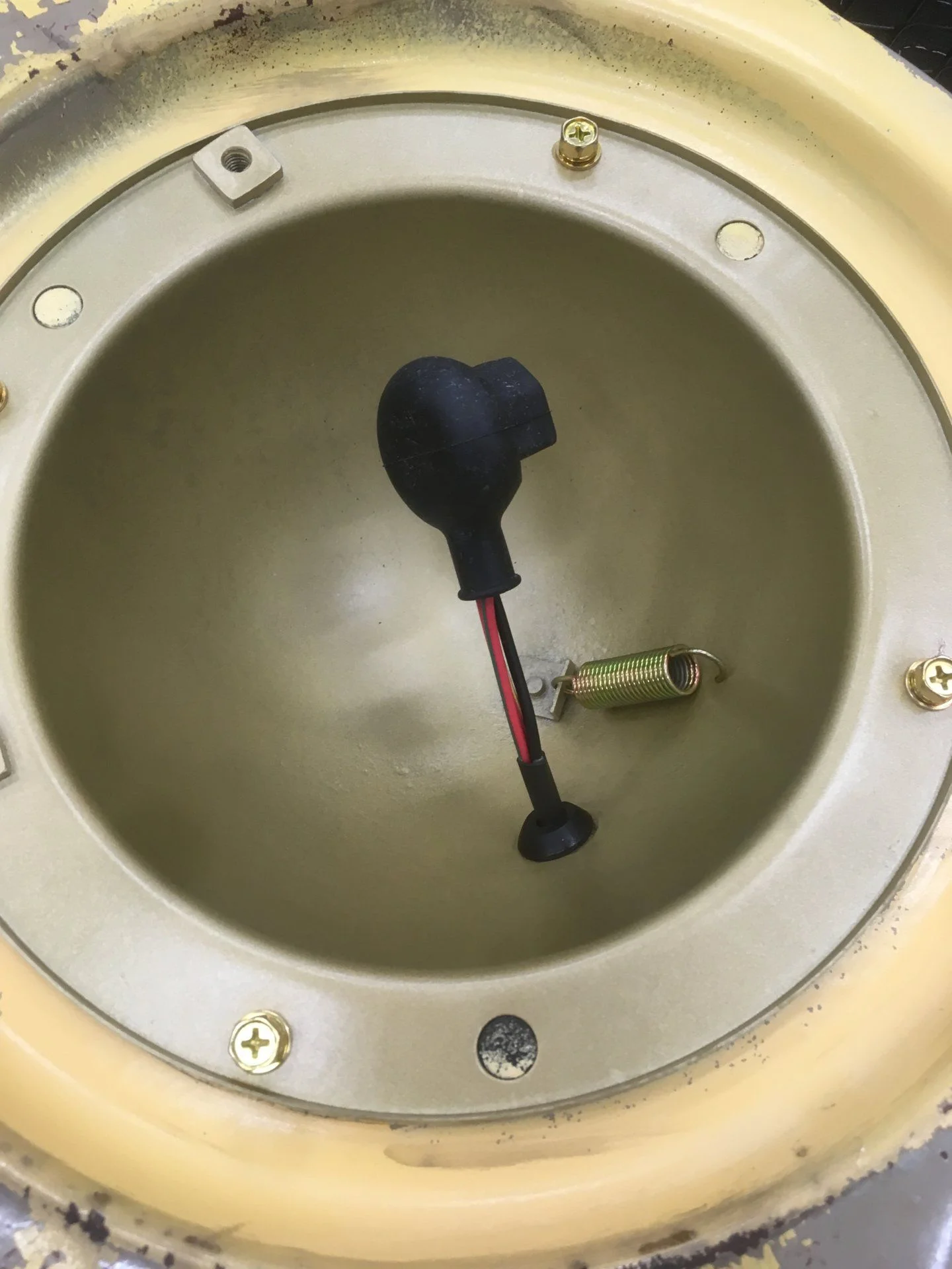

I know this is a few years old but do you have any photos of the wirng for this and how you integrated it to the older wiring harness? I am about to do this same thing to my 1964 FJ40.
Thanks
It has been a while but as I recall, i ended up remaking the front bib harness when installing these lights. It far easier and looks factory now that it is all wrapped.
I used the wiring instructions in the box with those lights and it was straightforward aside from cutting out a lot of the harness length that comes with them. I mounted the relays on the middle front portion on the passenger fender in the engine compartment and the inline fuses toward the middle rear of the same passenger fender. I can get pics of that if you would like.
Ok that sounds like what I was thinking but If you can get pictures that would be great. I am for sure a visual person with that sort of thing. Also Durham! Not too far!
Thanks a bunch!
That is what I did. I just snipped the excess off and wired it into the fender junction block like the OG lights were. Works perfect.
So really just the bulb connectors were used in the supplied wiring loom and thats it? just making sure before I start cutting and splicing haha. I am going to try and tackle this today or tomorrow. My seat upholstery is taking a pause because I had to buy more batting online.

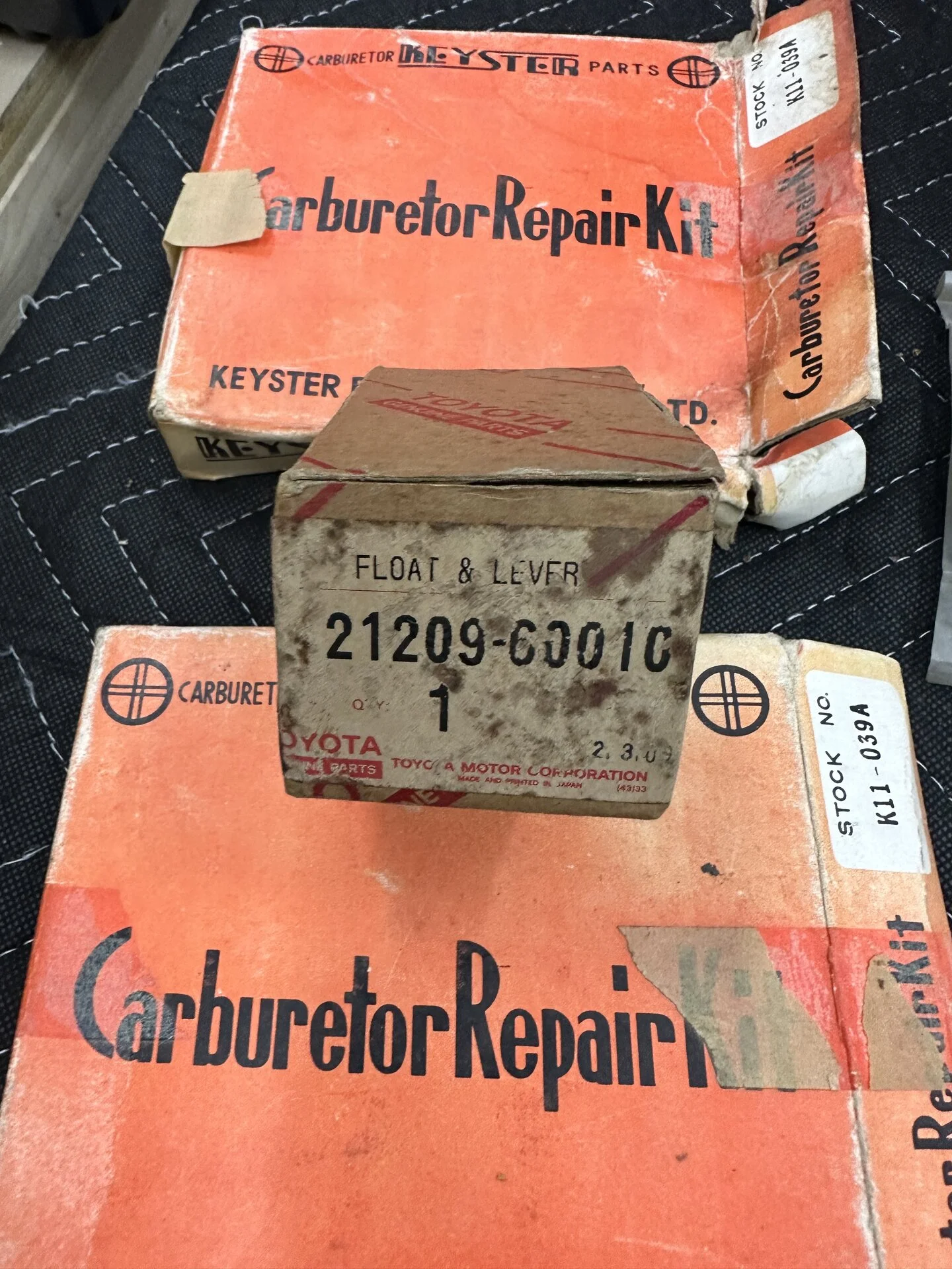

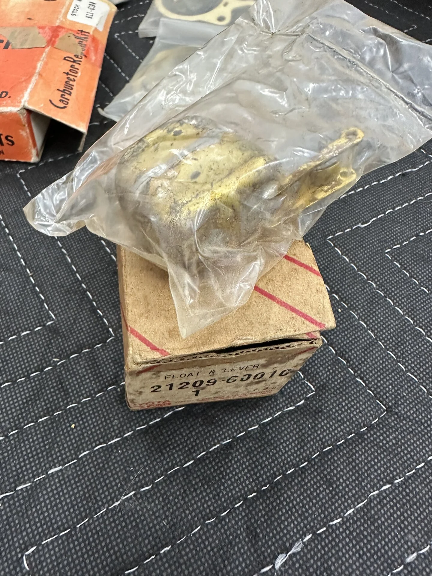

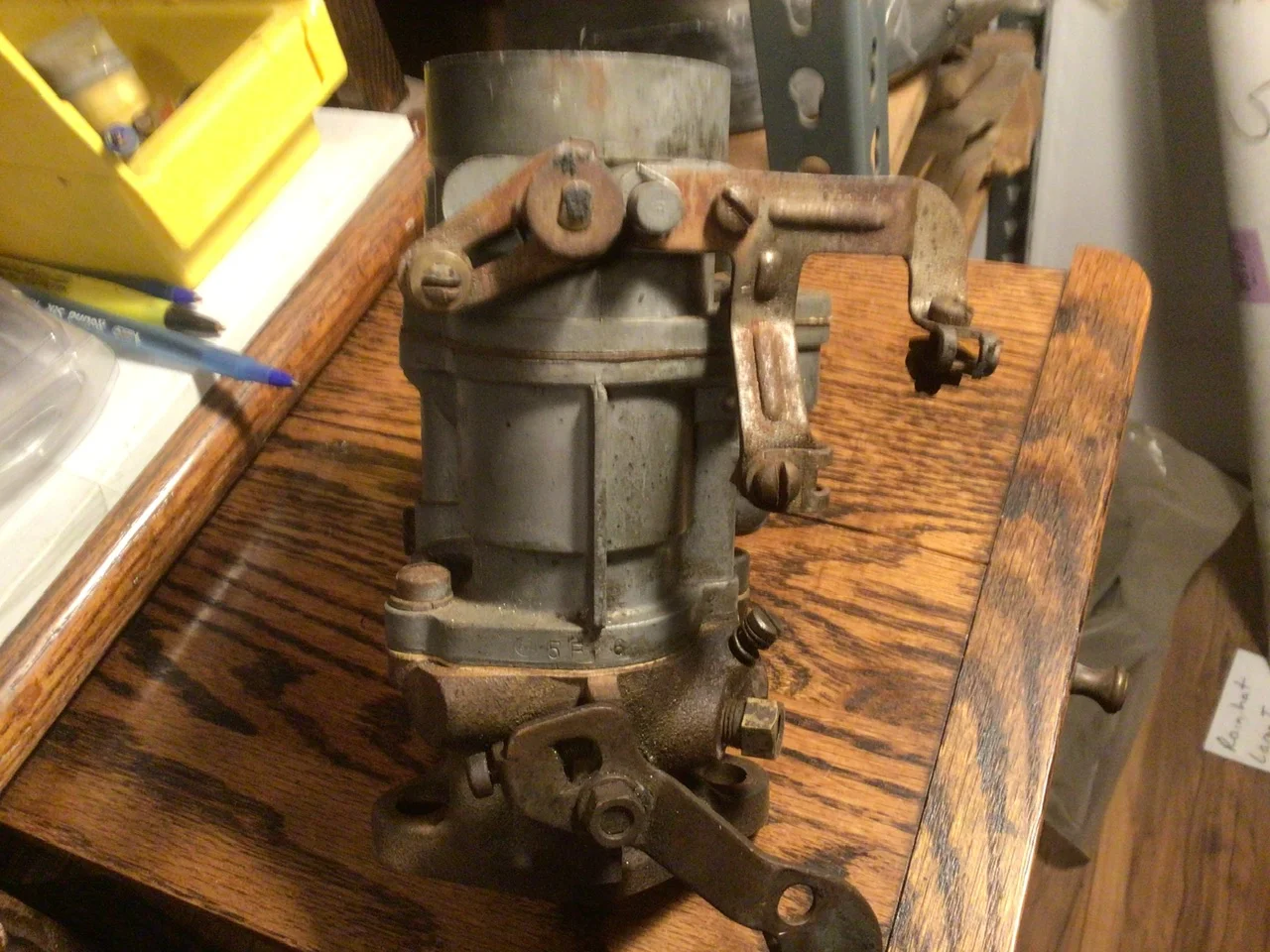

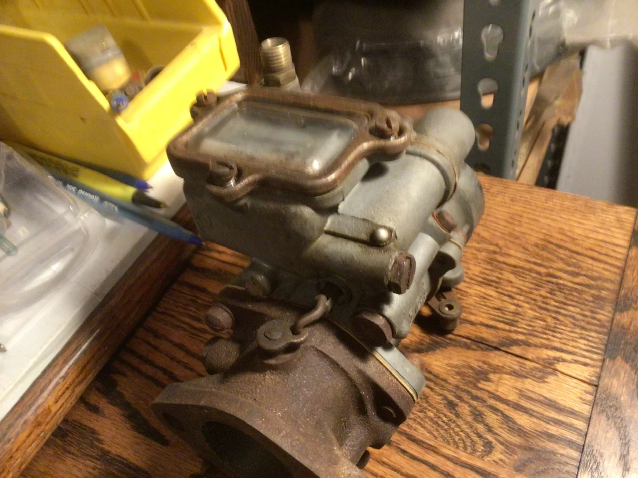

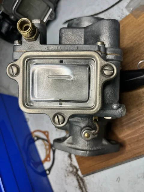

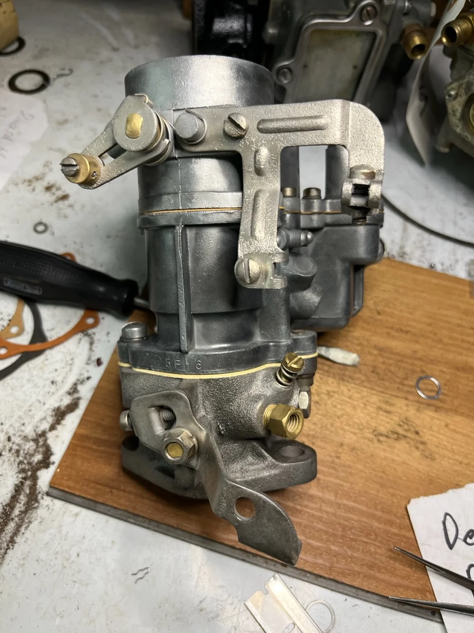

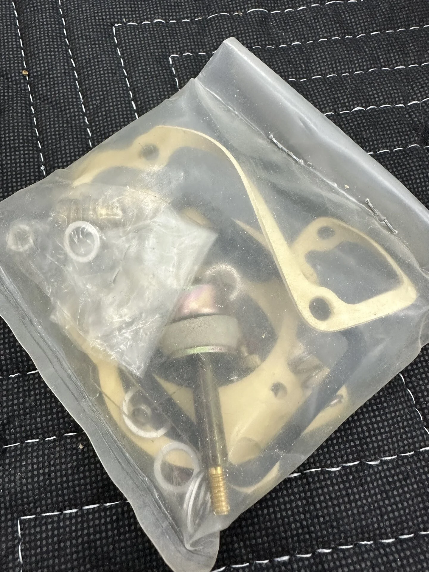

On an unrelated note, a couple years ago I happened upon a SD40 carb, couple of NOS keyster rebuild kits and a NOS Toyota float. Only bummer is no Aisin engraved plate but the glass looks to be in decent shape. Finally got around to calling Mark to have it rebuilt. Just shipped it off today for him to rebuild.
edit…I am pretty sure these kits came from Pakistan. Be aware that one kit was for a d40 and the other for a sd40 even both have the same part numbers. So don’t use this keyster part # and assume it will be for a sd40, have the seller verify it includes the large black rectangle gasket vs the smaller round one.
View attachment 3310715View attachment 3310716View attachment 3310717
…and if the bowl gasket is folded over like that, it’s probably not going to be usable.

Before
After

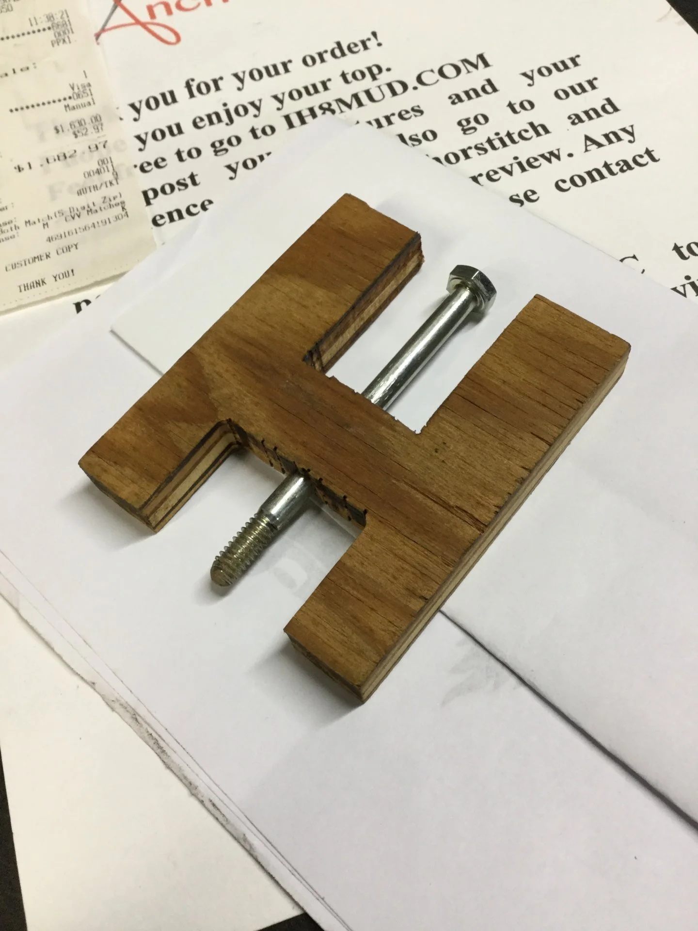

If you don’t have the SST for the booster, here’s a pic of an easy diy one I lifted from the forum about ten years ago.
