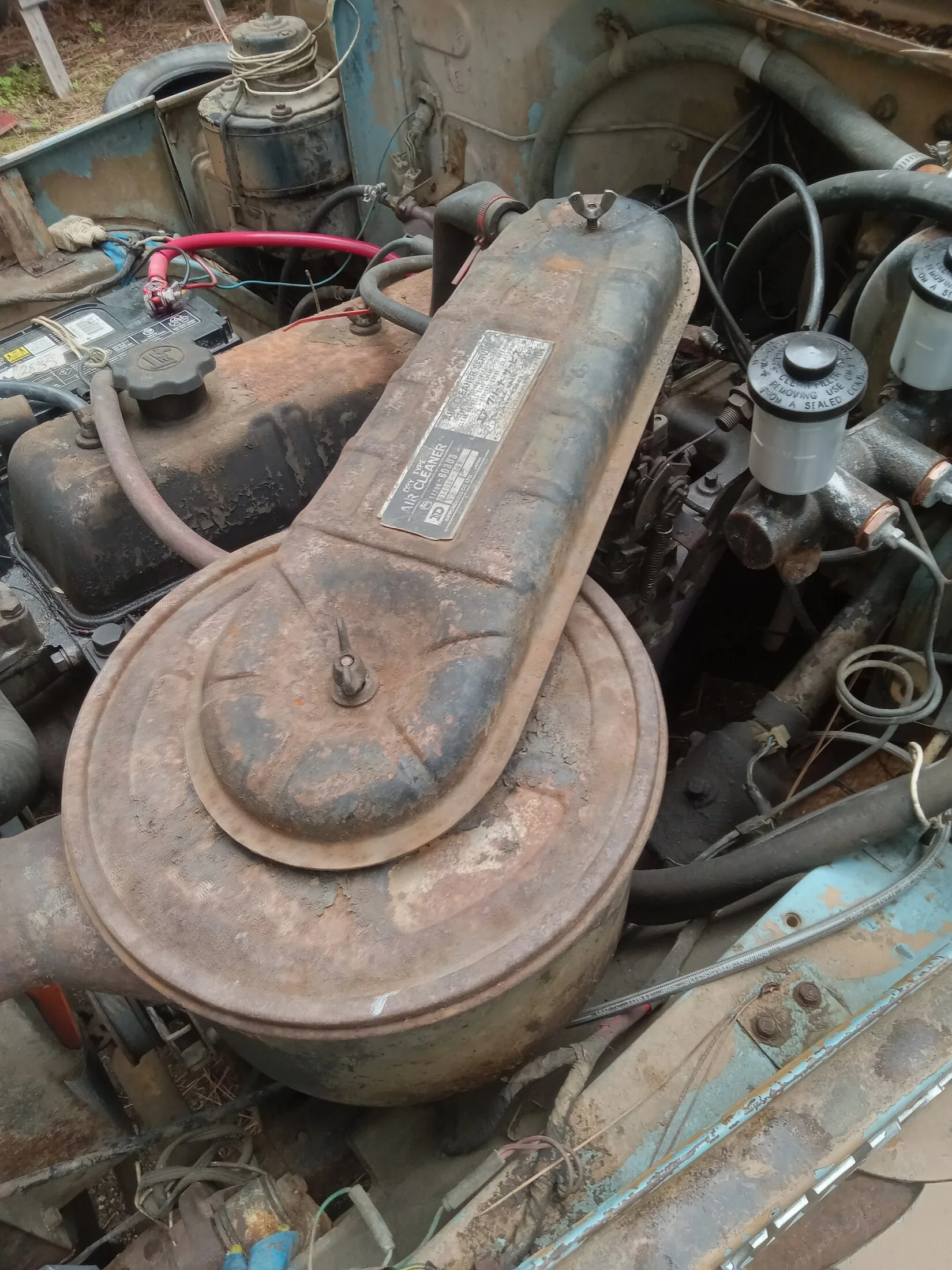

I have this 1967 FJ40.
Super original. I have the airbox but it’s missing the wire mesh on the inside. Where could I source some new mesh or what is another solution maybe for a paper filter. I just spent an hour at AutoZone and O’Reillys playing with air filters but nothing seems to really fit.

View attachment 3898756I have this 1967 FJ40.
Not sure of a source for the original mesh in the oil bath filter. But would take a trip to the local tractor dealer parts counter. Many old tractors had oil bath filters and are still supported with parts. (Dad sold tractor parts for years). My first FJ40 had a number of ford tractor parts in it when I finally sold it.
