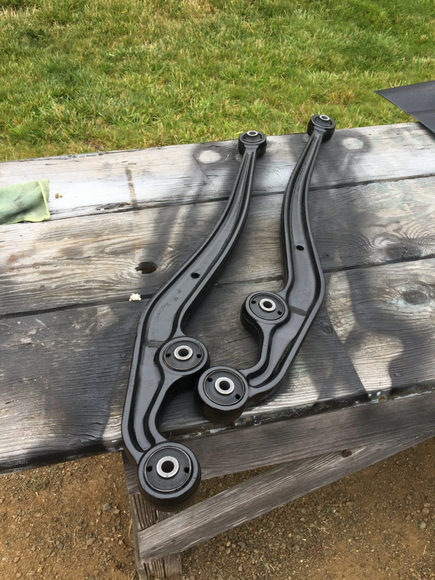

Got the Landtank Caster plates installed and panted up yesterday.
All so got all new OEM bushing pressed in the control arms & painted them as will.

Yep I tend to get a bet over board with paint can. I don't like the scratches the dam parking lot leaves

all the small holes in the rubber should be in a straight line between the two bushings.
How big of a deal is it I think that I read on here that some years were one way some the other.The Mechanic that installed them said he matched the replacement arm that had OEM bushing in it. The rear one match my bent arm but has Slee's inthe front. The Guy is A trusted Mechanic has two 80 DD one of them it was at the shop,when we look at it the bushing they were in a straight line like you say, We look at another Customer 80 that was in the shop and could not find any holes. They look to be OEM with no off set.

those bushings are 90* out of alignment.[/QUOTE]
IIRC, At some point after our trucks were built, Toyota updated the recommended bushing orientation. So Toyota did it both ways. My guess is it probably doesn't matter :o
Front lower control Arm Frame Bushing # 48061-60010
Front lower Control Arm Axle Bushing #48702-60050
