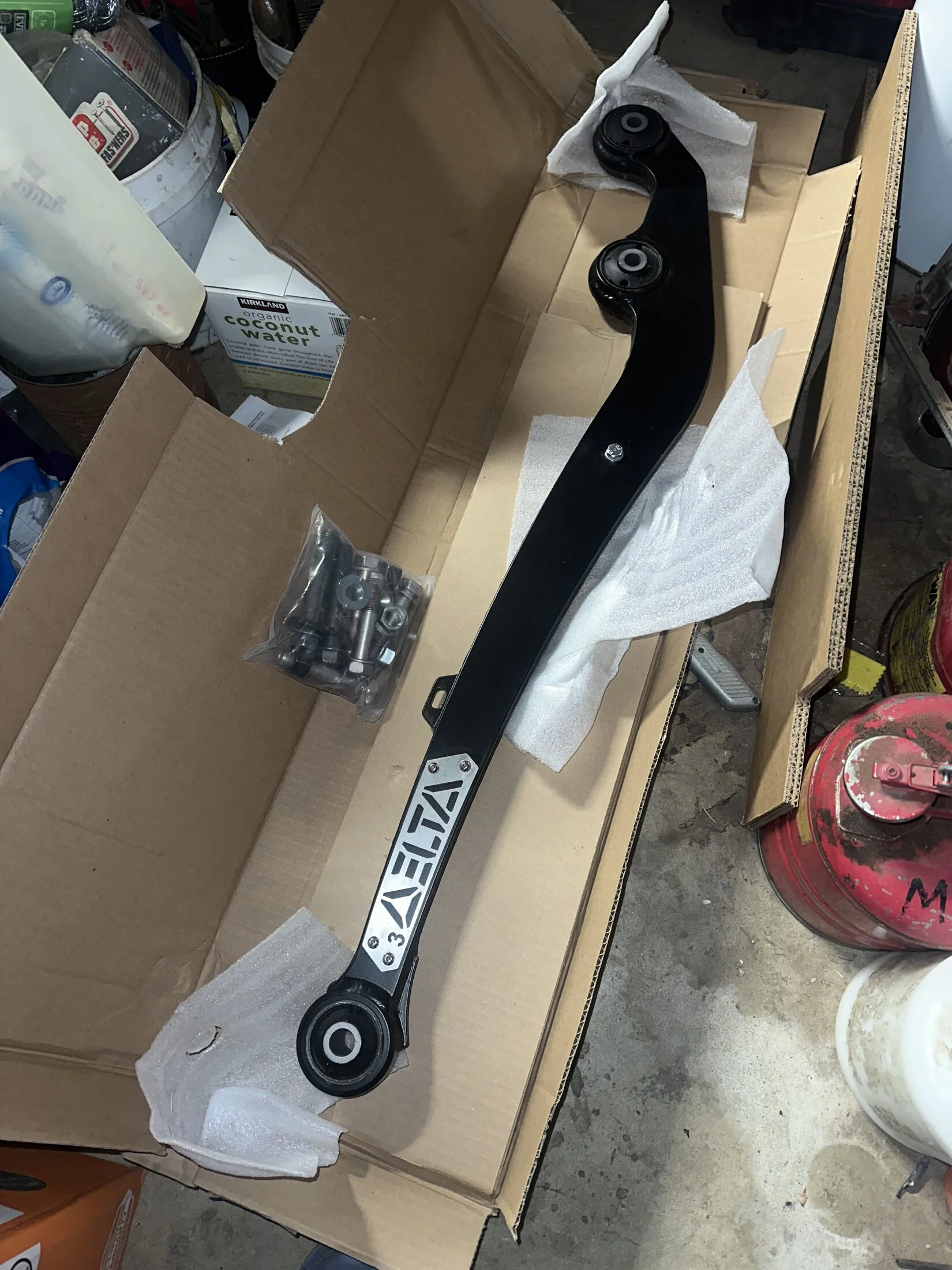

I appreciate all of your guys help and input! Thank you. I decided to pull the trigger on them. Deal was to good to pass up, Brand new and even came with new bushings and hardware. Just finished installing a set of OEM locking axles and these will be a good addition.
